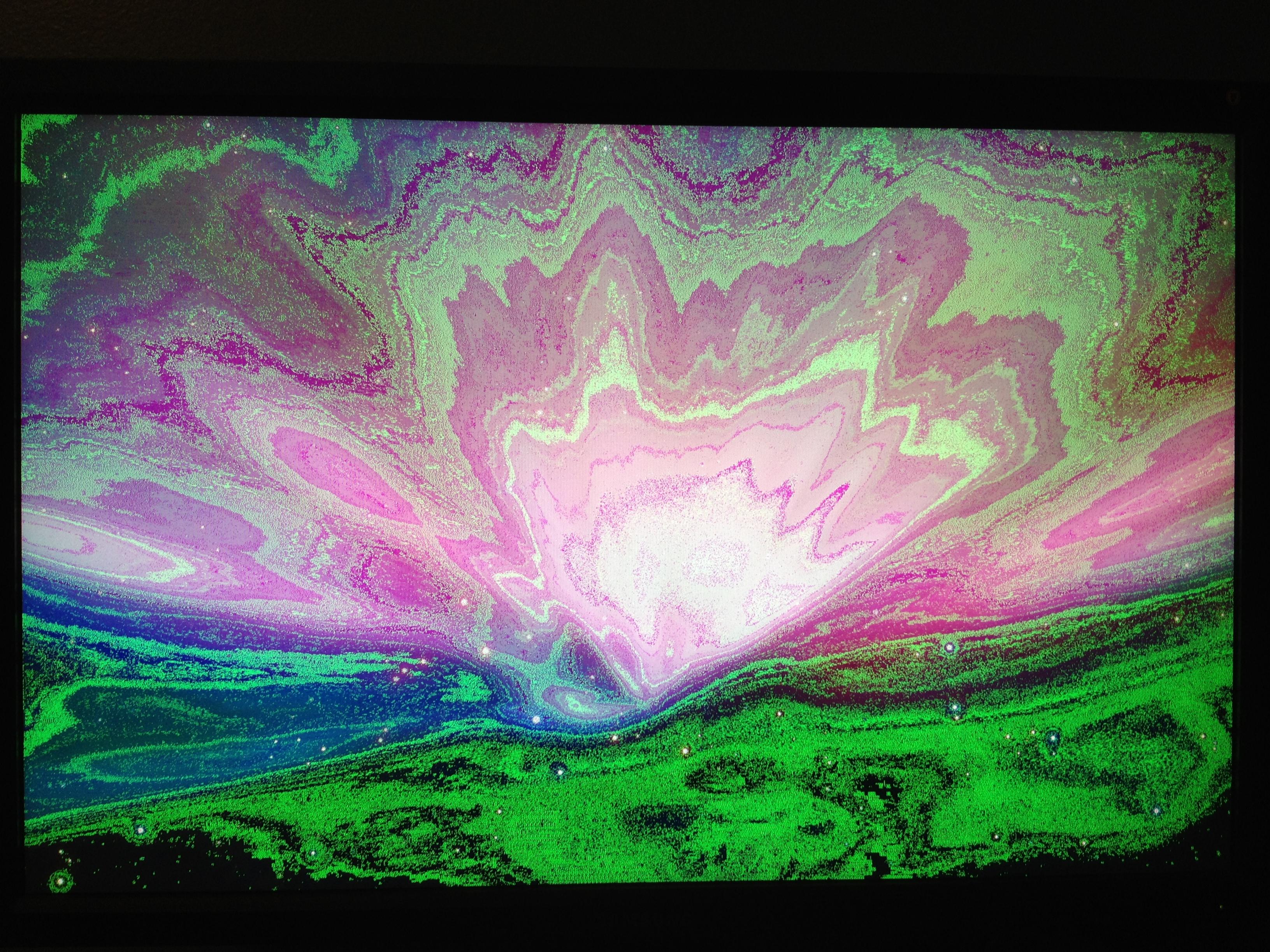

It detects that there is a screen and everything but the colours are all funky and glitchy.

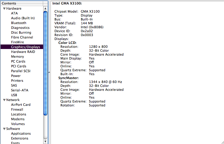

I've attached my graphics card info as well as a picture taken of my external monitor with the issue I'm having. (the image is supposed to be the standard Mac wallpaper of the purple star universe thing)

First thing I would do is get in touch with Monoprice and get a replacement to see if its a defective unit. They are really good about that. I can't see how a resolution problem has anything to do with colors showing up strange like that .
I don't think that the switcher is defective because it allows my PS3 to pass through it on both ports. It just seems to be the Macbook... I'm wondering if there are issues with a Macbook converting to HDMI or something.
From my Macbook there's a DVI-HDMI cable. Like I said, all the cables and adapters seem to be working fine (because I tried them on other things).
I'd think it would be possible because it IS working, the colours are just messed up and it's glitchy. I've read some other things where people have had problems and it will say no signal or something.

Ok so I tried the same things over and over and decided to go down the list of resolution sizes... and it worked 😕
I originally had the monitor at 1344 x 840, but the monitor works now through the HDMI switcher at 1360 x 768. It's SLIGHTLY different and I may have to just get used to it.
Anyone know why this could have happened?
(it also works at a couple of other resolutions but the one I said is closest to my original resolution)
