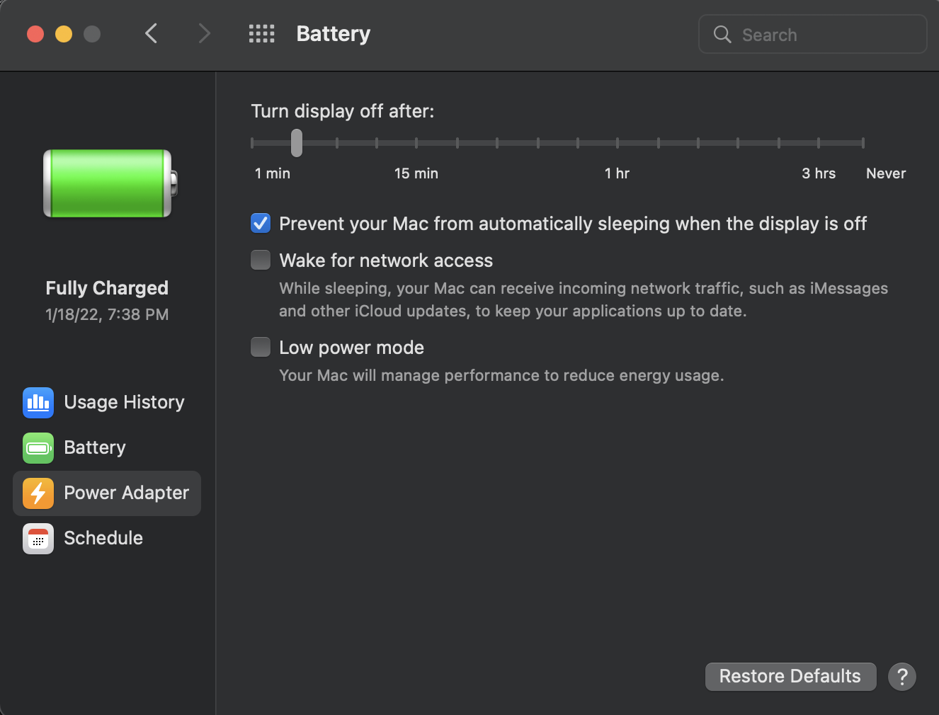

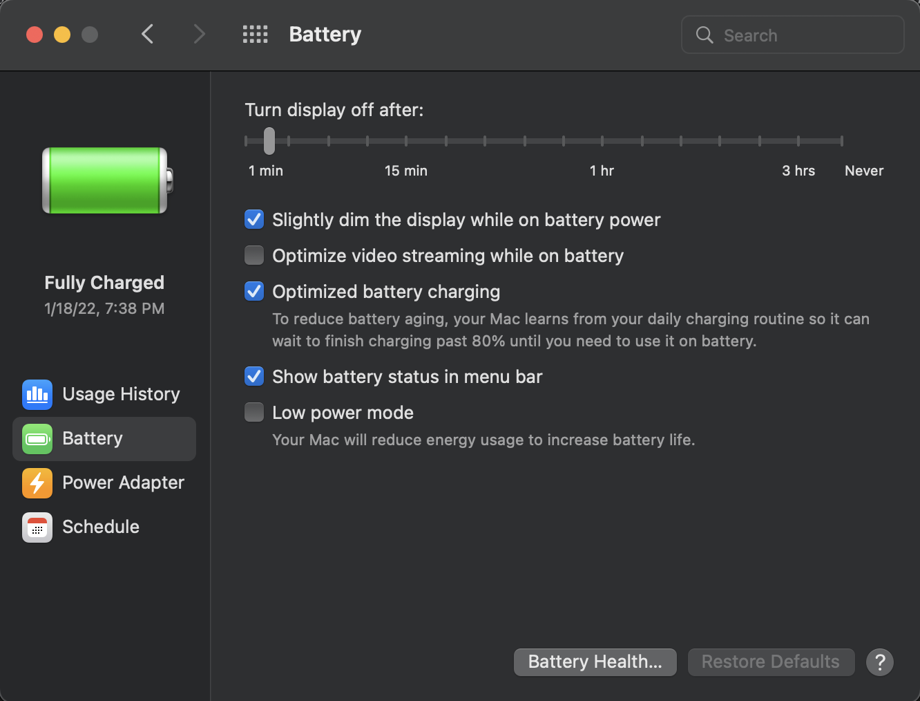

Here are my settings. I have an M1 and intel MacBook and this problem is the same for both of the computers. I use them as clamshell mode.

Aah! excellent, so ticking the option to prevent mac to go to automatically sleep when the display is off worked for me! I just have to wait till the display goes off as you mentioned last. This though is just a workaround I guess, but I don't really care as far as it's working for me. lol! Many thanks, again. 😀
