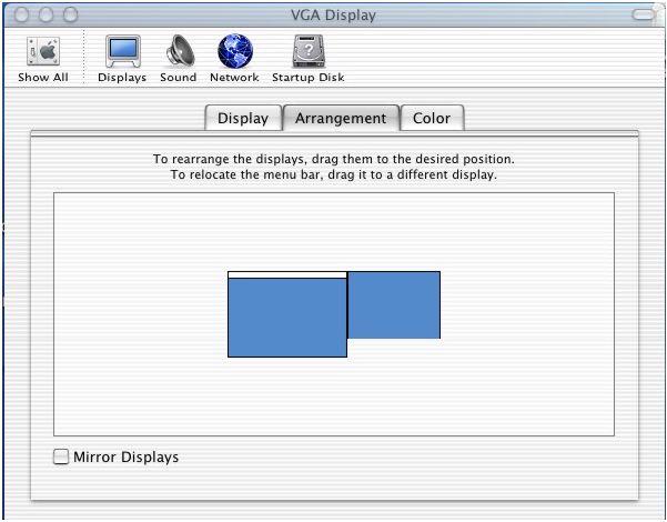

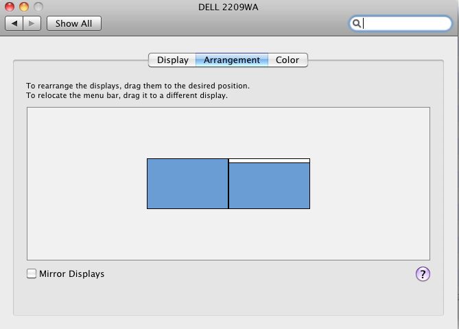

When not in Mirror Mode, you have extended your display, so you can drag windows to the other monitor/display.
depending on your arrangement, you can extend to your left, right, bottom and even top. The white bar resembles the Menu Bar.
right
left
bottom
You can also drag the Menu Bar to the external monitor.
