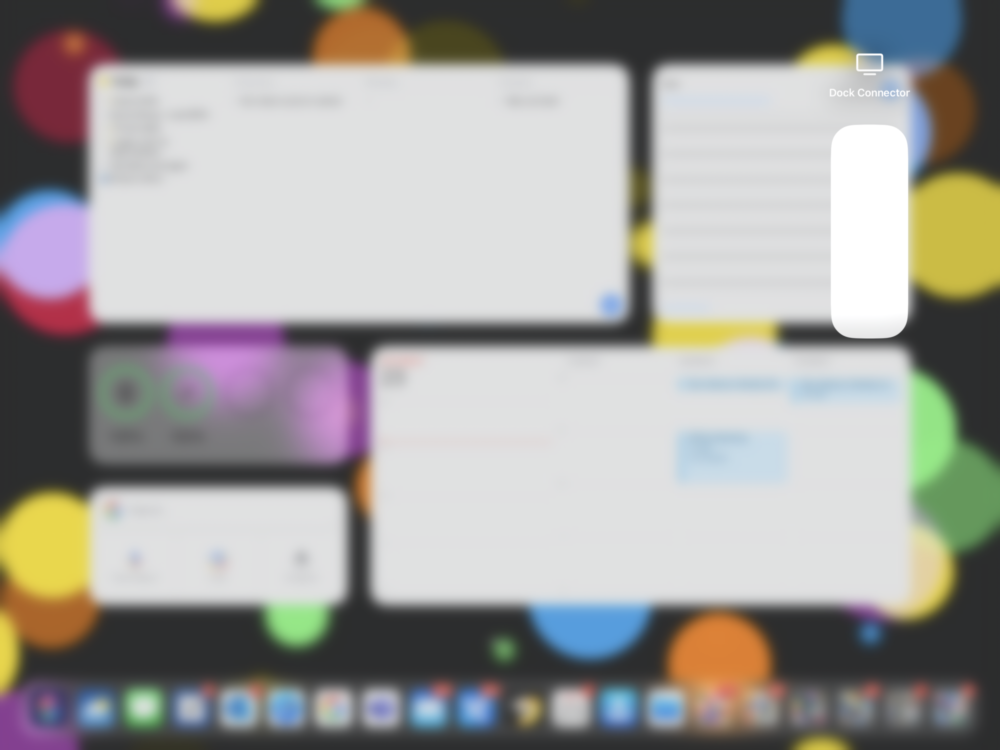

As @sparksd mentioned… did you connect a keyboard and mouse to that same hub? A keyboard AND mouse is required to use Stage Manager. And what iPad are you using?
I had it connected to the MK, its the M1 12.9 IPP 2TB. The multi tasking option was showing up on the IPAD it was just the external display doing nothing.

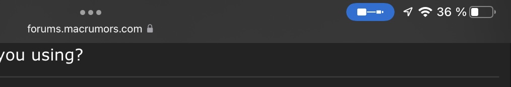

if you connect the hub to your iPad is it recognized, do you get a status icon?

The iPad needs to be connected to a mouse and keyboard for Stage Manager external display to work
The obvious first (sorry for that): Restart the iPad while the hub without any other peripherals is connected. Check/visually inspect the connector on the iPad and the cable. If the cable between iPad and hub can be detached, try another, shorter one (like the included cable from a Samsung or Sandisk SSD). If the hub provides power thru, connect it to power and then to the iPad. Last: check without the MK.
I tried and no dice. Same problem, hub provides pass through power, but still doesn't show is docked in the upper right.
