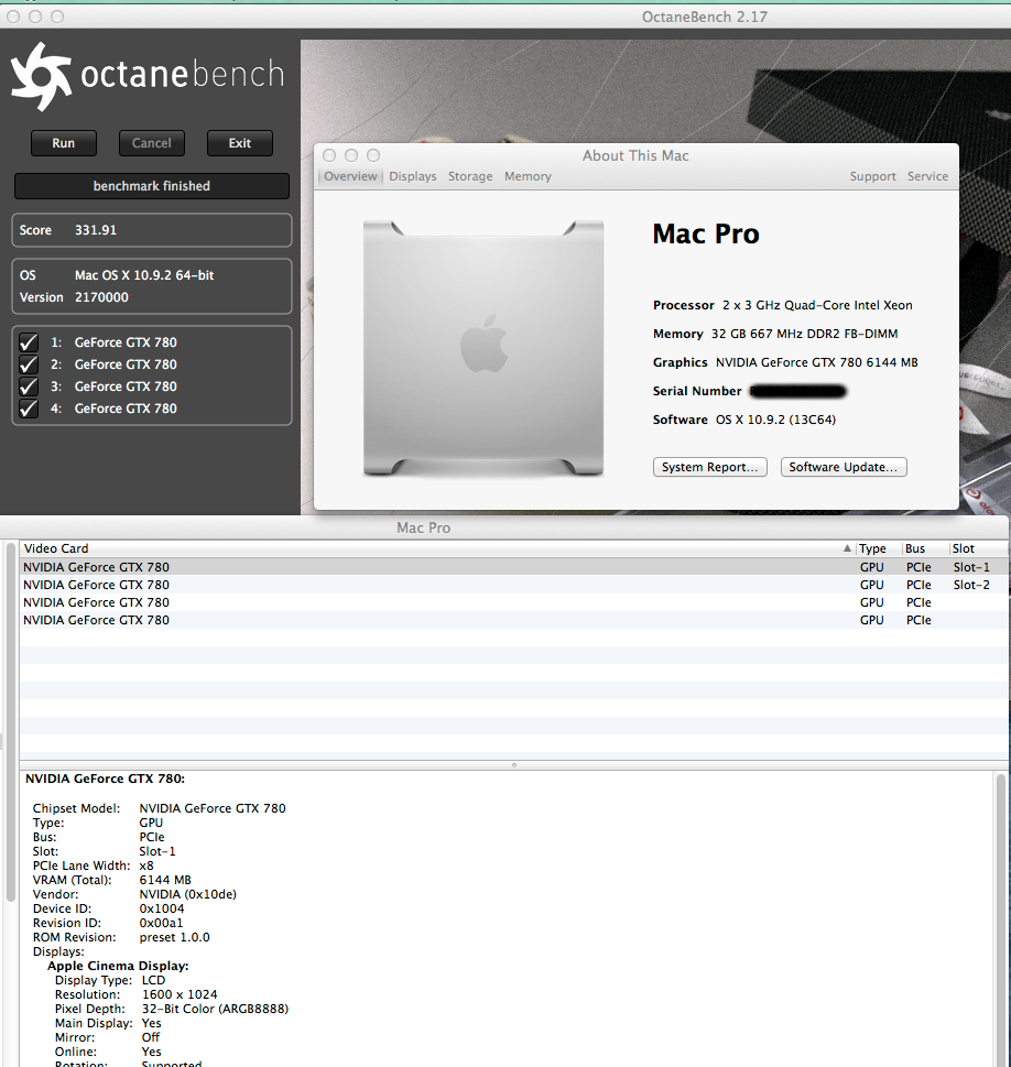

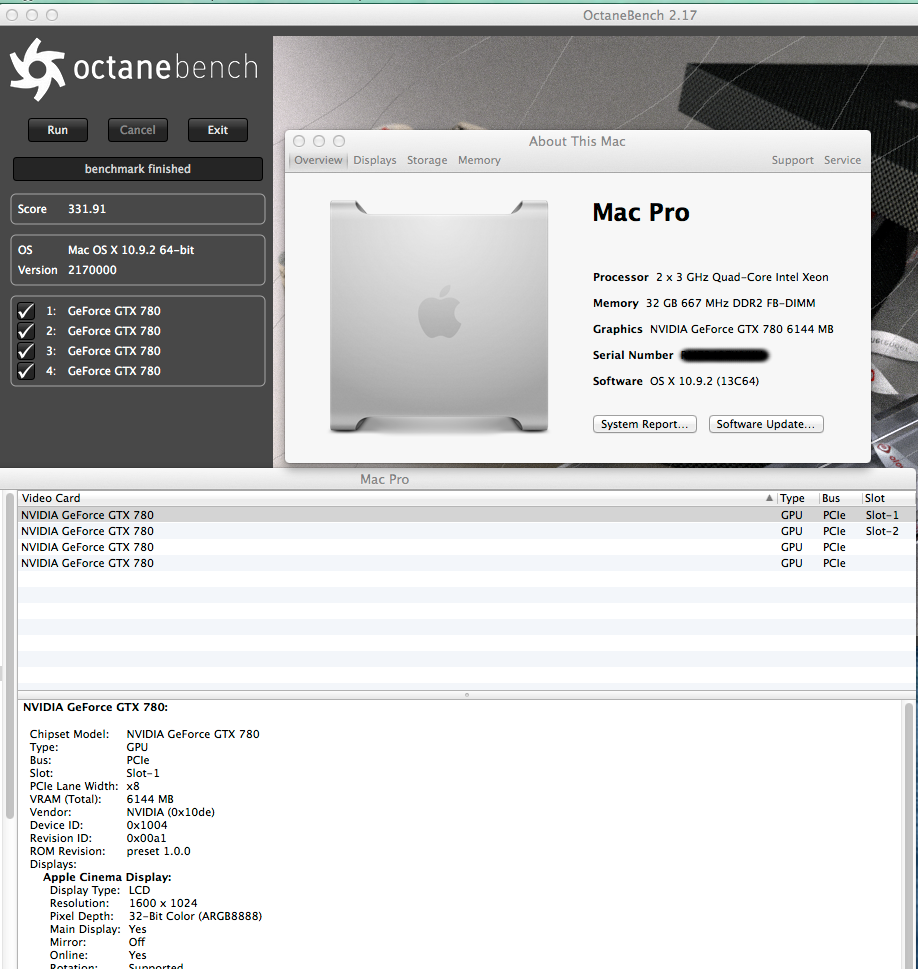

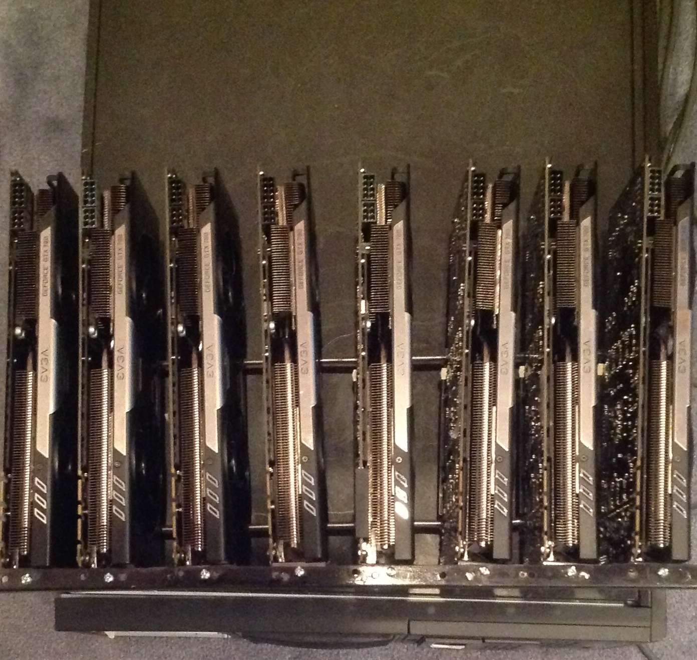

I have tested a $200 (USD) Amfeltec Splitter (Supports up to 4 GPUs per splitter card - http://amfeltec.com/products/flexible-x4-pci-express-4-way-splitter-gpu-oriented/ ) on a MacPro2,1 (2007) with four GTX780 6G video cards (2 in MP and 2 externally connected by splitter - see 1st pic, below). The MacPro 2007 will support only 4 GPUs stably, even if externally connected (i.e., it makes no difference which external chassis you use and it makes no difference how you allocate the GPUs internally or externally at least with OS 10.9.2). That's because of the IO space limits of the 2007 MP. I'm not sure whether that limit applies to the 2009 and later MPs. You can put up to three double wide GPUs internally in a MP 2007 to MP 2012: See https://forums.macrumors.com/showth...ld+mac+pros+can+make+respectable#post18872245 and https://forums.macrumors.com/showth...ld+mac+pros+can+make+respectable#post18887464 . Extra PSU is required in all cases for three or more recent GTX GPUs with significant rendering ability. Second pic, below, shows rack module of 8X GTX 780 6G GPUs from which I ran test using 2 of them. The rack of 8x GTX 780 6G GPUs is for my Supermicro server.
Thanks for all the links Tutor. This is just to confirm I've been following up with all of those and some other bits I found, and it clearly comes down to the amfeltec product being by far the least expensive and flexible option:
http://amfeltec.com/products/gpu-oriented-cluster/
Those go for about $500 plus shipping. A long shot from the $3500 and more for the enclosed chassis by cubix.
