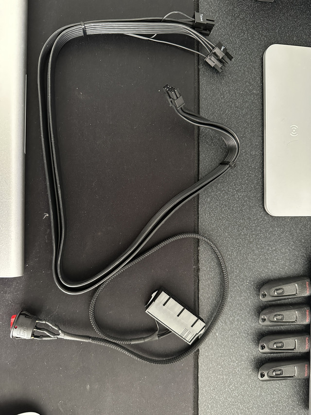

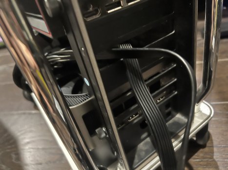

I run a 4090 in my mac pro 7.1 with win 11. i use an external corsair SF-750 psu with corsairs own 4090 flat cable which i pass through a PCi slot on the rear of the mac. i use a PSU switch as per picture below to switch on the psu to power the 4090 when booting into win 11.
Has been working flawless for 6 months and the 4090 kick's in win 11. but when in Mac OSX i dont switch the 4090 PSU on. had no issues at all in OSX as the 6900xt does OSX.
In win 11 disable the 6900xt in device manager, no drivers loaded for AMD just the Nvidia drivers for the 4090. boots straight into win 11 and again had no issues.

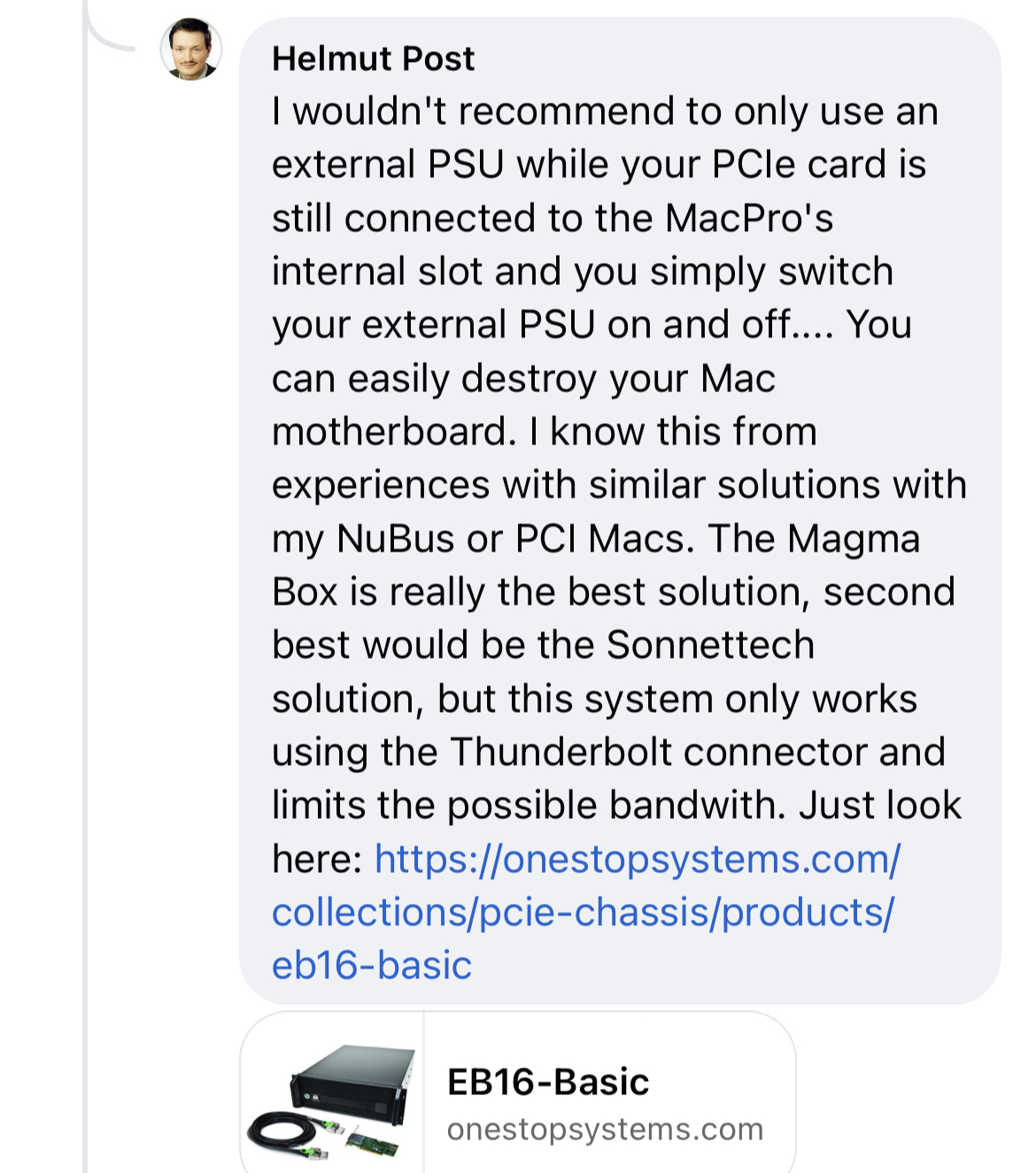

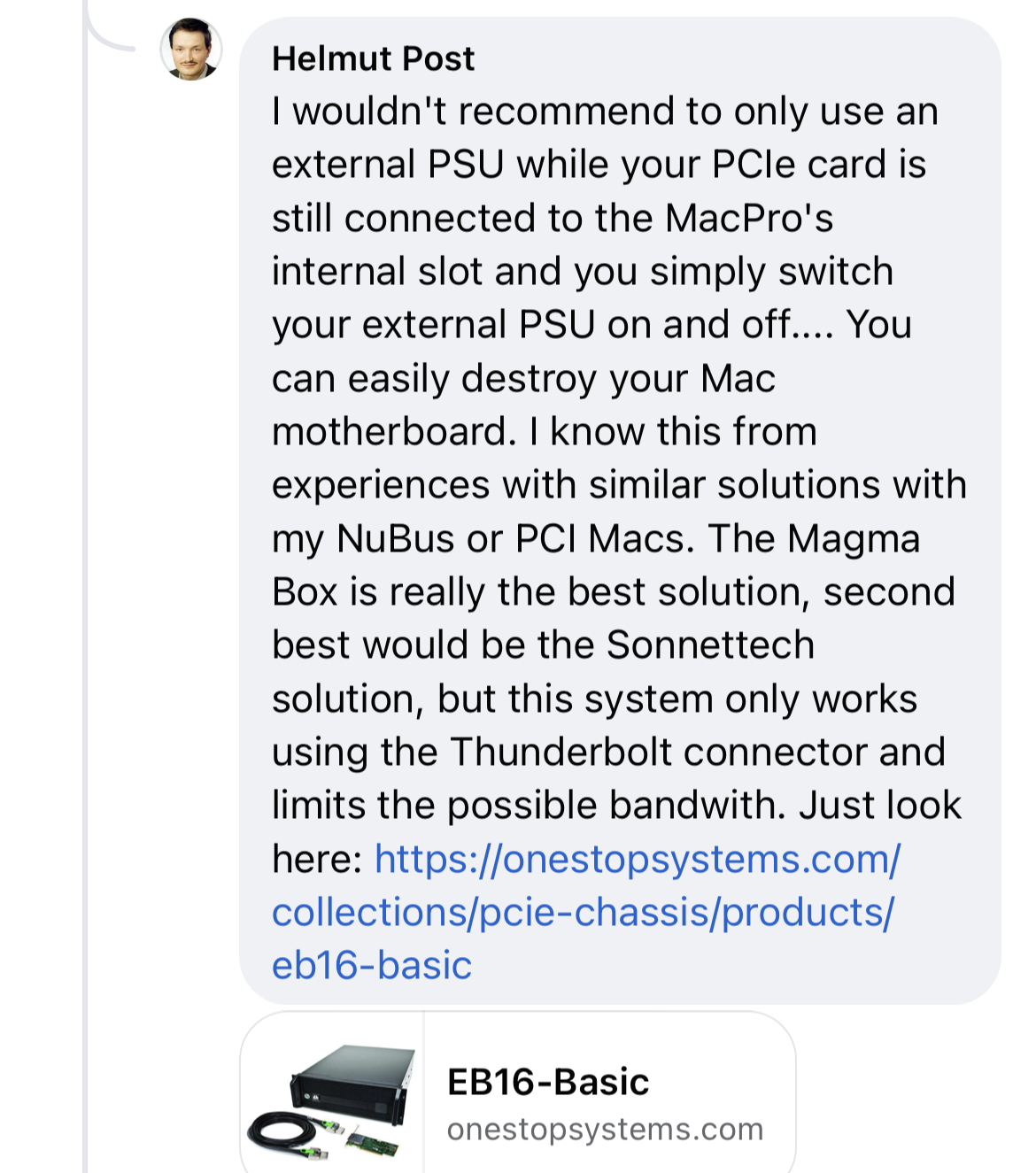

This guy isnt recommending in facebook as he says it can break Mac Pro’s motherboard. Any reason why it would do that? Why would it when you turn it off when you are not using it and simply powering it on when you are using it on Boot Camp? I bought Corsair 850w psu.

Well i have had no issues with external PSU and why would it destroy the mac logic board? there is no way it can really. if it has no power when in Mac OSX it cant boot. also you are protecting the Mac 7.1 PSU as its power comes from external PSU. as i said no issues here from the set up and its been running sweet for over 6 months, nearly 8 months but of course the choice is yours.

All ATX power supplies, differently from AT PSUs, need a power on signal (PS_ON switched to ground) from the motherboard to start (and remove it to stop providing power). The PSU switch on the back is really a power cut-out and not a start the PSU one. When the motherboard switches the PS_ON to ground the PSU starts, the additional switch does just that.
Got it so if I understood you correctly even if the PSU switch is on it wouldn’t be on so I would need that extra switch to turn it on for the psu to be really on. And where do I connect this extra switch to? To the psu or to Mac Pro? But I can’t find that connector in Mac Pro so I am assuming on the psu right?
Yes. The green wire (PSU_ON) when showed to ground is what makes the PSU to work.

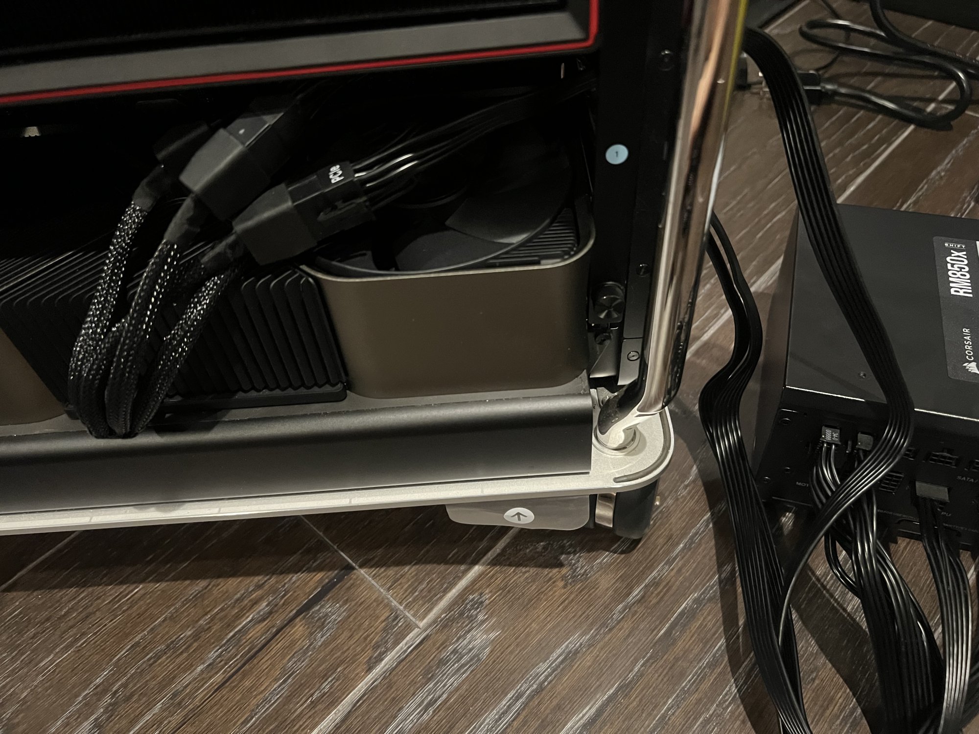

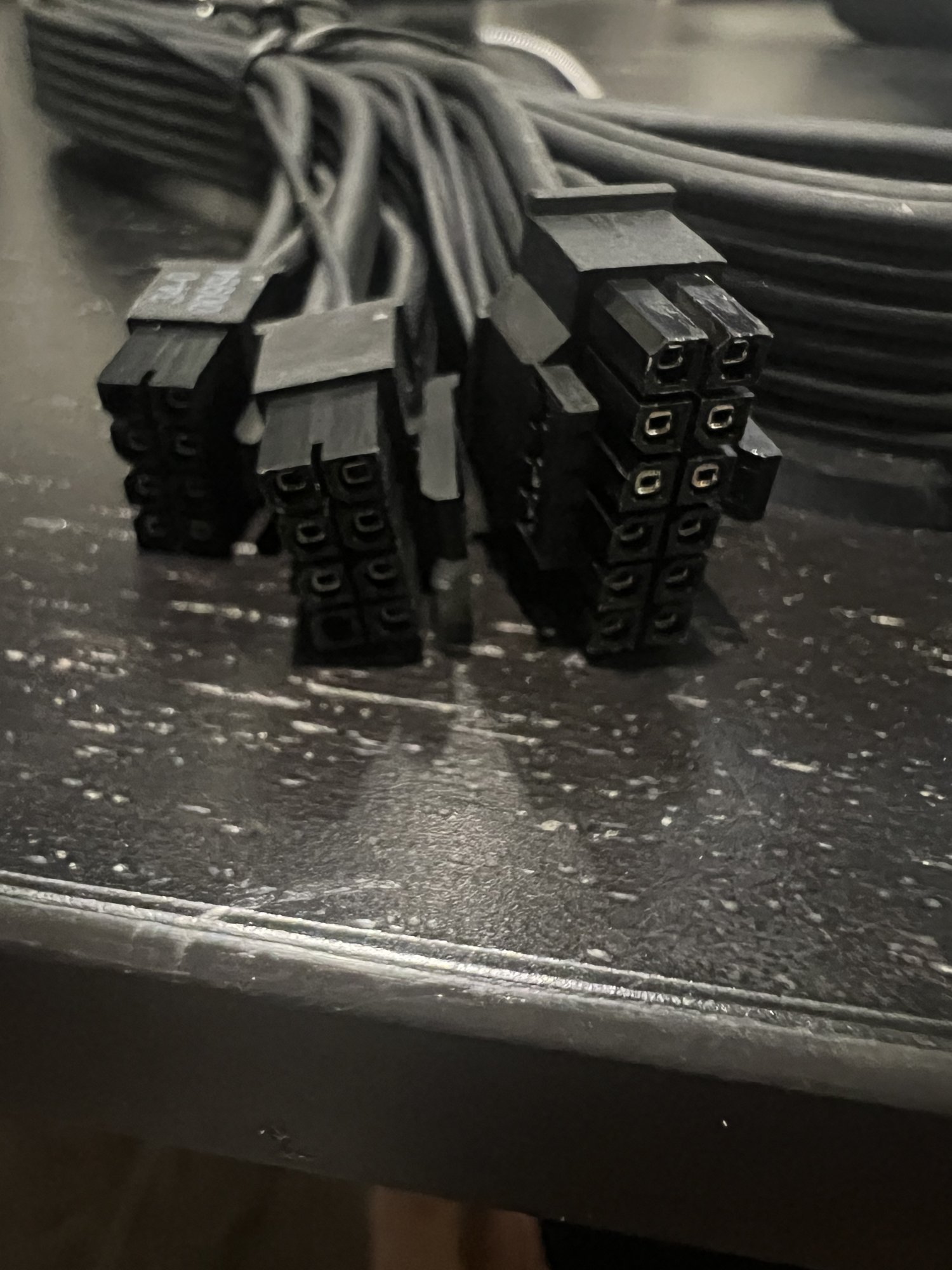

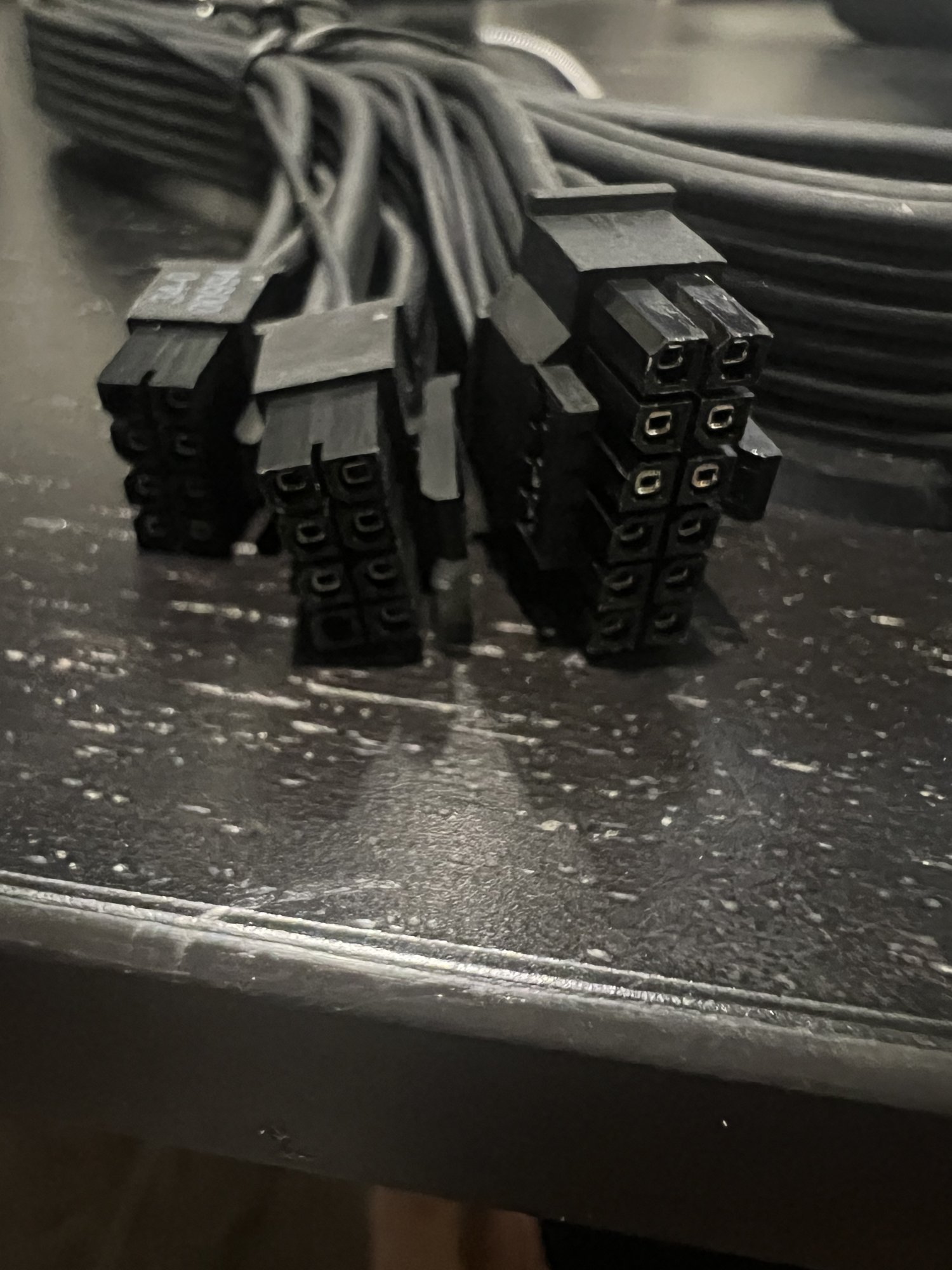

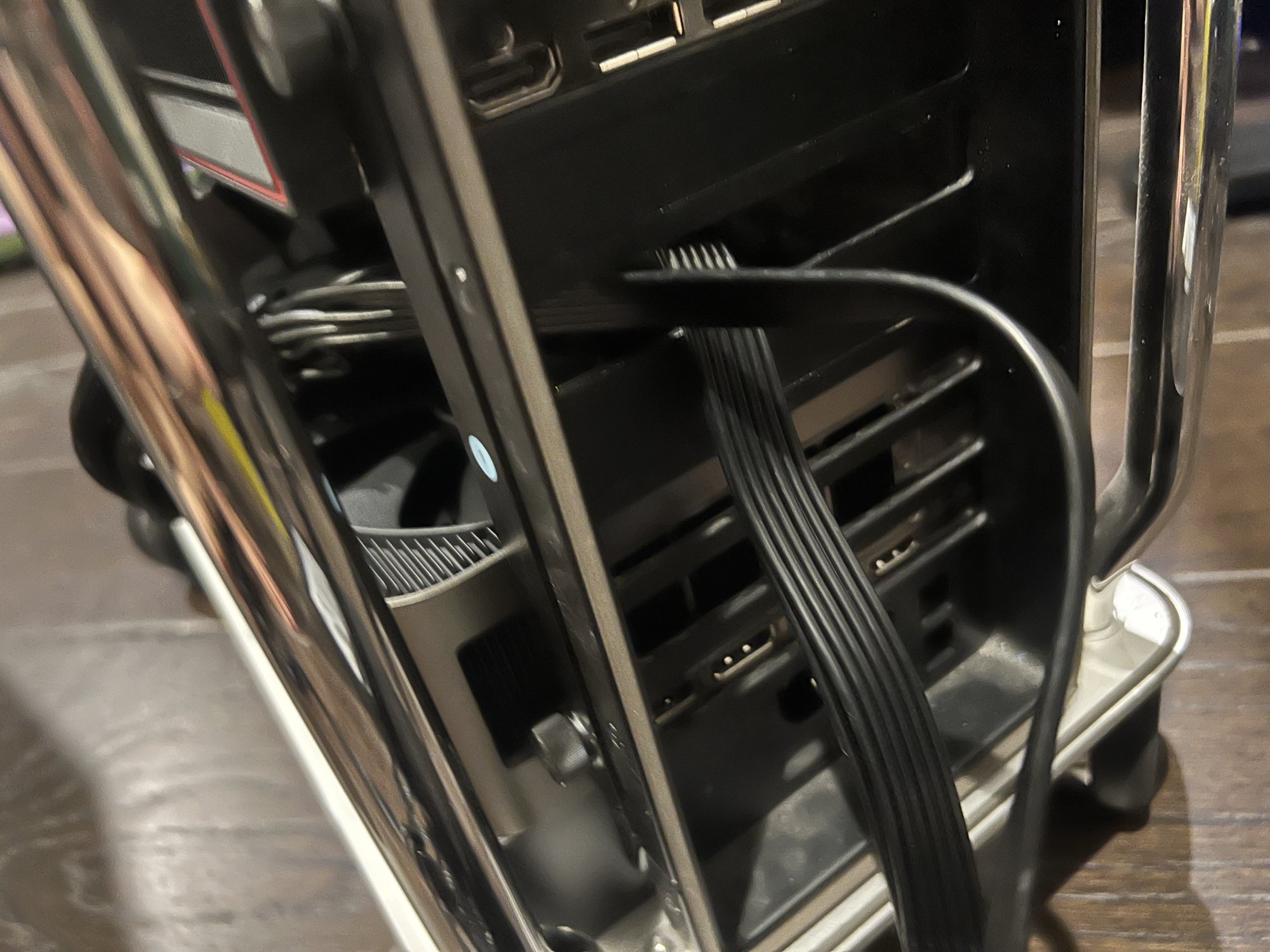

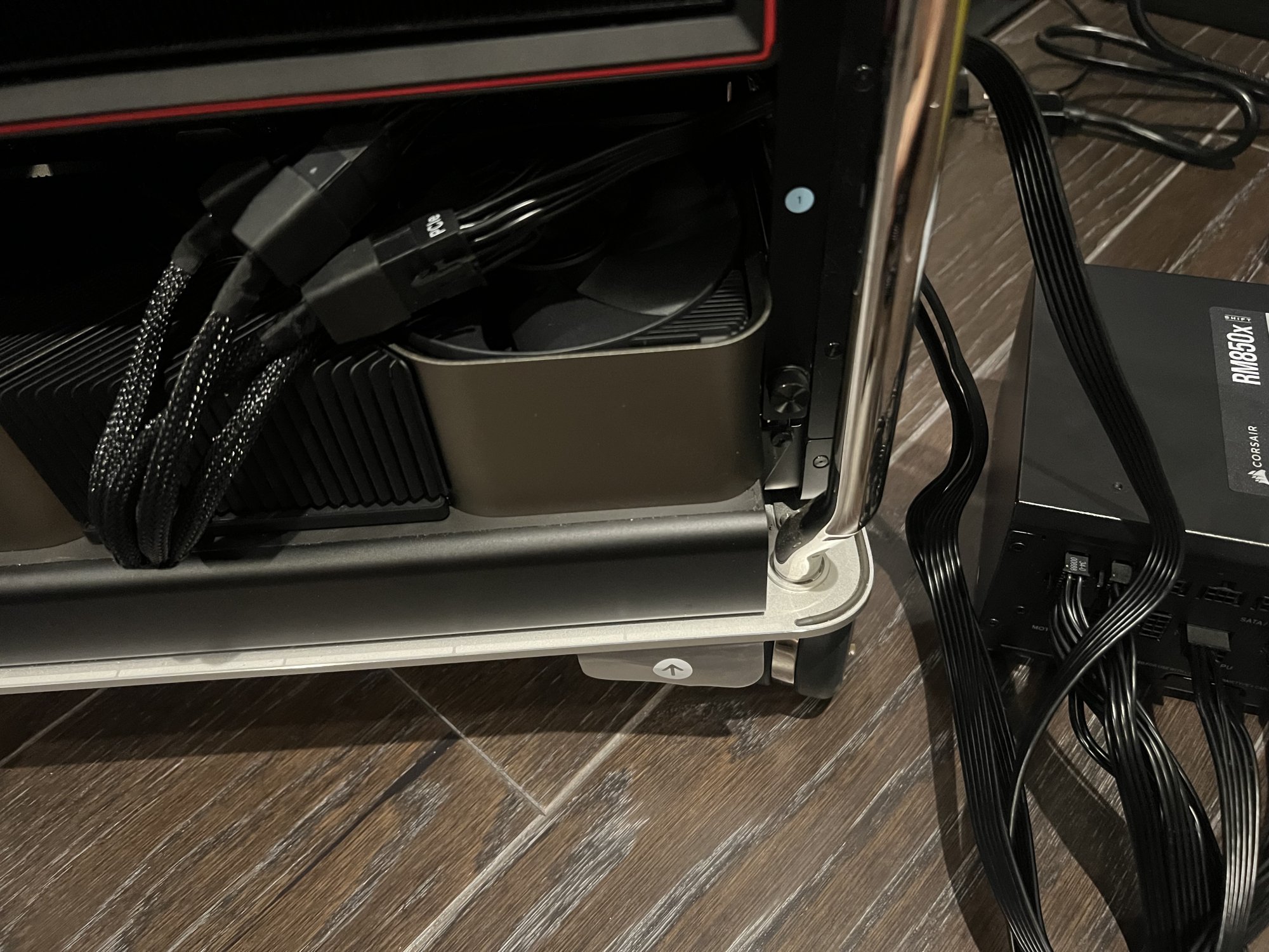

So I cannot close the Mac Pro because I need to connect the cables from outside after they are closed. But as you can see in the photos the original connector that came with RTX4090 is too short as it is connected to the GPU power very closely. How did you achieve this? Can you share how they are connected on your build? You also said you just used the cables that came with Corsair so are you talking about the 3rd photo? Would that be enough?

If you look at the picture i posted above that cable has the 4090 12 pin connector on it, you don't use the 4 x 8 pin adapter cable that comes with the 4090. look at the picture you will see the 12 pin on one end and 2 X 8 pin on the other. this is a genuine Corsair 4090 power cable purchased from corsair. as the cable is flat it allows you to close the case easy.
your pic shows the 4 x 8 pin nvidia cable adapter. look at the length of the cable in my pic above.
Oh so what you're saying is you had to buy a separate Corsair power adapter, instead of a lot of cables that came with Corsair PSU (in my case I bought the 850w one)?
thats right a new 4090 power cable from corsair. Only 1 cable comes through PCi slot at back, the corsair power cable.
