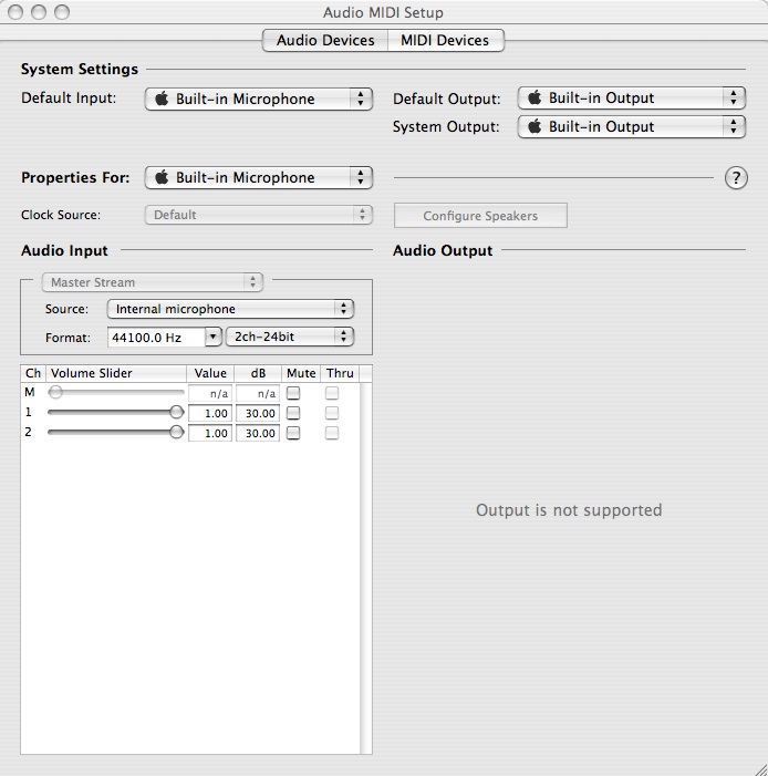

I'm running OS X 10.4.11 on an iMac 24". I recently used Onyx to clear some HD space and since then the external speakers won't work. The internal speaker is fine and the externals are live and working (I've tried them on another m/c). When I look at System Preferences > Sound there is only an Internal Speakers option (I'm sure there was an external option previously). Has something been deleted? If so can anyone tel me what and if I can restore it or download it? Thanks

Find Audio Midi Setup in Utilities folder, on the left hand side there should be Built-In Output. Select it and then use the gearwheel at the bottom of the panel to make sure it says "Use this device for sound output". Hope this works for you. I am having problems getting my external speakers to work after the Lion upgrade, but this should work for internal speakers OK.
If Built-In Output does not appear in the left hand column, use the plus sign at the very bottom and see if that finds it for you. Let me know how you get on.
Onyx – ran: Cleaning – Browsers' Cache, Download Cache, Browsers' History, Recent Searches. Can't see any way of getting anything back.
Tried Audio Midi Setup and there are only default options available (no alternative when I click on Default or System Output. Audio Output says: "Output not supported". I've attached a jpeg of the screen (hopefully).
Thanks for you help so far – any further advice gratefully received.

Embarrassing, major c**k up on my part (well partially). When I checked the cables the jack was in the input socket. I think my daughter had taken it out to use headphones and put it back in the wrong socket. When I tried the speakers on another m/c I just unplugged it and put it back in the same place without checking. I think me putting the problem down to Onyx was just a coincidence, all seems to be well now.
