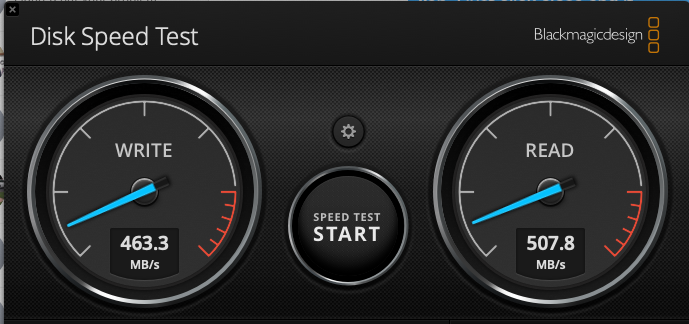

This is from a full (20gb remaining) 1tb Adata thats been in my PS4 Pro for about 2 years (upgraded it to 2tb).
