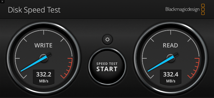

I have a new MBA M1 and a new Samsung SSD Model T7. Almost nothing on either drive. External SSD is plugged directly into the MBA. I am getting 650 MB/s on writes with the Samsung and 694 MB/s with reads.
I then plugged the Samsung T7 into my 2020 iMac and got 900 MB/s writes and 916 MB/s reads, significantly faster - about one-third faster -than the same drive on my new MacBook Air.
Both tests with the cable supplied by Samsung. The internal and portable drives are formatted APFS. Tests run with the Black Magic Disk Speed Test.
Any ideas why the Samsung drive is about one third faster when plugged into the iMac?

The consensus is that the USB 3.1 interface implementation on the M1 Macs is slower than Intel Macs. It may be drivers, it may be hardware, it may be some other limitation of the M1.
The problem also manifests itself with difference USB link connection speeds with different enclosures. Some USB 3.1Gen2 enclosures, which should support 10Gbps links, only connect at 5Gbps (USB 3 / 3.1gen1).

The T7 connects to my M1 Mini at 10Gbps, but is still slower than when connected to an Intel Mac. It is not just a question of USB 3.1gen2 / 3.2 compatibility.
You wouldn't be able to get almost 700MB/s via a 5Gbps connection. When connected via the 5Gbps USB-C on my Calidigit dock, the results are far slower:
There is something amiss with M1 USB interface hardware or drivers.

Correct. The M1 connects at 10 Gbps or 5 Gbps, but it transfers USB packets less efficiently (larger spaces between packets or smaller packets?) so it's slower than Intel Macs whether you're doing 10 Gbps or 5 Gbps. I haven't seen tests for 480 Mb/s but I don't think anyone cares about speed for USB 2.0 devices.
