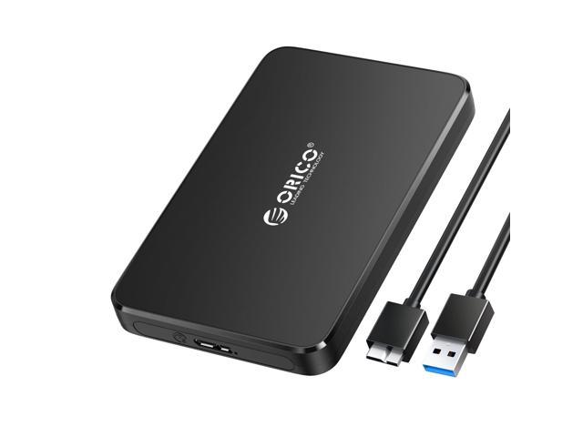

I used to own a Samsung 860 EVO 500 gig SSD (bare SSD), and I mounted inside an Orico Tool Free enclosure:
It worked out very well. I still have 2 Samsung 850 Pro 512 gig SSDs enclosed in such enclosures, and again very satisfied.
I think when the prices that the OP listed for TB drives, it might be worth it to just go the cheaper and use a USB3 SATA enclosure with a SATA SSD.

That Sabrent enclosure is just like the Orico one in my post above. I have 3 of those Orico models, and they work real well.
