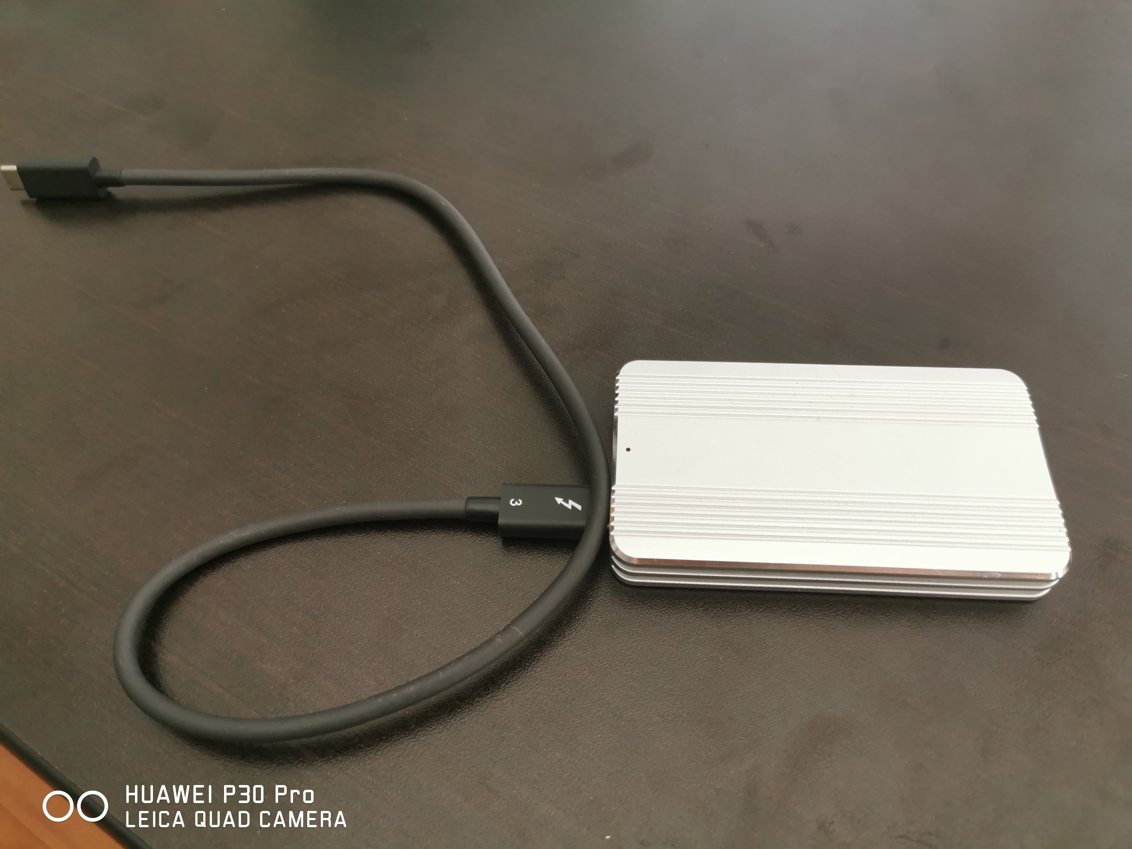

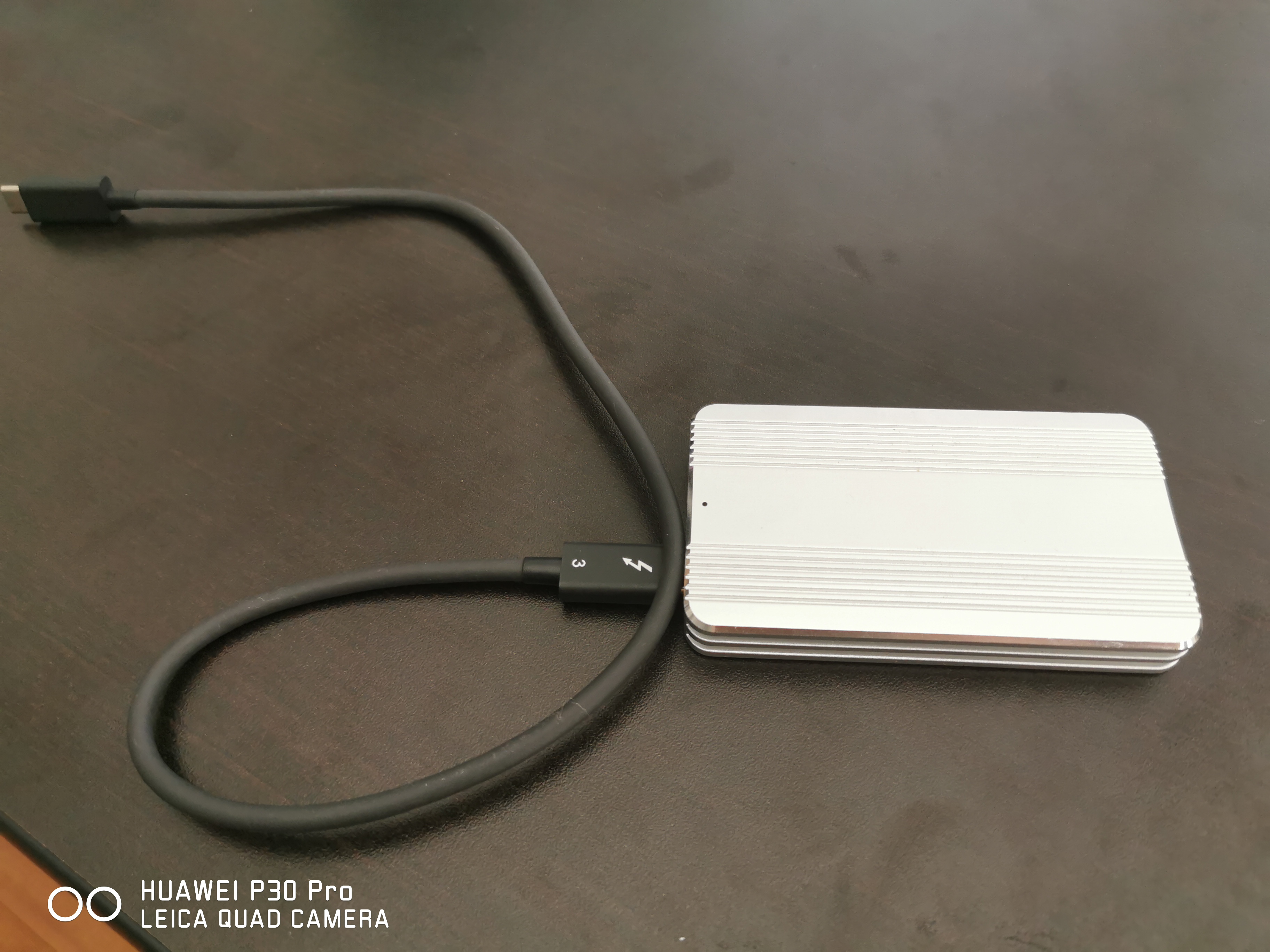

I would humbly disagree with you and offer my own setup as a counterpoint.
My LR library is currently over 2 TB. A few years ago I stopped storing it on my laptop and instead started using an external SSD drive. I initially used a Samsung T4 SSD 2 TB with a second cloned version of the T4 that I kept off-site at work. Once the 2 TB drive was too small I switched to a Glyph Atom Raid SSD 4 TB. With a LaCie Rugged Thunderbolt SSD 4 TB as my off-site backup.
The Glyph Atom is an order of magnitude faster than the LaCie drive. It is also significantly faster in my usage than the Samsung T4 (or T5 which I swapped in when 2 TB was still enough storage and I wanted a home backup of my photo library in addition to the off-site backup).
To your point about speed--an SSD drive is significantly better in actual use compared to a "spinner" drive. For working with individual files it may or may not matter (talking photos, not video). Uploading hundreds of files from a shoot (or trip), the speed difference can be noticeable. For backup purposes, the speed difference is huge. I can transfer GBs of files to/from the Glyph drive in seconds/minutes. Cloning the Glyph drive to the LaCie drive can take hours, depending on how much new data needs to be copied over. The initial copy of my LR library to the LaCie drive was an overnight affair. To the Glyph drive it was well under an hour, if I remember correctly. Of course the LaCie drive is quite a bit cheaper.
Portable SSD drives are small and they have very decent capacities. 2 TB SSD drives are fairly inexpensive. 4 TB SSD drives aren't cheap, but they are significantly cheaper than getting a new MB Pro with an internal 4 TB SSD.
The reason I chose to switch to external SSD drives for my LR library instead of storing it locally on the computer are several fold. As my photo library was growing, storage was becoming the main reason I would need to update my MB Pro. Since Apple SSD upgrades aren't cheap on a new laptop (and aren't possible on an older laptop), it became a fairly significant cost expenditure to potentially update my machine solely for storage reasons when I really didn't need any of the other hardware upgrades for my uses. A second reason to switch to external storage is that it can be plugged into any computer and isn't tied to my laptop. So if I ever get an iMac for example, I don't have to worry about keeping my LR library synced between the iMac and my laptop. Just plug the external SSD drive into whatever computer I am using. The final reason is that it makes backup significantly easier.
With my LR library stored on an external SSD it is very easy to clone the drive (using Carbon Copy Cloner) to a second or third external drive. Since the only thing on the drive is my LR library, it is quick and easy to clone it to another drive. One drive for off-site backup (at work in my case). Potentially another for a copy at home. The cloning process is quick since it's only my LR library and not all of my files (though as stated above, the LaCie drive isn't exactly "quick").
I also have an external SSD drive clone of my laptop's internal SSD at home, but those files are also backed up to iCloud and Carbonite. The only time I have ever needed to use the clone of my laptop was after a MacOS update that caused a startup loop nightmare because of an incompatibility with Little Snitch. The bootable clone drive (cloned pre-update) was *very* helpful in that case 😉.
