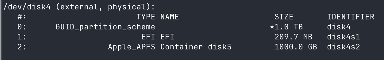

Formatting it as GPT creates an additional EFI MS-DOS FAT32 partition, unnecessary if the disk is used for storage.
It can also create confusions, as illustrated above where eraseDisk was directed at the EFI partition, instead of the disk.
Diskutil has two different commands
eraseDisk - Erase an existing disk, removing all volumes
eraseVolume - Erase an existing volume
Here is one of my external APFS SSDs. I see the EFI parition, but it's a meager 200MB, hardly significant.
