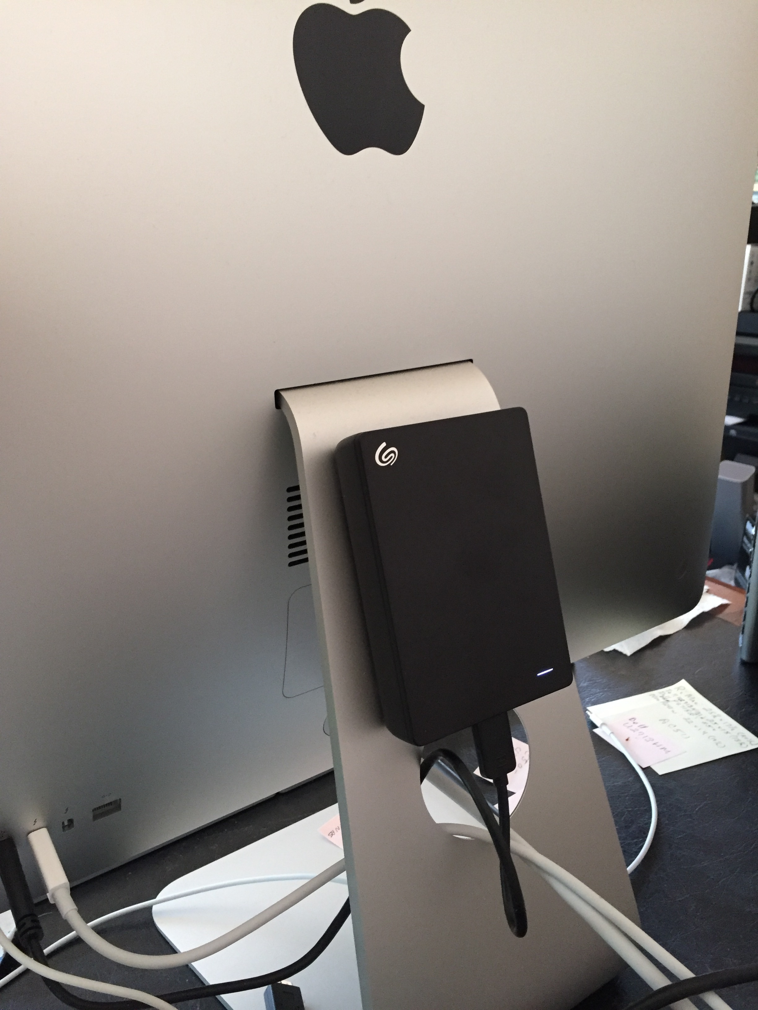

This is the Seagate Plus Fast 4TB RAID-0 bus powered drive velcroed to the iMac stand. You can purchase adhesive backed velcro (hook and loop) strips and dots at most stores which easily stick on the stand and disk drive allowing easy removal and attachment. They can be removed entirely without damage to either surface.
I have mine partitioned for 2TB bootable daily clone of the internal 2TB SSD, plus 2TB of archive/library/music files. I then use TimeMachine to backup the SSD and archive files to a Mac Mini RAID server over the network.

I really like the idea of the hard drive velcroed to the back of the iMac, it's out of the way and can just act as a storage and backup with time machine. I may definitely consider buying the Seagate Plus Fast.
Are you a music producer using Logic Pro? And you keep all project files and audio samples on the external drive?
