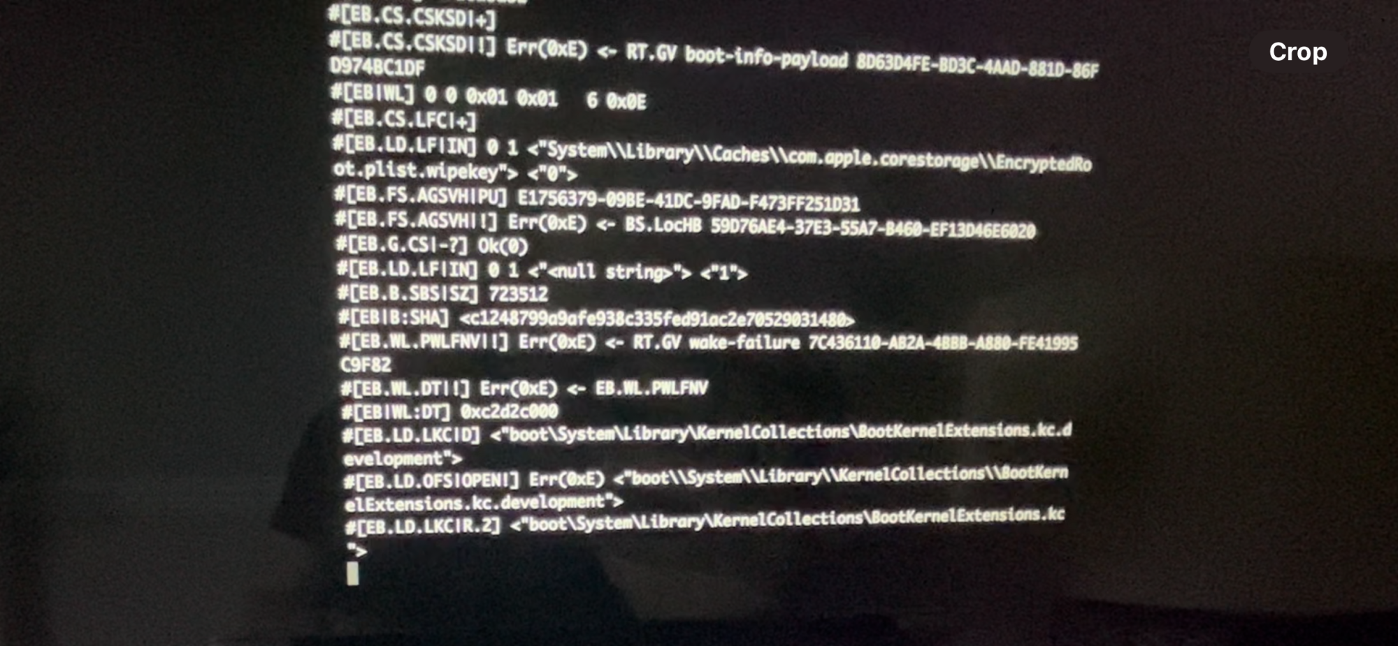

I bought an external SSD and enclosure (see specs below). However with clean Ventura installs on both drives, the Fusion Drive is 30 seconds to boot to login, whereas the SSD is 50 seconds to boot to login.
Tried using Monterey and it’s the same.
Holding CMD + v on boot, the Fusion Drive flies through all the lines without any stops, whereas the SSD boot stops a few times, notably at “boot\system\library\kernelcollections\bootkernelextensions.kc
Anyone have suggestions how to stop the boot pausing at this step?
"bootkernelextensions.kc" is kernel cache. The pauses are most likely the kernel cache rebuilds/updates. Try booting into Safe Mode off the USB external SSD. Should delete several kernel caches. Boot normal several times and see if boot times off USB external SSD improve.
