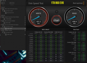

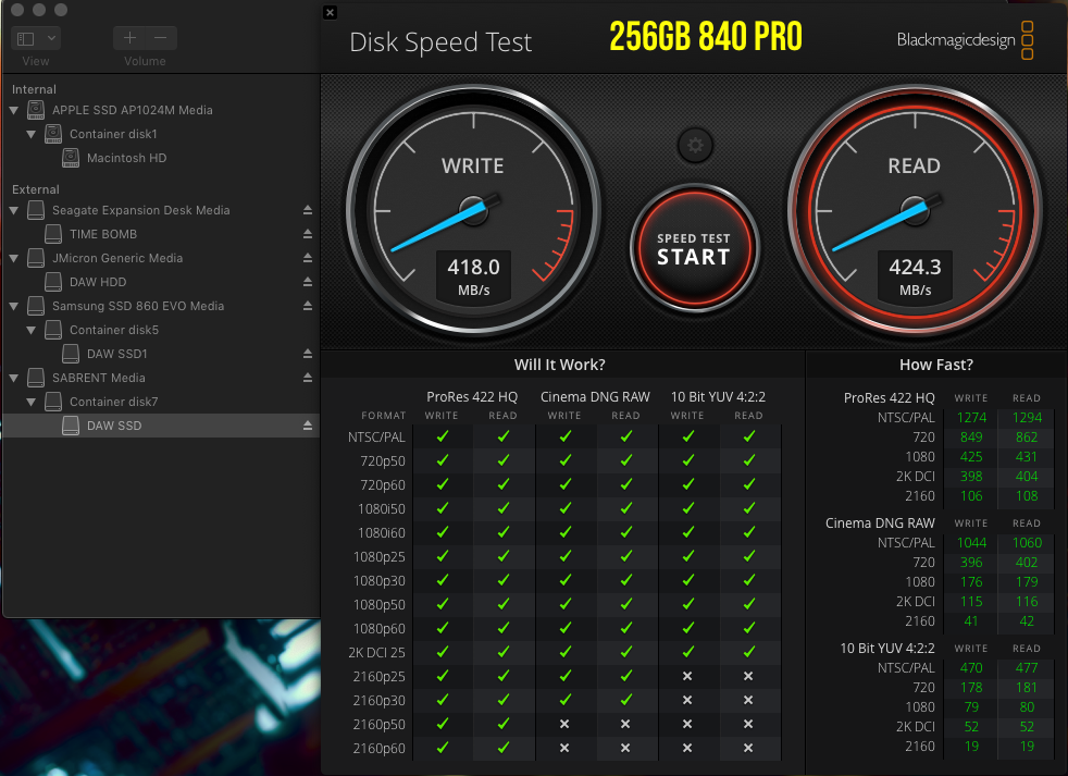

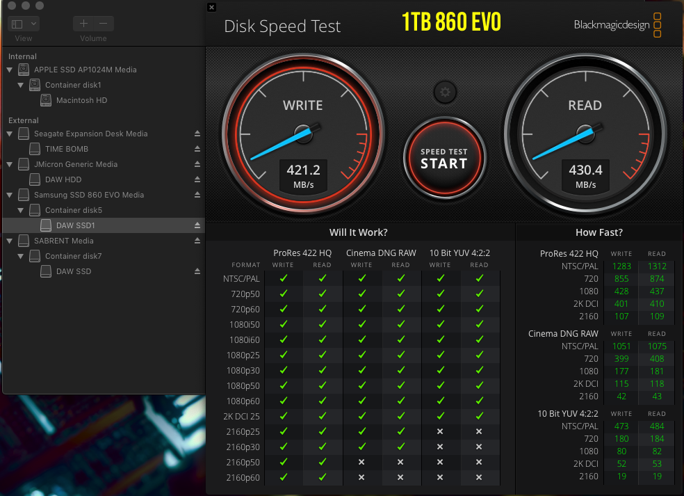

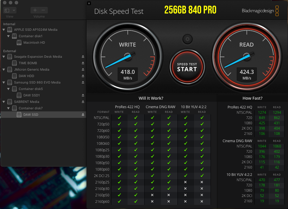

[doublepost=1555394229][/doublepost]Here are two benchmarks results tested just now. The first is the new 1TB 860 EVO, the second is the 256GB 840 PRO. Both seem to hit the same wall as I explained above.
The 1TB is in a Vantec USB 3.1 gen2 enclosure. The 256GB is in a Sabrent USB3.0 enclosure. But Ive tried either SSD in either enclosure, same results. I've tried other enclosures I have as well, same results. All my enclosures are USB3.0, with the one Vantec being 3.1 gen2, but that shouldn't even matter as USB3 should be enough to support R/W's at the suggested Samsung speeds 550/520, no?

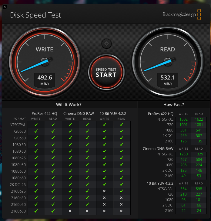

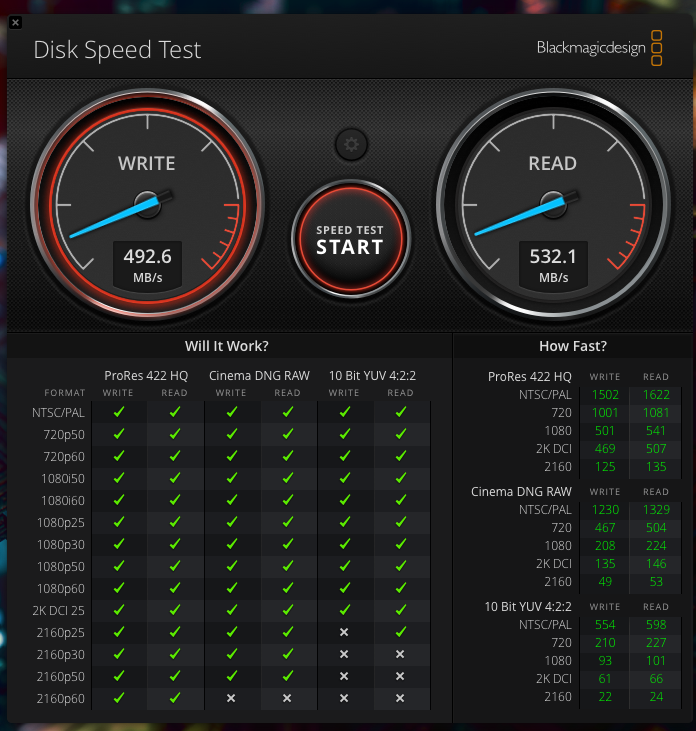

Well it appears I've been lied too! It seems that despite the specs of that "nifty" Vantec 3.1 gen2 enclosure listed on Amazon, they are being less than honest about it being gen2, or at least the molded cable attached to the controller anyway. So if you're looking for an inexpensive 3.1 gen2 enclosure, I suggest you steer clear of the Vantec USB3.1 Gen2 (CB-STC31-2PB) on Amazon!
I instead purchased a MediaSonic HDM-U31C and the speeds are much, much better and closer to Samsung Spec. [See attached Screenshot]
CONCLUSION:
I still find it very odd that a PC I built in 2014 is able to hit 500-550mbps via regular old USB3.0 enclosures on Windows 10, but for whatever reason I can't achieve the same in MacOS Mojave on a brand new 6 core 2018 Mac Mini using the exact same SSDs and enclosures. I mean, I use my Mac for work, the Win10 PC is a glorified Plex server at this point!
As a result, I still feel there is some deficiency happening in MacOS. APFS maybe? Some other bottleneck? I've no clue. But at least for now, I'm able to get the speeds I was looking for despite having to use 3.1 Gen2 enclosures with more headroom (5Gbps vs 10Gbps). Interesting. Confounding even! 😵
