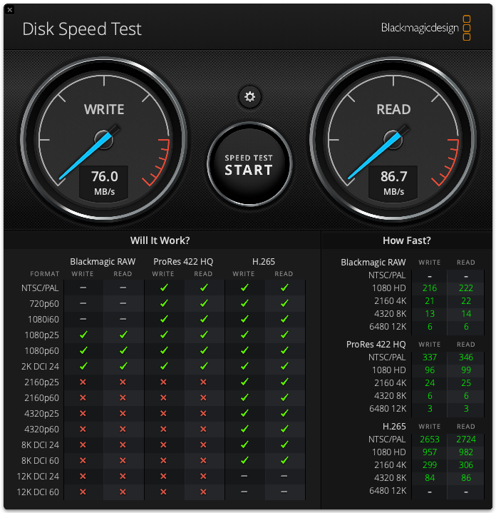

Finally I installed the Thunderbolt SSD Drive using a WD_BLACK 1TB SN770 NVMe. I'm using the Sabrent Thunderbolt 3 Enclosure. I installed Monterey 12.6.3 on the external drive and set that up as my boot drive. The results have been nothing short of fantastic.
I ran the Blackmagic Disk Speed Test with the original internal HDD and got these results.

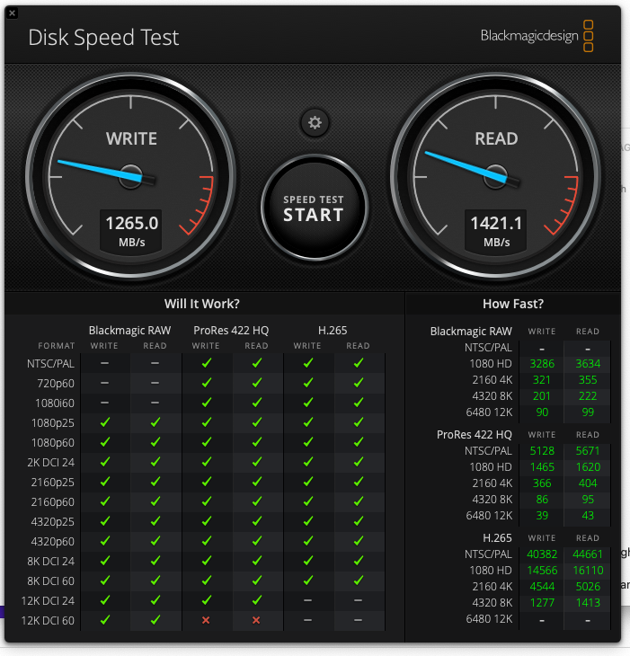

Following the installation of the Thunderbolt SSD my results changed to this for the external drive.
The system responsiveness has been outstanding. A relatively inexpensive upgrade (~$150 total) for a huge improvement in performance.
