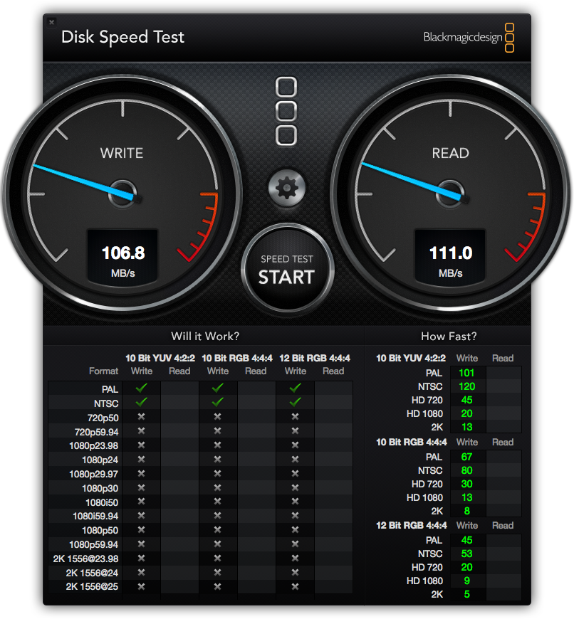

I ran my mid-2011 iMac OS and apps on an external SSD via Thunderbolt for a couple years (until I mustered up the guts to install it internally) and the speed bump is significant, even running externally. Take a look at the Speed Tests:
Internal HDD:
Thunderbolt External SSD:
Internal SSD:

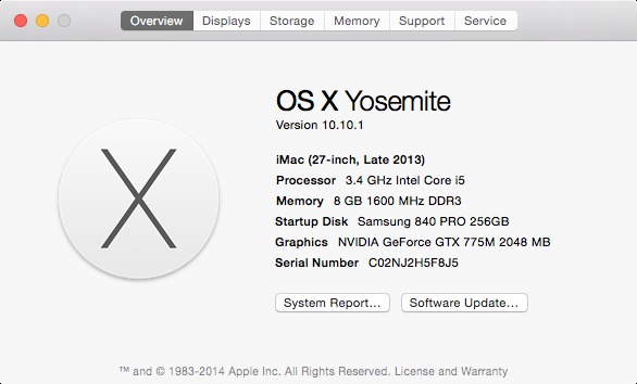

I have just run a couple of speed tests on mine since installing OS X on my new external Samsung 840 Pro SSD. I should point out the Mac is brand new today so doesn't have a lot of data in there at all. I should point out the external SSD is connected by USB 3.0.
Computer Spec:
Internal HDD 1TB
External SSD - Samsung Pro 840 SSD 256GB
So it seems USB 3.0 connected to an external SSD has better performance than Thunderbolt. Is that right?
I believe Thundrbolt is the better option but its more expensive to do. I wouldn't compare my results with the ones above as we have a totally different spec'd machines.
USB 3.0 seems to be marginally faster than Thunderbolt in benchmarks. I doubt it is noticeably faster in actual usage. Thunderbolt is definitely preferable for the ability to enable TRIM and run firmware updates, etc.
