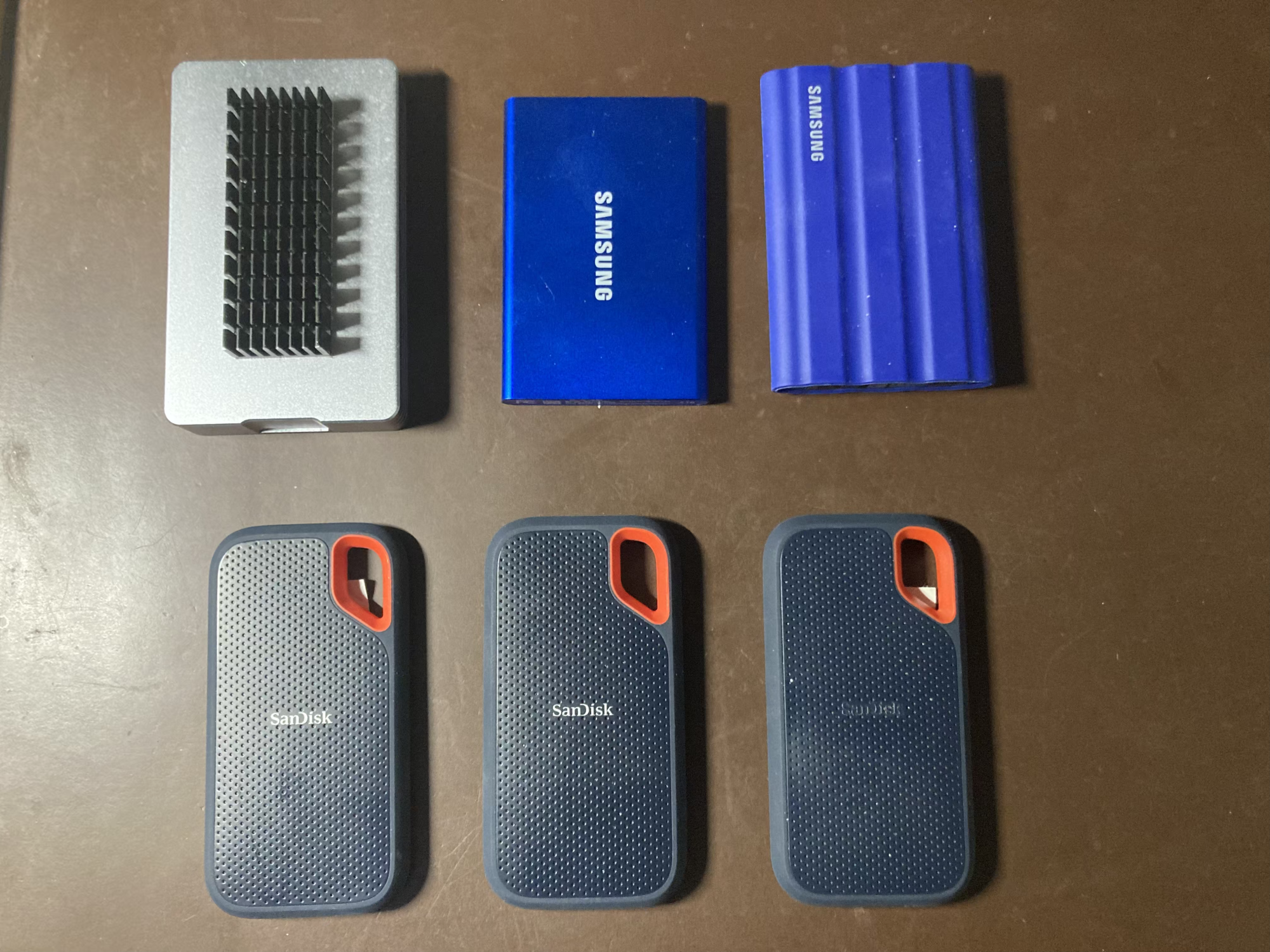

Top Left 2TB Samsung 980 Pro in Acacis enclosure with added heatsink. Middle standard Samsung 2TB T7. Right Samsung 2TB T7 Shield. Bottom 4TB SanDisk Extreme V2, total 12TB. The 2 on the left are a 8TB RAID setup.
