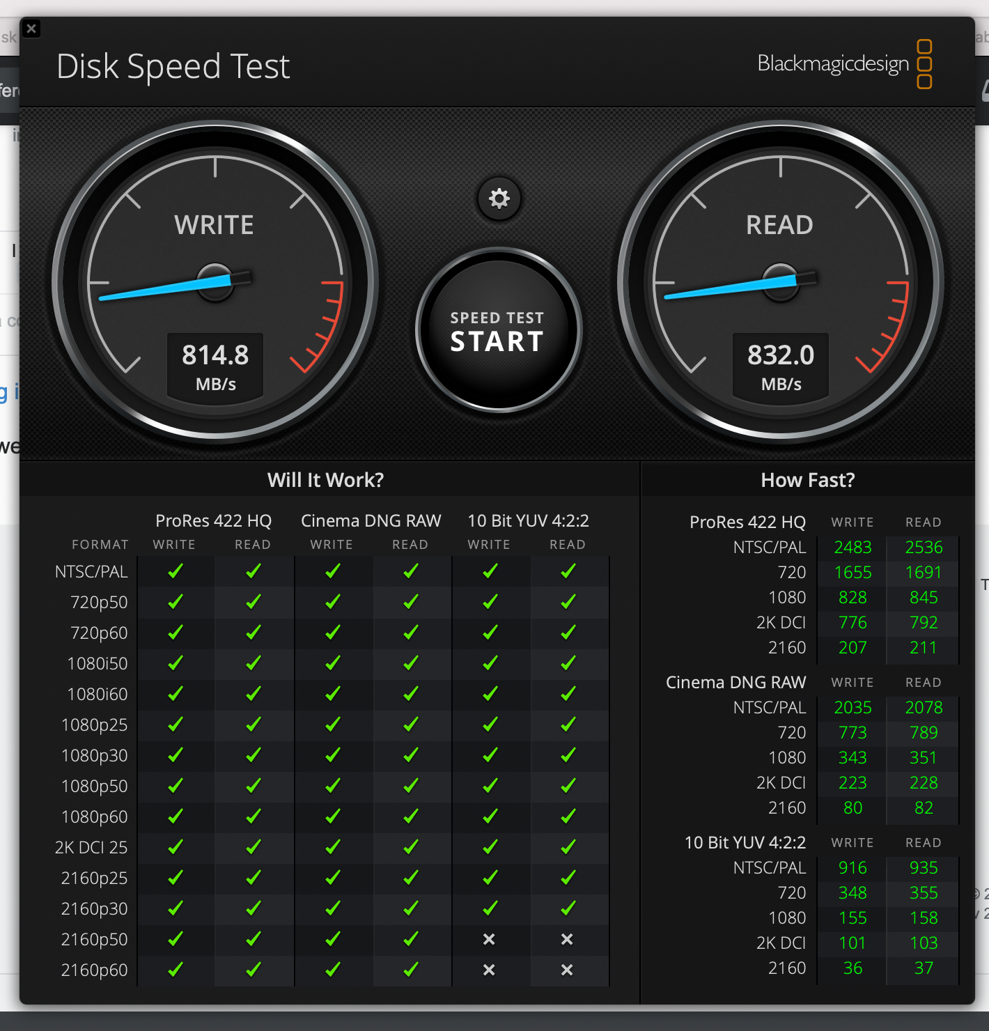

Did some testing with the SanDisk 2TB Extreme Pro which is capable of up to 2000MB/s with sequential read/write. I used the BlackMagic Disk Speed testing but the speeds I am getting are closer to 900MB/s - I also have the disk formatted to APFS and not ExFAT.
For an example: 150GB takes ~3 mins to copy from my M1 disk to this SanDisk. Is that the expected result? Not sure.
Here are the speed test results:
I couldn't find a tool that benchmarks sequential read/write speeds which is what SanDisk is claiming with their up to 2000MB/s speed.

Thank you for testing this! Yours is the 1st review of a 20Gb/s (USB 3.2 Gen 2x2) device on the M1 Macs.
Unfortunately, it looks like Apple’s USB 4 implementation on M1 does not support 2x2 (20 Gbps) speeds and is limited to 10Gb/s. You might be able to confirm this by going to the USB section of System Report. So there won’t be much, if any, speed benefit of using the Extreme Pro V2 model over the regular Extreme V2 model (minor differences due to different SSDs inside)
It’s sad that this USB naming convention and standards fiasco continues. When USB4 was announced, many were hoping to get assured speeds. But it seems like one can get away by offering just 10Gb/s max speeds and still call it USB4. 🙄

Yes, I do see the supported speed for this is 10GB/s in System Information.
That said, the 1050MB/s and 2000MB/s are both the same price so bought the 2000MB/s in case next year we get beefed up Thunderbolts 🙂

I picked up a new generation 1 TB SanDisk Extreme last night from Best Buy for $150 before tax. I did some testing, too, on my base M1 MBA via Black Magic Disk Speed Test--Version 3,3, latest that natively supports M1 MacBooks.
I also tested the drive by copying a 48 GB folder comprised of PDF books from the M1 MBA's internal SSD to the external. It took 1 minute and 2 seconds.
If the Extreme Pro were the same price as the non-pro, I would have chosen the Pro as well. 🙂. Right now, the 1 TB version of Pro is $229 before tax.
Also checked the USB tab under System Info. It says the disk speed is up to 10 gbs.

Similar speeds for this SSD on M1 Mac Mini as well. On the 2018 Mac Mini, I get over 900MB/s in the speed test.

Alrighty, guys, I returned the 1TB new gen SanDisk Extreme USB SSD and picked up a new gen same size Pro from Amazon. Both Best Buy and Amazon were having a sale on the 1TB new gen Pro Monday for $169.99 before tax. $169.99 vs $149.99. $22 difference including tax, but the speed of the Pro is about 200 MBS faster in read/write than the non-Pro. See figures below, please.
Pro:
Non-Pro:
I think it is worth it, even under the constraints of the current M1 Macs' USB speed.
PS: Both were tested with the latest version of Black Magic on a base M1 MBA.
