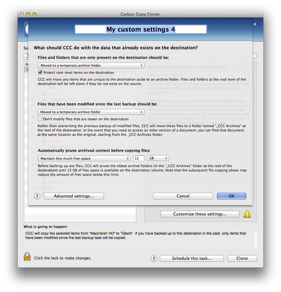

You most likely can't solve this without starting over again, there are plenty of duplicates in OS X, the System needs then even if they are duplicates.
What you could do though is restoring parts of the System with the help of Carbon Copy Cloner.
Select the good one in the left source pane, the Target in the right pane, un-tick all Folders except bin, cores, System, private, sbin and usr.
Be very sure to set protect folders at root level, if you forget it will delete them.
Then start.

Yep, but as I said before, be careful, CCC is a very powerful App, actually it uses OS X built in commands to do its job.
If you never used it you could do a test on a different HD to see how it works.
Hope it works out.

I'm pretty familiar with CCC, and it worked!!! Very good suggestion. I seem to have lost an IP address along the way, but I can resolve that.
