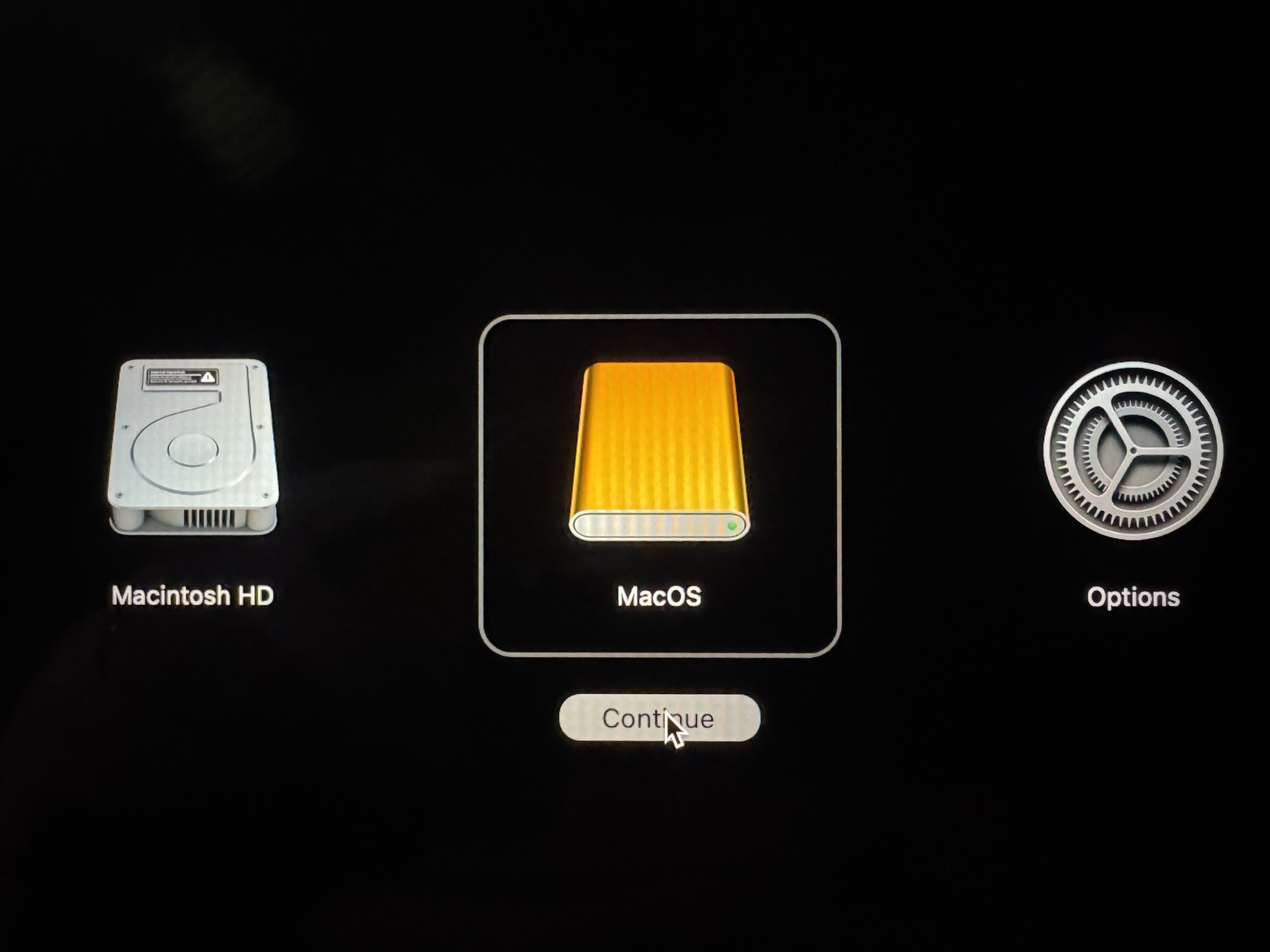

I have created, I think, an external startup disk for my M4 Pro MacBook Pro. I have followed the instructions on the Apple support site. I downloaded MacOS Sequoia from the App Store. I connected to the SandDisk 1TB SSD to the non-DFU port and formatted the external disk as APFS using the Disk Utility. I selected that drive onto which MacOS should be installed. I followed these instructions.
All seemed to go OK. I then restarted my Mac, held down the power button on the upper right of the keyboard. I get the startup options with the MacOS disk on the MacBook, the external startup disk that I just created, and the settings icon. I click on the external disk that I created and nothing happens other than the Continue button dimming.
What am I missing?

Have you cloned it? Or reinstalled? Cloning never worked for me to boot. It always stopped at the beginning of the progress bar. With a reinstall it worked.
Also only Thunderbolt connections really work reliably. Do you use USB maybe?
At least there was a warning in Carbon Copy Cloner not to use USB. With 15.2 you can't even clone a boot drive anymore.
I just used the macOS full installer from the internal drive and after the installation the Migration Assistant, that worked fine with a TB4 connection.
This was on an M3 iMac with some beta of 15.1 or 15.2 I think. Cloning the drive with Super Duper or CCC was before 15.2 when it still worked, but it couldn't really boot for some reason.

The problem could be that the drive only has a USB 3.2 connection. I read you need Thunderbolt 3-5 on both sides for real compatibility.
I am not sure if it doesn't work at all. It least it's not recommended to use USB.
Were you able to get in the security settings of your external drive and is it set as permanent startup drive?
I also have SIP disabled on my iMac. I don't know if you need to do that but I don't think so.

It really should have worked as you seem to have done everything right. In the early days of Silicon external booting was very flaky and I sometimes found that doing the same thing again worked second time, perhaps a different lead, (as the only thing easy to change).
All I can contribute is that you do not to disable SIP, or reduce Startup Security or use a Thunderbolt drive. I have used the Apple method on a Samsung T5 recently and it worked. Thunderbolt is preferable because it is faster and SMART and TRIM are supported, but not essential. I have made many external boot drives since Silicon but I have not personally used a Sandisk one, but would expect it to work.
The macOS 15.2 problem is about cloning because it has to use ASR (Apple System Replicator) for the SSV and ASR seems to have a bug. So the macOS 15.2 issue is not relevant to you.

There is now way to start / Boot from this disk without a certified Thunderbolt Cable, and no, the one is delivered with this drive is not one.
I would also not try to use this disk as boot drive, because it is slow and you can be very sure this does not work in any good way.
What works and is fast enough, is an Acasis TBU405 AIR or better Thunderbolt Case with a WD SN770 or WD SN850x NVME.

I realize that the drive would be much slower than the internal drive. I was not creating the drive to actually use the drive. I just wanted to see how it all worked. In this case, not.
I tried a Thunderbolt 5 cable, from Apple. The drive cannot even be formatted as APFS as I get an operation failed.

I have tried three times with the same result. A couple more and it would border on insanity doing the same thing over and and over and getting the same result.
Ah well, it was just an experiment to see how it is done and if it is even viable. I don't want to spend a lot of money to get another, expensive enclosure and drive, just to satisfy my curiosity.
Try in another port.
Apple Silicon's hidden restrictions drove me mad while trying to install Sequoia on an external drive. It failed repeatedly with no error, just boot loop. I had to select to copy my account when the installation started, then to create a new account when the installation finished.
That really surprises me. I have a mix of USB 3 and Thunderbolt 3 drives and have standardised on TB3 leads for simplicity. So my USB SSD's always get connected with a TB3 lead. I have never had trouble formatting a drive. I would expect TB5 to be backwards compatible with TB3 and behave the same with a USB 3 drive as TB3 cables do….maybe that is wrong.
