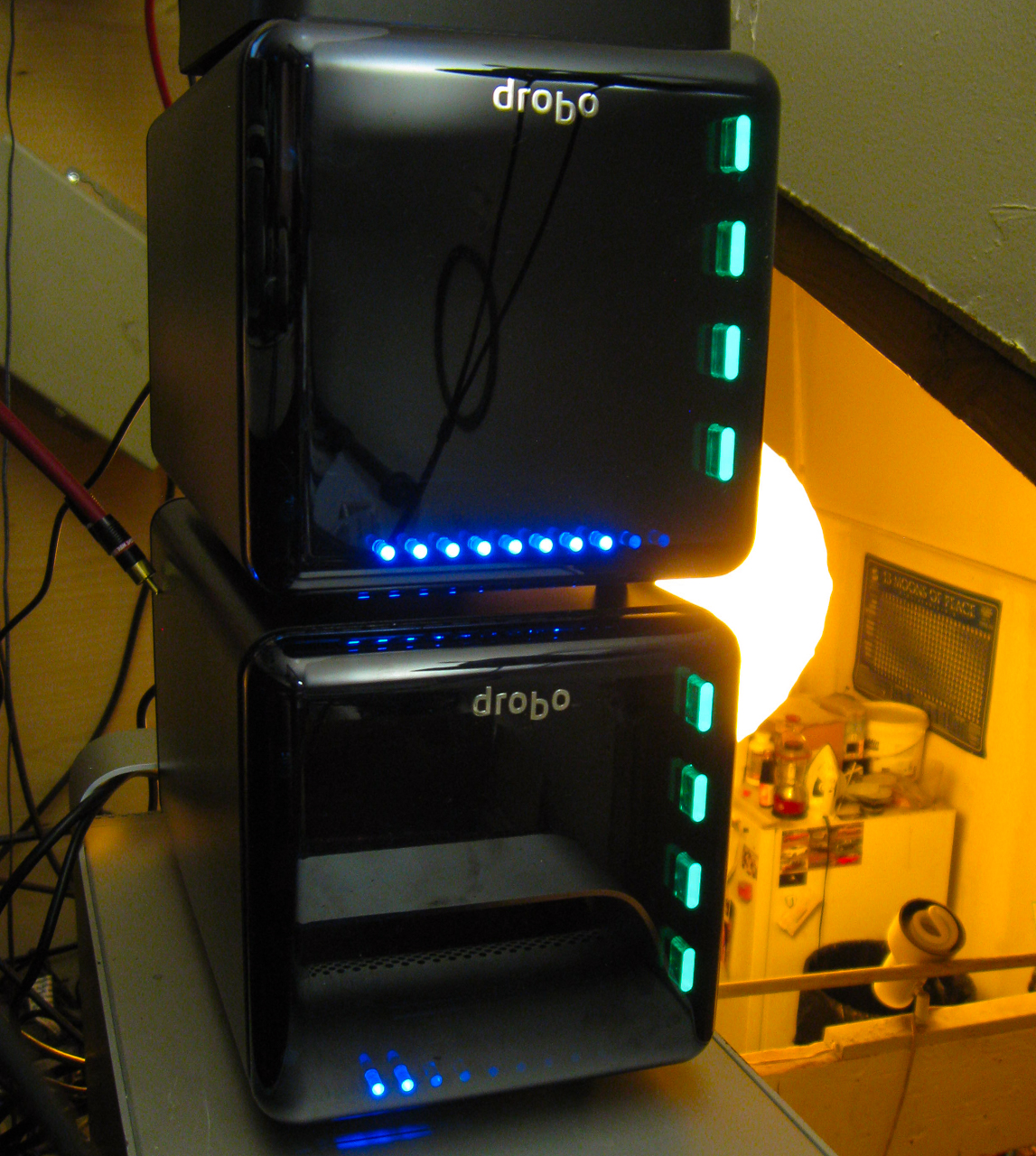

I've been a happy Drobo user for years. I just got another one on Black Friday for $199. from B&H.
