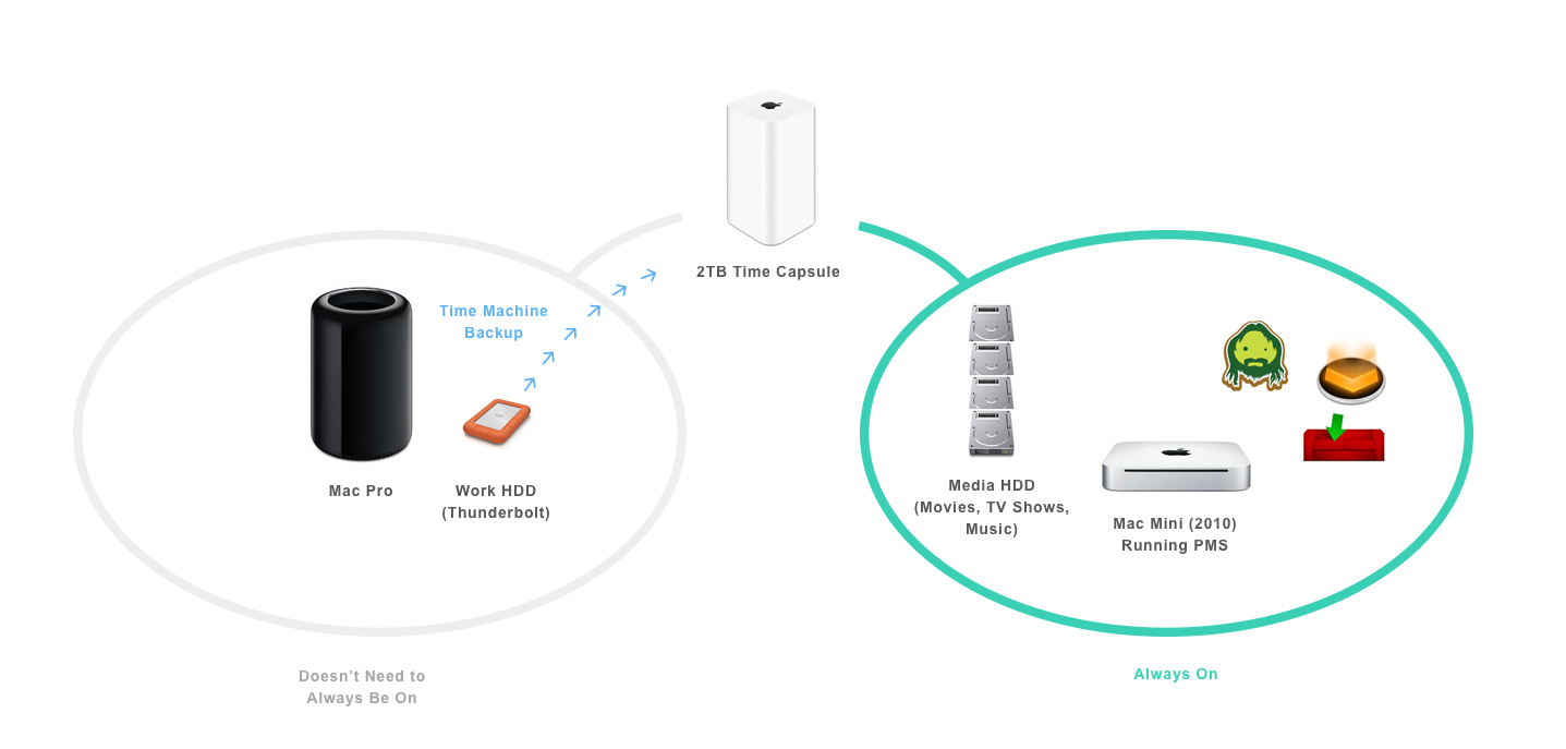

I've put together a little illustration of how I envision it. The question is, will this work for what I want to do? Any help or tips are appreciated from people with a similar setup. Thanks in advance!

I think I'm going to setup shop similar to my illustration above. I'm going to shop around for a good deal on a 2TB bus-powered USB 3.0 drive for the work, bite the bullet and pick up a Time Capsule to replace my ageing Airport Extreme and handle my backups as well as picking up the Synology DS413j on the cheap (i like the Synology brand and their interface is pretty cool) and connect it to my Mini for all my media needs. With all this done, I should theoretically be good to go!
This is almost the exact same setup I have. The only difference is that the TB work drive labelled in your diagram is a 2TB WD Velociraptor Thunderbolt Duo in my case (and it's for archiving photo libraries - active projects are on the nMP SSD).
Anyway, for your work drive, you could get a USB3 enclosure as others have mentioned instead of TB, but a lot of USB3 enclosures have disappointing performance... But they will certainly be fast enough for a single spinning drive. Where USB3 can become limiting is with an SSD or RAID0. If you go USB3 and want to use a SSD then look at the Firmtek product reviewed here... http://www.barefeats.com/hard168.html. Otherwise, for a single spinning disk, look at USB3 externals from your vendor of choice... Lacie Porsche, Minimus, rugged, etc. if you want TB and an SSD then look at the Oyen Digital 2.5" TB enclosure. I like the WD TB Duo products for a good balance of performance, capacity, and price (they are dual spinning disks configurable for RAID0 or 1 in a TB enclosure).
For your Media Storage, if your Mac Mini is on 24/7 as you say, there's no sense buying a NAS where you're paying for another box with a processor and embedded OS, just get a JBOD DAS and connect it to your Mac Mini and let it function as your NAS (just turn on file sharing in OS X and your media will be available to any Mac on the network). That's what I do. I use a pair of SansDigital FW800 enclosures which are problem free and quiet but if I were doing it over again, I'd probably get a Oyen Digital 5-bay Mobius and use USB3 or FW800 depending on what interfaces your Mini supports (FW800 for 2010 -like mine).
