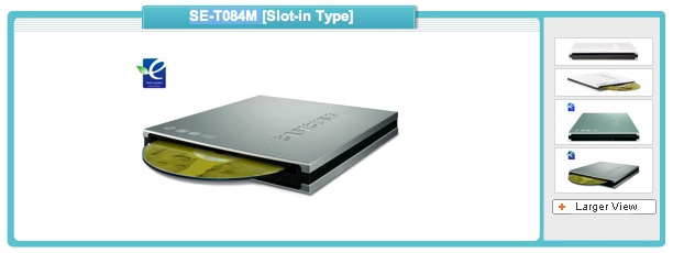

So I was over at Samsung and had a look at their slim slot-in drives:
SE-T084M
Will this drive work with my Mac? Do you think it is a reliable drive?
Cheers.
