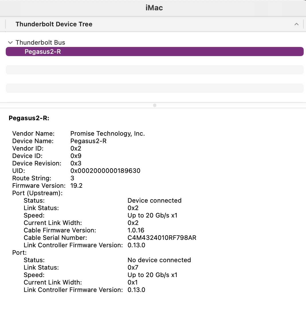

Here's the hardware report. Not sure if both Port statuses should be should be connected or not.
I don't have an answer for this. I know the new beta messed up connecting to network shares, so it could be it messed up something for external devices as well. Such is life in the beta world.
