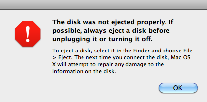

This morning for some reason whenever I connect the hard drive it shows up in Finder for about 20 secs & then disconnects with the error as though it was physically disconnected without it being ejected (see attachment).
Any idea why this is happening. I connected another drive to ensure it wasn't a problem with the USB ports. In fact right now I have my mouse & keyboard connected to those USB ports I was checking earlier.

Do you have access to another mac to try this drive out on? Is this a bus powered drive, or a powered one? If powered, do you have access to an alternative power supply that matches the one that came with it. It sounds like it could be power supply related, possibly.
After that, I might pull the drive from the enclosure and try it in a docking station (like one from OWC) as a bare drive.
Permanently connected to the Mac? Congrats, the hard drive is probably physically broken on the inside.
I've had the same problem myself too, with a Buffalo HD-PCTU3 5400rpm external drive connected to my Mac very often. Not to mention stuffing the drive into my pocket (my pants are quite baggy) after using, which means the hard drive's gone through quite some bangs and knocks.
As time passed, that drive made clicking noises. And not too long after, the hard drive failed completely (exact same scenario as yours).
Sent it to a repair shop and was told that the hard drive was kaput.
If your hard drive's not in a horizontal, flat position, congrats. It's most probably broken if it's not an external SSD.
Learnt my lesson after that, and switched my Macs to SSDs soon after.
Thanx for all your suggestions. I did have a backup of that drive so I am good. Will replace the drive.
