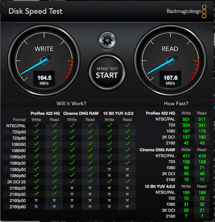

Here you get an idea. This is my three weeks old 27" iMac 5K mid-2017 with i5 3.5GHZ, 24GB RAM, Radeon 575 and 512 SSD. The external drive is a 1TB Glyph Atom RAID SSD which is one of the fastest SSD in the market. It's USB 3.1 Gen 2 so it connects to the Thunderbolt 3 port of my iMac.
Glyph Atom RAID 1TB SSD - USB 3.1 Gen 2
Internal 512GB SSD (27" iMac 5K mid-2017)
Just for the sake of comparisons, here is the speed of my 4TB G-Drive USB-C external drive. Check that both, the Glyph Atom RAID SSD and the G-Drive are connected to the Thunderbolt 3 ports on my iMac.
