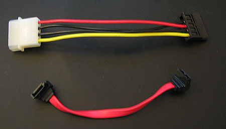

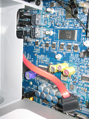

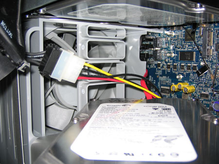

I just used the 4" cable and a sata power adapter. It was only temporary to see if this thing actually works and to get files off of the drive.

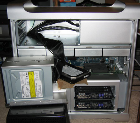

Here are some pictures. It's nothing much.
Remember, besides the Optical Power -- there are the 2 auxiliary power connectors for the PCI Express video card's "booster cables."
