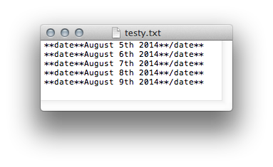

There's no need to surrender. Don't give up so easily. Here's an example with 5 dates to extract from a text file.
In Automator :
  1. Find Finder Items
  2. Run Applescript with the following code :
