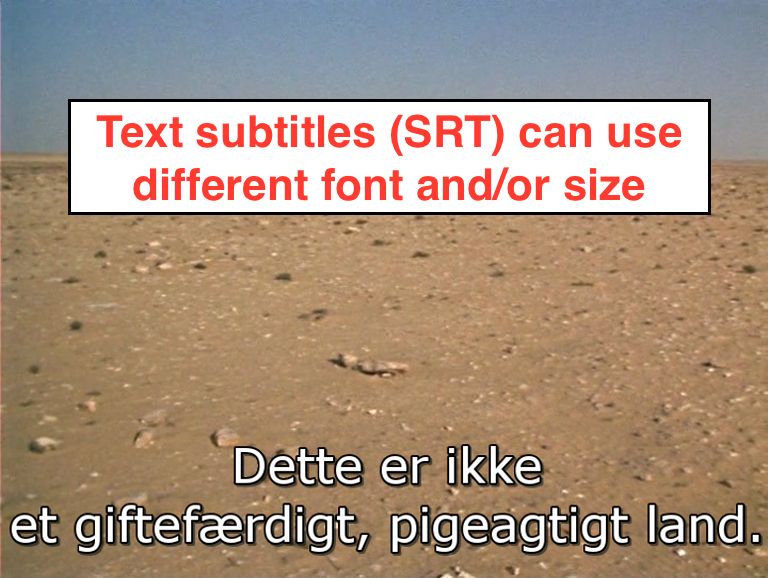

I find that a combination of Handbrake, Subler and Aegisub is the best way to extract subtitles. The subtitles on a DVD is basically bitmap (known as VobSub) and does not look very good.
Here is an example of the difference:
