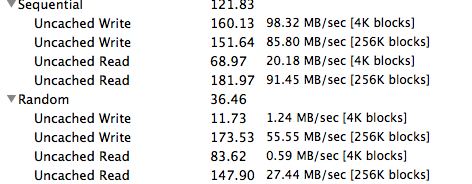

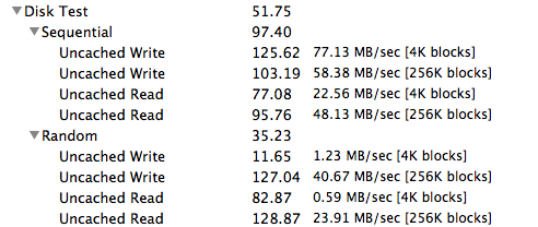

I ran xbench out of curiosity if Lion increased performance anywhere and found that in the HDD test the HDD results were usually 2/3 to 1/2 of what they were in SL. not once did the uncached write (4K blocks) go over 78MB/s, whilst in SL average was 95MB/s. The sequential Uncached Read (256K blocks) is also half in Lion then it was in SL.
See the attached screenshots. First two screenshots are in Lion, third from Snow Leopard.
  • Lion, 1:2 the speed.png

OK so the download was done way quicker than expected. I made a Lion USB key with the Utility you recommended. I then Booted into the Key. Erased my Macintosh HD partition then chose to install Lion. it took 20 minutes. I then migrated my data and users back over. Well some things feel different. Xbench is reporting other results, mostly better. Something I found out was that the whole user interface feels quicker when you turn on to always show the scroll bars. Xbench proved that its quicker, results in user interface test when not always showing scroll bars were about 360refresh/sec. Results with always showing scroll bars, 1.60 krefresh/sec.
Disk speed seems to have gone back up. Its in the 100 range most of the time now 🙂 and opening stuff seems quicker.
