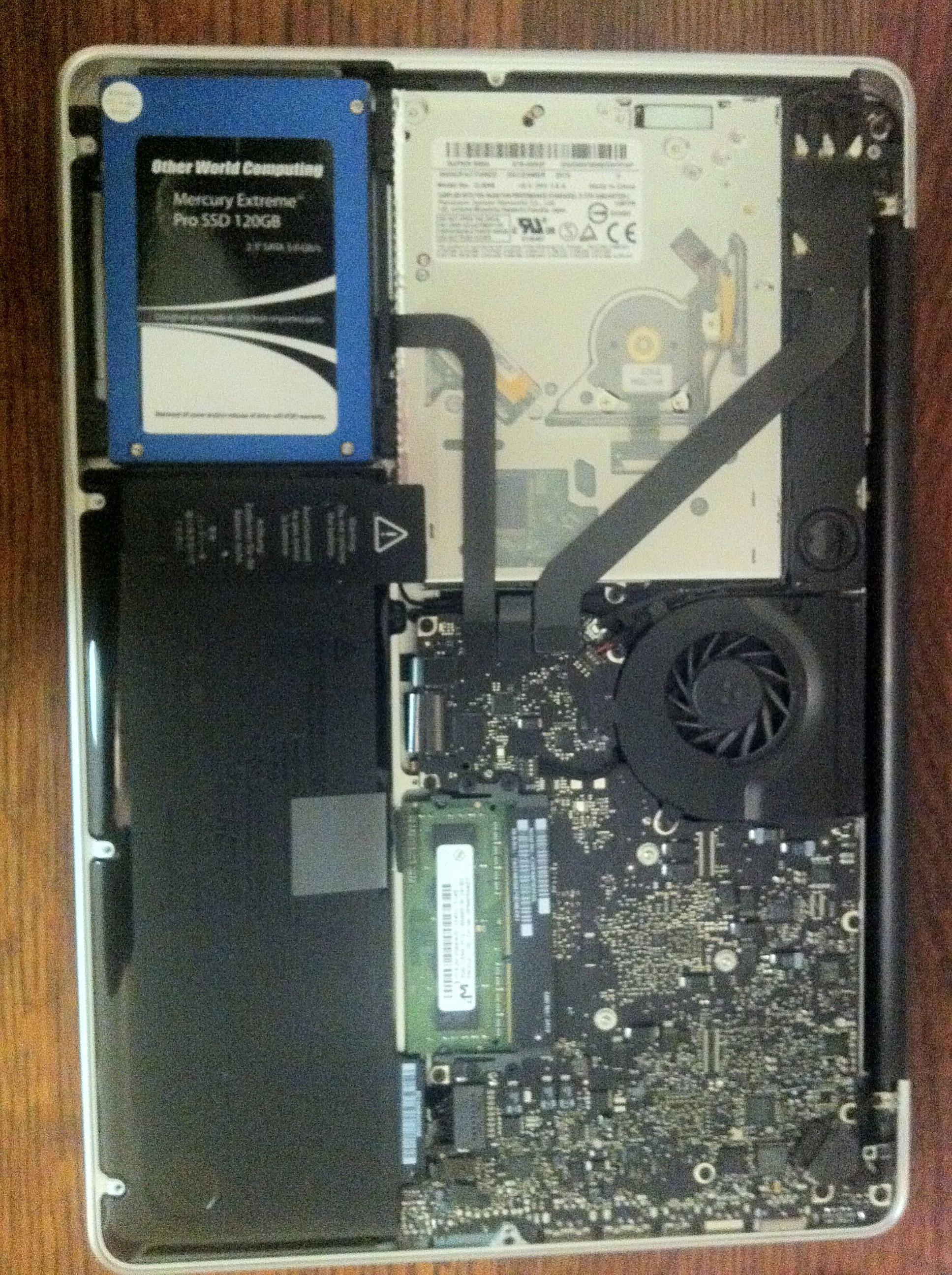

Okay, back. See the attached picture. This is my 13" MBP. I believe the 15" and 17" have two fans instead of one. Please note you are seeing the bottom side of the MBP, please also note all the gaps around the different components. From the back, the bottom side is separate and appears to be airtight from the top.
It appears that the fan is used to create a negative air space in the bottom side of the motherboard and the rest of the components. By removing the cover you are potentially changing the focus of that negative air space. That means you are taking air flow out of design specs and potentially creating hotspots across different components.
Yes you might lower your CPU spec 10c, but what good does that do you if you now have created a dead air zone around your battery, and it's not moving nearly enough air past it?
This is all conjecture. I am merely guessing, but you know what. Apple didn't guess. They probably had a team of engineers who worked solely on just airflow.

The MBP uses the entire chassis (it's made of aluminum, remember?) to act as a heatsink for the components that heat up. By taking the bottom plate off, you're reducing heat on the chassis, but you're also effectively making the heatsink smaller, prompting (at least theoretically) more problems with the CPU itself overheating.
Contradiction bolded.
In any case, the point I was trying to make is ... Laptop will run cooler with the cover off, something you have acknowledged.
Now, about all this dead space nonsense ... What does it matter at all? You've got a lot more ambient air and so the heat dissipated by the heat sink and fan doesn't just circulate within the unibody enclosure searching for an exit. In other words, with the cover off, the hot air dissipated by the heat sink exits the system much quicker than with the cover on.
In any event, I think we all know that the current design is good enough. After all, like you said Apple's design team has thought about it already, this argument started when a couple of pseudo intellectuals called OP silly for stating the obvious. I'm just saying that OP's claims are in fact accurate.
All I can think of when I look at this picture is just how much space that optical drive takes up... 🙁

I said might, not that I actually know. However I am taking what do know and applying it. The thing is you don't know either, but the team at Apple who worked on this does know and I'm sure they took all of this into the equation. Just give it up. You are in way over your head
In order to maximize airflow while maintaining portability, you could buy another bottom plate, and drill a pattern of small holes under the centers of the fans. Actually, they're not really fans, they're radial blowers. The heat from the CPU and GPU is conducted away by heat pipes to finned radiators at the rear of the chassis where the blowers cool them and exhaust the heated air from the case. Openings under the blowers will allow the blowers to operate more efficiently with increased cooling airflow through the radiators, resulting in lower CPU and GPU temps.
