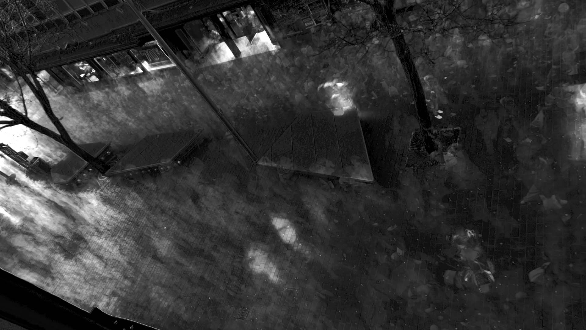

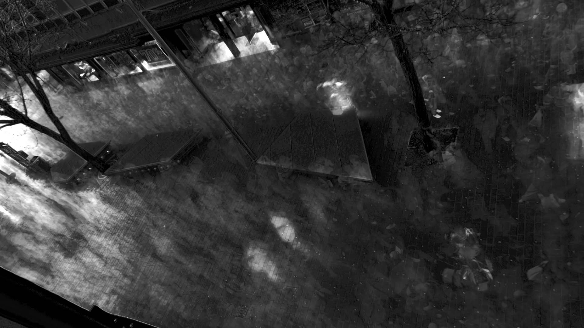

ok long exposures won't work, I've taken another look at some tests I've done and it would have to be extremely busy for it to work properly, thanks for the help.
I've done a test with a HD video, converted the video frames to layers in photoshop, made them all a single smart object, used the stack mode - "Variance" and also "standard deviation", these give very similar results but variance has more depth to the intensity of people.
Heres what I'm working on for tests. With more layers this should suffice, this was 160 layers. photoshop has a limit of 8000 layers but will most likely crash above 800 so I will try it will 800 layers from a 30 minute video on a high end mac pro and see what it does 🙂 I'll probably use 16 bit mode.
I will then reduce the number of colours using either gif format or posterizing (probably noise reduce or blur the image before this though so its a bit smoother).
These colours in the image will then be used as gradient lines, then converted to vectors in illustrator, then imported to 3d software and processed as contour lines to produce a 3d shape, I'll then use smoothing and nurbs smoothing in 3ds max to create a nice smooth model and work from there. Will see how it goes!
