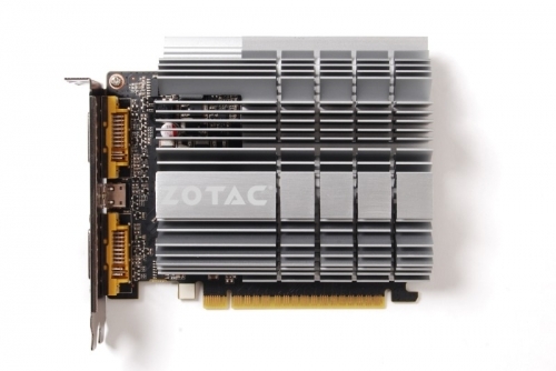

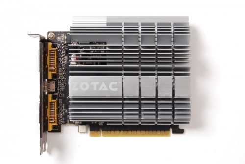

If you are worried about fan noise, get a passively cooled GT 630...
GT 630 ZONE Edition | ZOTAC
