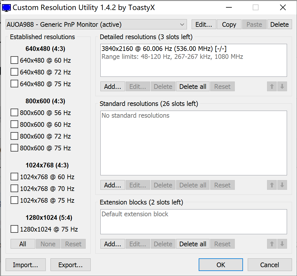

Check the EDID with CRU. Does it include the 6K option? CRU only supports a couple extension blocks because they say Nvidia only supports a couple extension blocks. Maybe the 6K option is in a later extension block that is ignored? Then the solution would be to rearrange the extension blocks so 6K is in an earlier extension block.
Here I'm attaching the screenshot from the CRU, and I think the first one is XDR, with the second one the internal screen of the PC laptop. From the screenshot, the extensikon blocks are empty. I didn't record the status when the 6K resolution was available in March, so I don't know what has changed. What should I do now?
Add a DisplayID extension block with the 6K timings.

Create it manually with the CRU ui. Use the numbers from the edid-decode output.

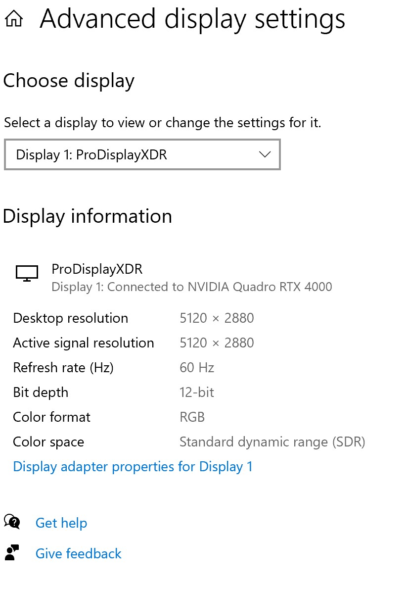

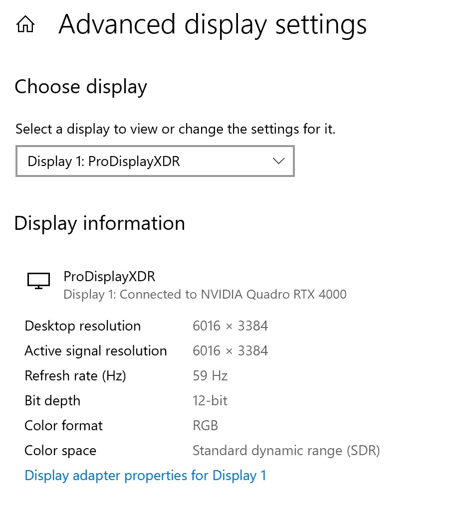

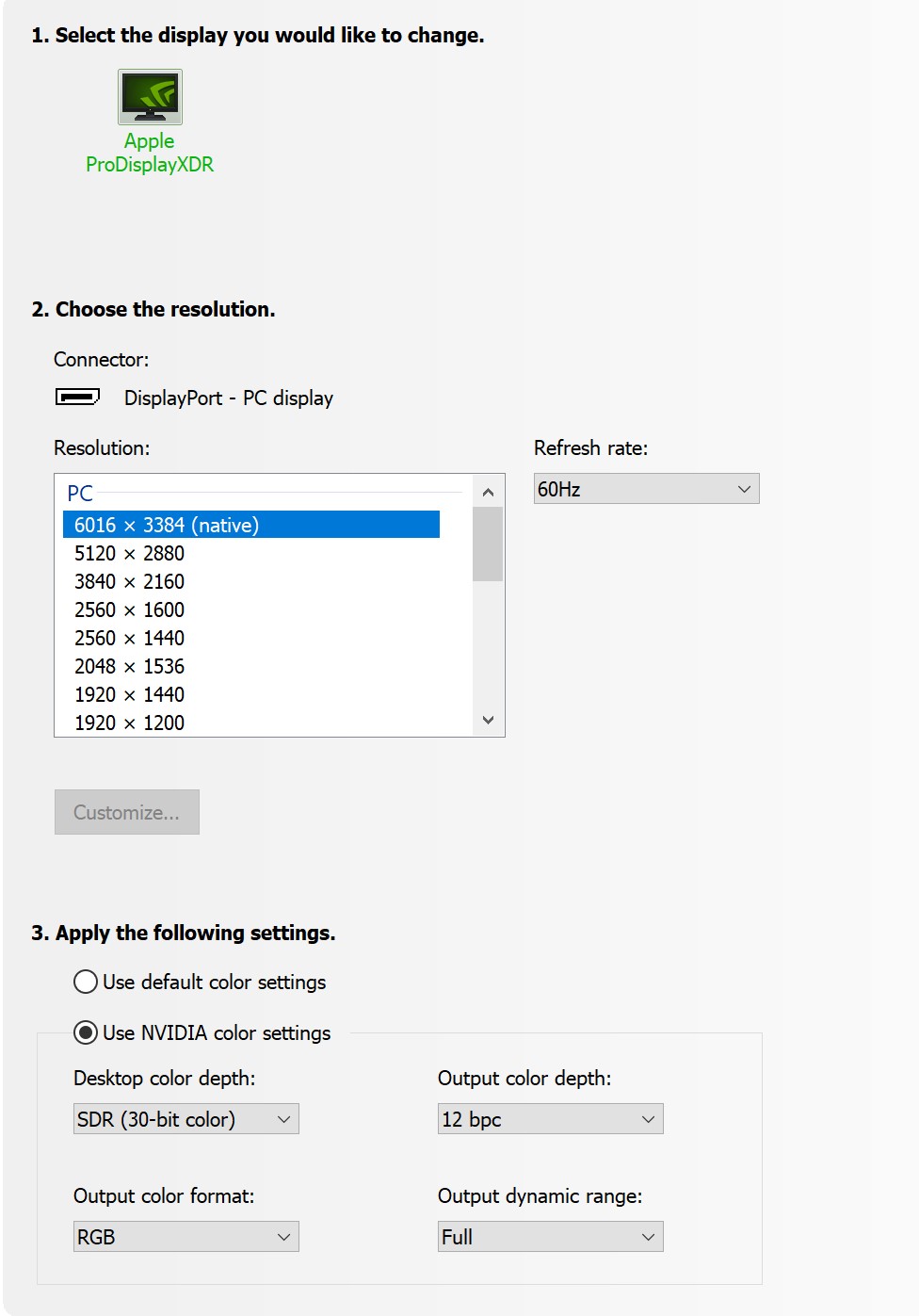

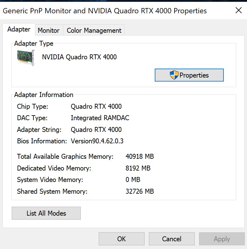

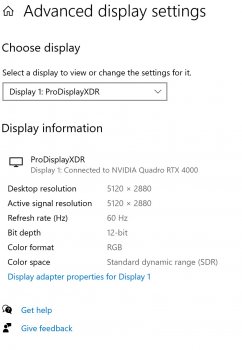

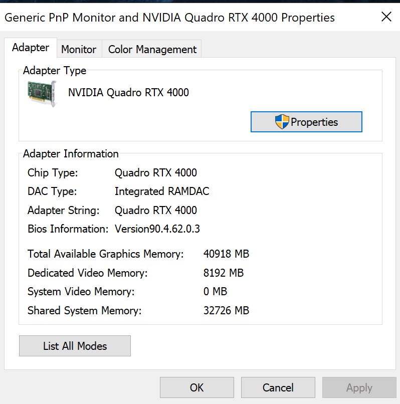

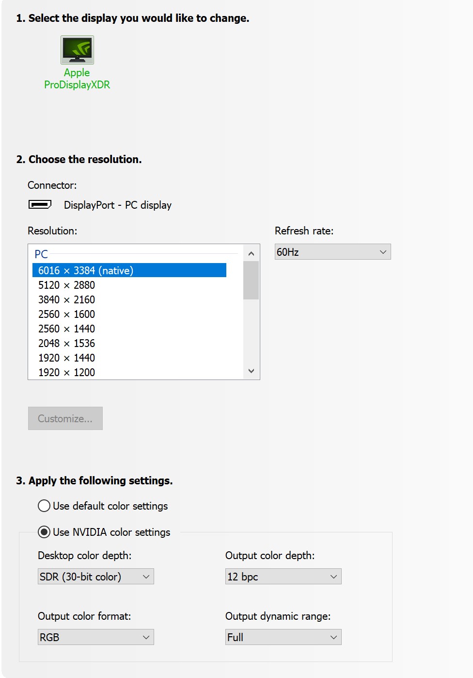

I am trying to use my XDR Pro Display on a Windows 10 PC with Gigabyte Titan Ridge Rev 2.0 and Quadro RTX 4000 GPU.

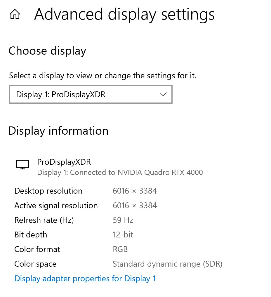

When i connect the XDR to the Quadro RTX 4000 directly using the "Moshi USB-C to Displayport" cable, i get the 6k resolution. But of course, no USB hub functionality of the XDR.

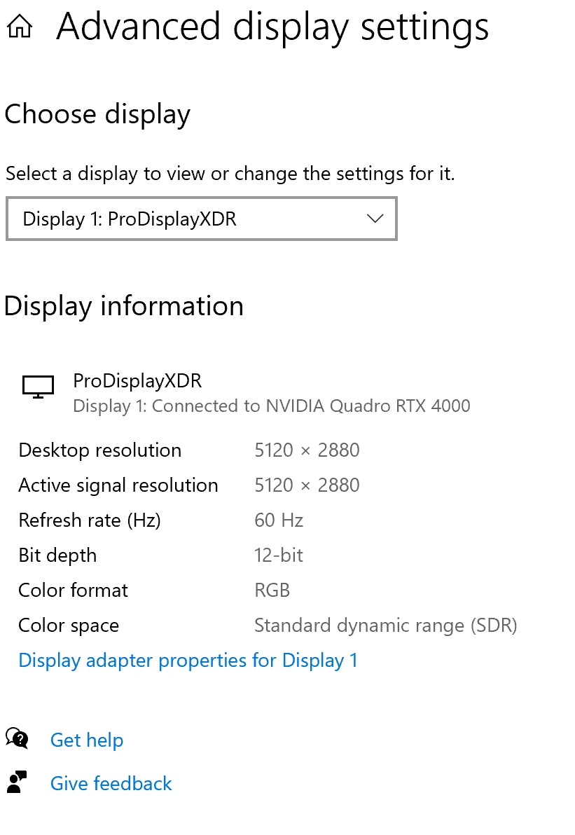

When i connect a "displayport to mini-displayport" cable (the one that came with titan ridge) from the Quadro RTX 4000 to the Titan ridge MDP1, and then connect the XDR to the Titan Ridge thunderbolt USB-C port 1 using the Thunderbolt cable that came with the XDR, i get only 5k resolution. The good news is that i DO get USB-C functionality of the XDR's USB hub.

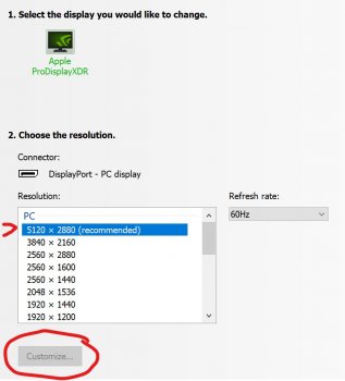

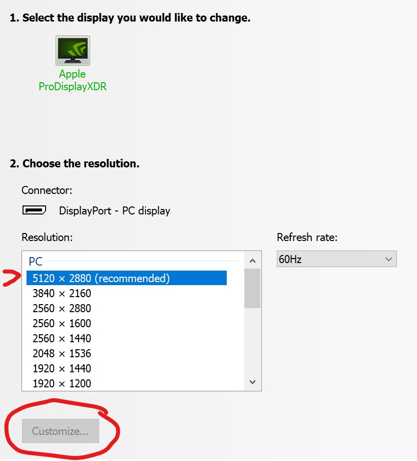

Sadly, the NVIDIA control panel has the custom resolution button greyed out, so i was unable to try to add 6k manually.
I have attached some screenshots of the relevant settings for both cases. Anyone has some ideas what i could try to get the full 6k via thunderbolt?

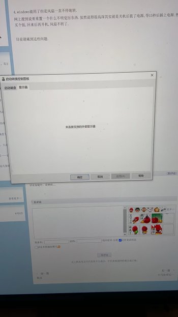

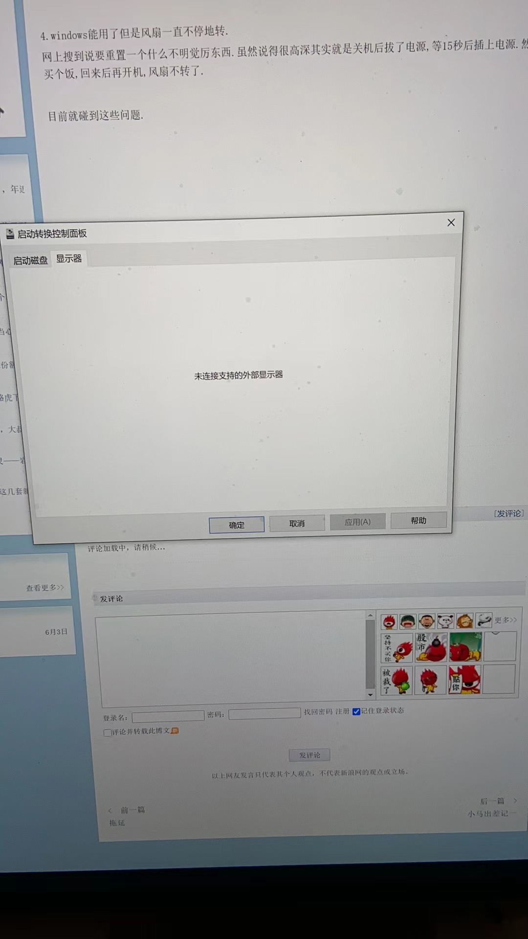

Why is my monitor not recognizing
How is the display connected? What is it connected to? Do you have it connected with USB?
I use the motherboard with Thunderbolt 4 to connect to the monitor directly, my cpu model is 11700K, I am using a nuclear display now, but bootcamp can not detect my monitor, I am very distressed
I guess the pro display xdr does not have the ddc/ci function, because if I use another host with a 3060ti graphics card to connect, the brightness can be adjusted. I don't know if this is the reason.
Forgot to mention that I used the included Thunderbolt 3 data cable,Connected to Gigabyte z590 motherboard with Thunderbolt 4 interface.
