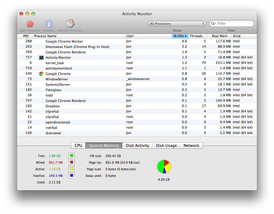

I have a late 2010 11" MBA (1.6 C2D, 4GB, 128GB). I installed ML yesterday when it came out. I actually did a clean install by making a USB boot disk. Since upgrading, I've noticed the battery life is extremely poor. It's losing about 1-2% every minute with nothing running other than Chrome. As I've been typing this message, it's gone from 87% to 84%. Activity monitor shows 97% idle. Has anyone else been experiencing this? I'm about to do another clean install to see if it fixes it since at this rate, the battery won't even last an hour. For reference, with Lion, I could get between 4 and 6 hours with web use.
Now at 82%.
Now at 82%.
  1. Launch Activity Monitor
  2. Change "My Processes" at the top to "All Processes"
  3. Click on the CPU column heading once or twice, so the arrow points downward (highest values on top).
  4. Click on the System Memory tab at the bottom.
  5. Take a screen shot of the entire Activity Monitor window, then scroll down to see the rest of the list, take another screen shot
  6. Post your screenshots.

Forgot about the SMC reset-thanks for the reminder. Will give that a try too.
How is Activity Monitor showing 97% idle when your very own screenshot shows Chrome alone using almost 8% CPU while idle? Chrome uses a lot of CPU, and don't underestimate the affect the flash plugin uses, even on simple banner ads.
Do you have ANY accessories? Maybe disable them all and wait for a whole to see if it solves the problem.
Start by unplugging all things USB, and turn off WiFi and Bluetooth. Restart. Does the power consumption problem remain? This may help you narrow down the cause.
It fluxuates. When I was typing, it showed Chrome using ~1% CPU. I guess it went up a bit when I was taking the screenshot.
