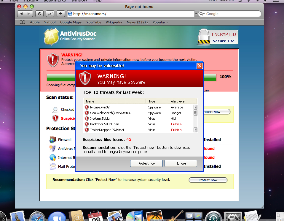

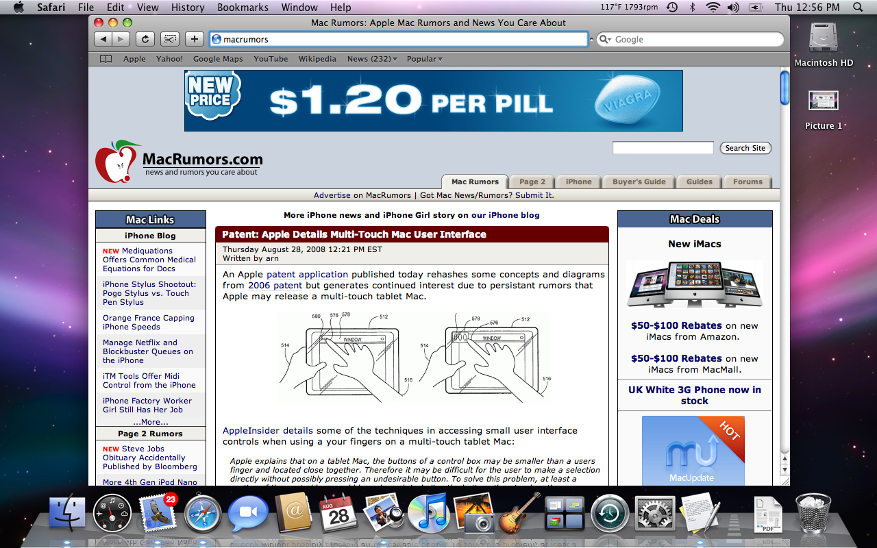

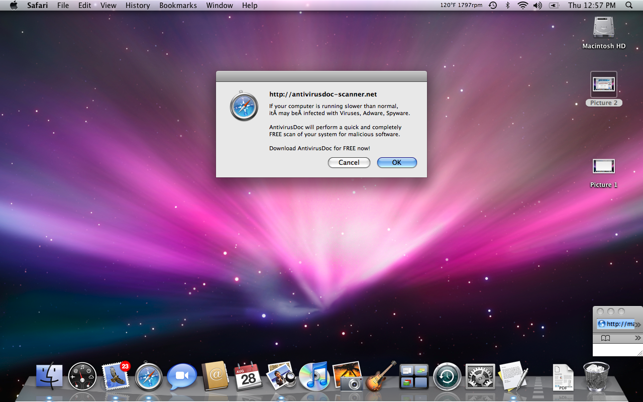

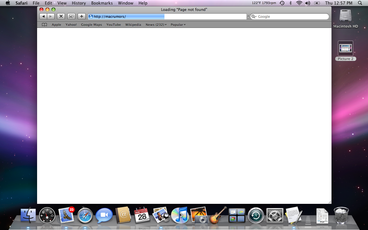

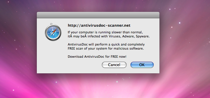

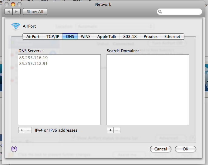

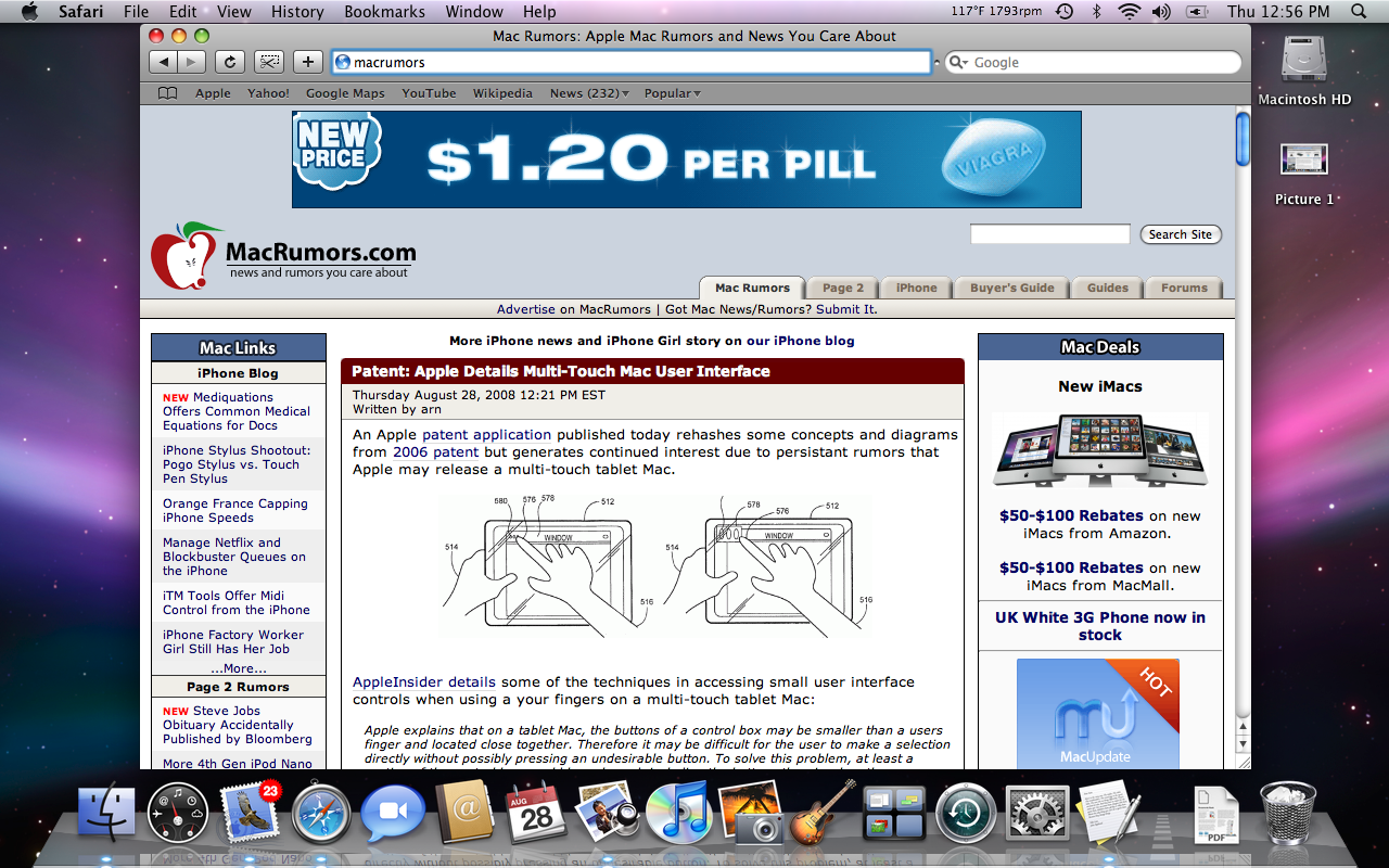

Ok, I know its not a virus but it is really weird. Whenever I open safari it takes me to my homepage just like normal. I can go to any website except for macrumers. The only way I can get to macrumers is if I type in www.macrumors.com, if I just type macrumors or macrumors.com like I normally do this will pop up and close down safari. This only happens when I type in macrumors.

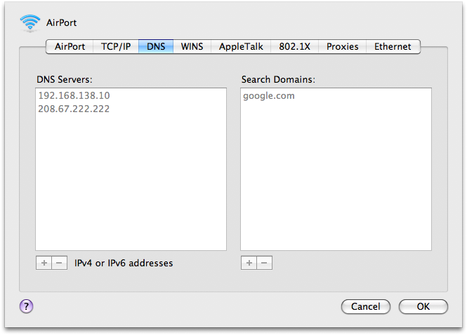

Check you DNS settings ... What are they?
Network preferences > Advanced > DNS tab

When you type 'macrumors' into the address bar, does it change it to 'https://www.macrumors.com/' or just make it 'http://macrumors/' like in your screenshot?
Also, I notice you typed macrumers in your original post. You absolutely sure you are spelling it correctly all the time?
if its a misspelling, safari will present a blank page with a google search box on it. not redirecting to an ads website.
well, your browser wasn't redirected to the website OP posted, was it?
or you have some misunderstanding about how safari's urlbar works?
PS, what you got isn't "re-direct", they are simply "adding www. and .com to whatever you type and try to go there, no any url inquiry involved"
No it wasn't, but that is only three common spelling mistakes of it. Any other typo might get you a website like that.
And it is redirecting since it uses Google's 'I'm Feeling Lucky' - not just adding "www" and ".com".
Do you have a misunderstanding of how Safari's URL bar works?
haha, fine, this is first time I heard safari's urlbar is using google's feeling lucky.
try type mozillazine and press enter, see exactly what is google feeling lucky, and what will safari gives you

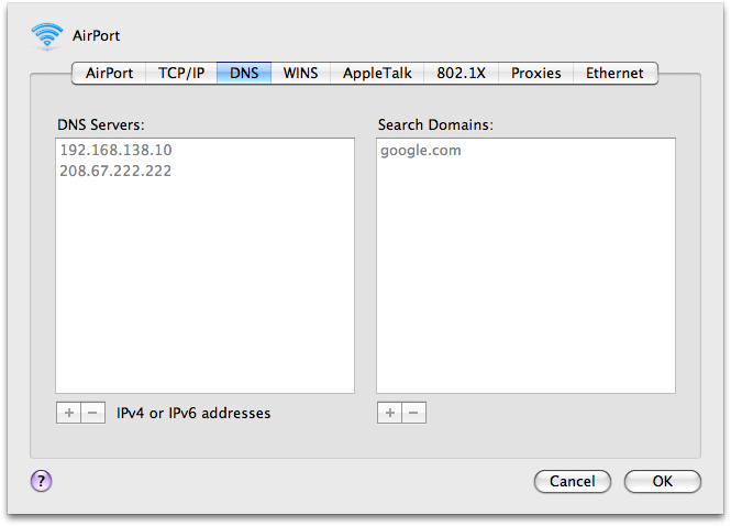

It could be a bad DNS entry at your ISP as others might of said. Try using open DNS at www.opendns.com. Jjust change your dns servers to 208.67.222.222 and 208.67.220.220, which are the open dns servers and see if that fixes the problem. If not, there's a dns issue on your computer.

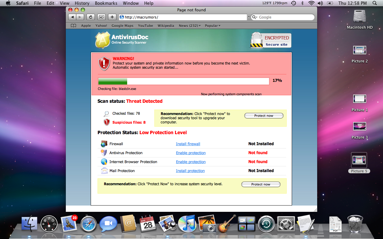

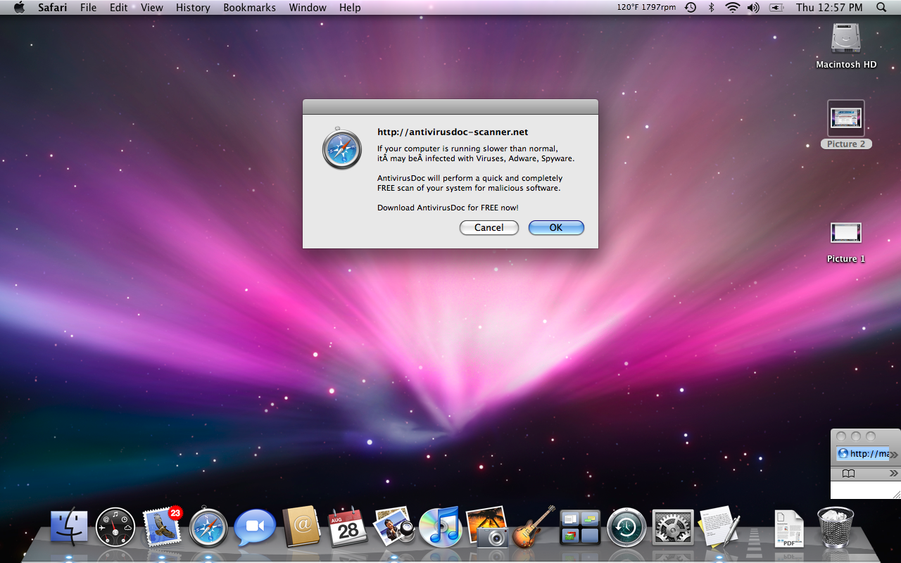

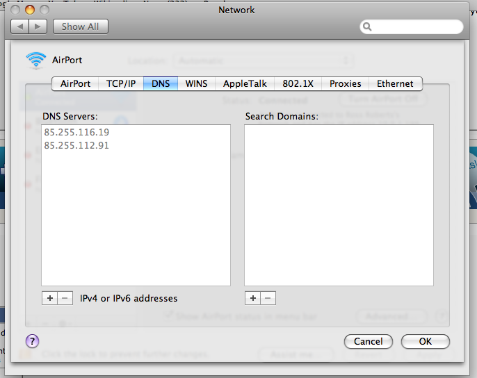

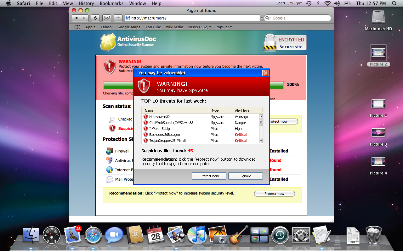

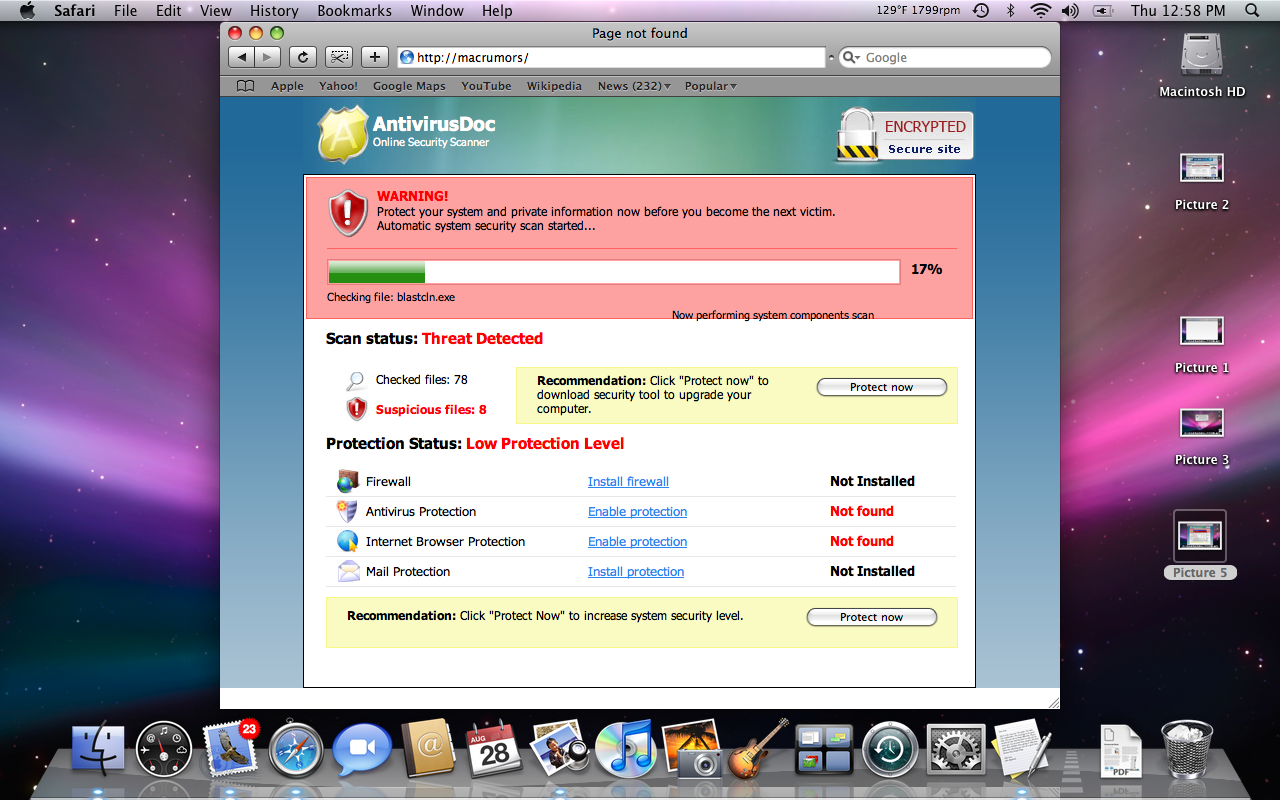

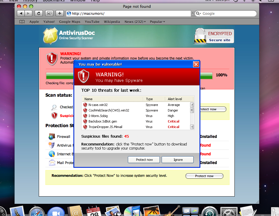

here are some more pictures. If it was from the DNS service wouldn't all of the other computers on the network be affected?
yeah, which means you were probably right about something wrong with your computer, do you remember any weird popups or behavior of safari in previous browsing session since which this problem began to happen?
also, does that page display instantly? or slowly? the reason I ask is that there is possibility that some malicious stuff just replaced your safari's default unable to reach page, in which case, the page should be out instantly since it didn't go through internet after all.
Have you installed any video codecs etc through safari recently as their are a couple of fake internet plugins that are actually trojans and these redirect your browsing.
Sounds like you may have this trojan:
The DNSChanger Trojan Horse, also known as OSX.RSPlug.A and OSX/Puper, has been found on numerous pornographic websites disguising itself as a video codec. Once downloaded and installed, DNSChanger changes the DNS settings on the computer, redirecting websites entered by the user to malicious sites. If personal information is entered on these malicious websites, it can lead to identity theft.
There is a removal tool available from SecureMac.com.
