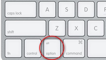

alt 8 doesn't work for me.
Mac: option 8
On the Mac keyboard, alt and option are the same key:
