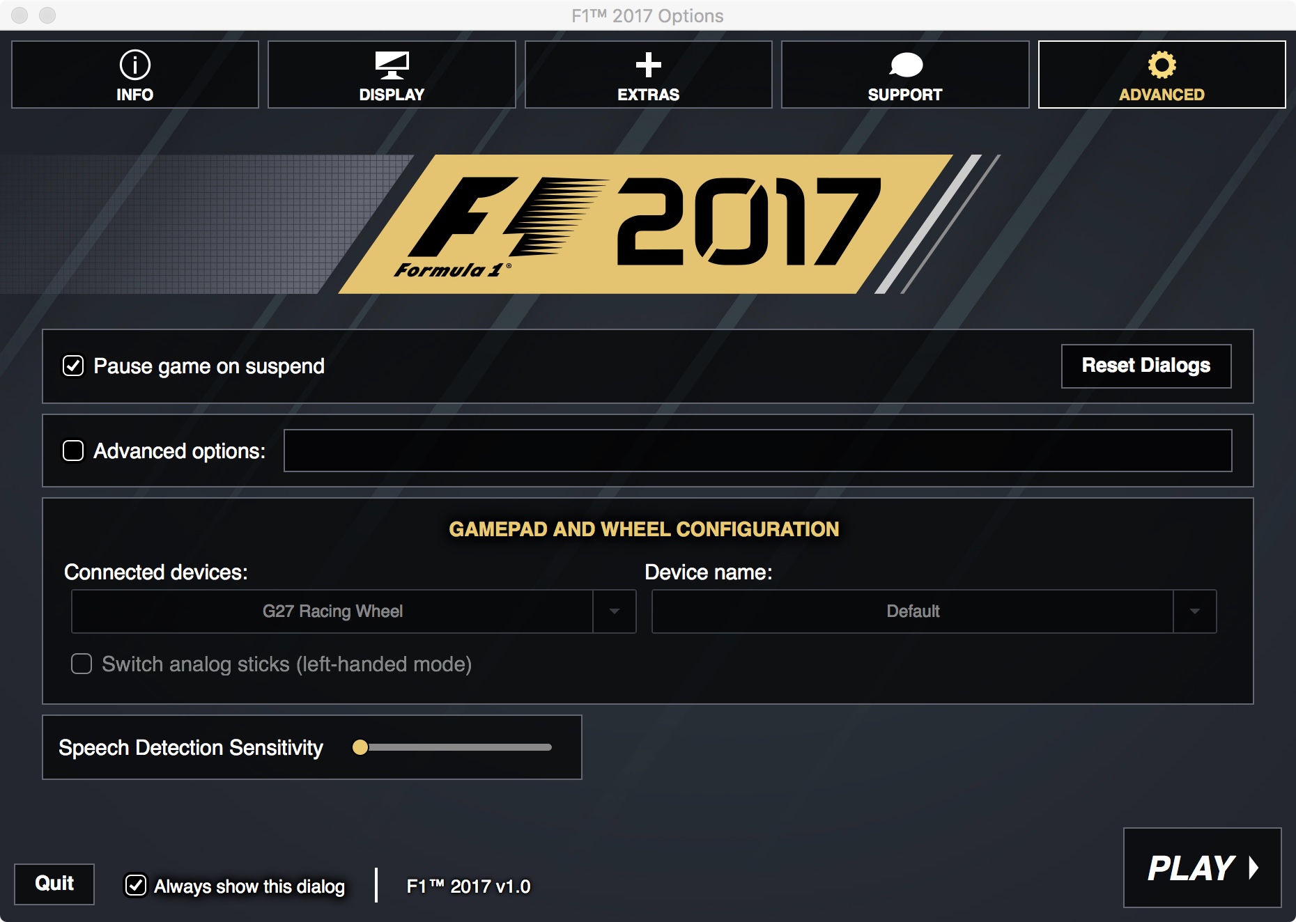

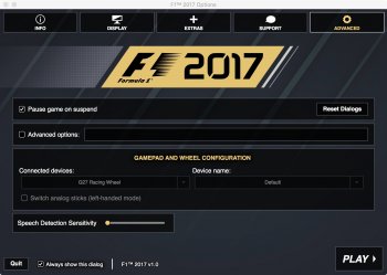

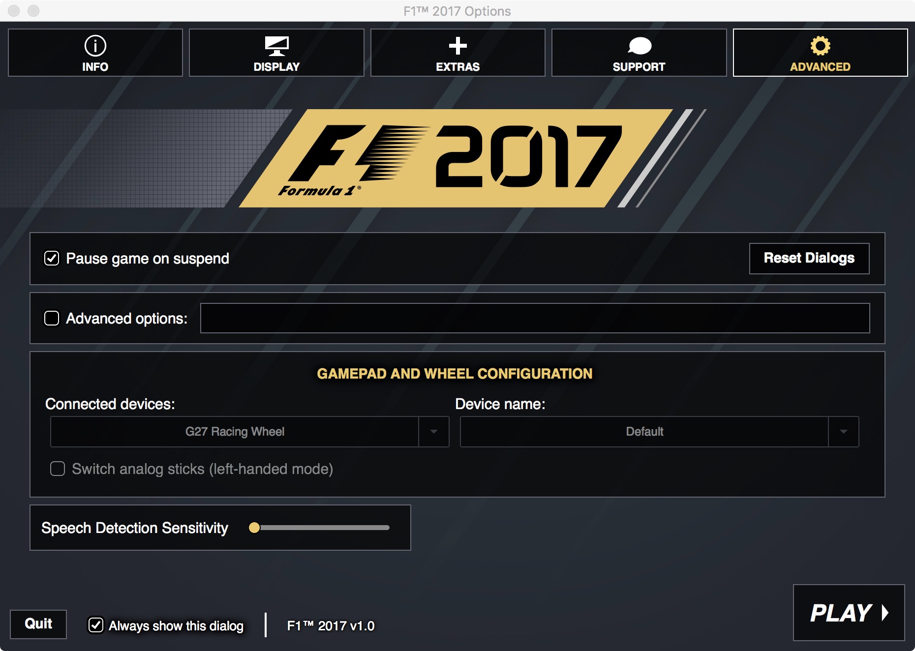

Re your suggestion about scaling the wheel in the advanced tab pre-game options, I can't see that. Screen grab attached.
Edwin, I've worked it out! It's a USB controller conflict.
When I disconnect my Thrustmaster HOTAS Warthog, Thrustmaster Warthog FCS Throttle and Thrustmaster TFRP pedals, then the option you mentioned, i.e. Wheel Operating Range, then shows up in Advanced pre-game options. If any of them are connected at the same time as the G27, the option doesn't show.
If I then set that to 200 degrees, then all is now good in the game!
