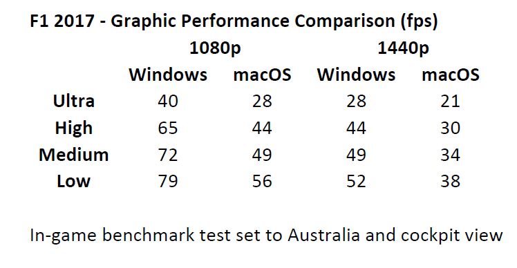

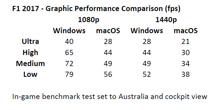

OK, so I've spent a lazy Sunday morning doing quite a few tests on the graphical performance of F1 2017 both on Windows and macOS.
Windows performance was on Bootcamp with latest Crimson 17.7.2 drivers.
See attached graphic for fps obtained from in-game benchmark test set to Australia and cockpt view.
All tests were with AA on. (Switching it off made a consistent 4-5 fps increase across all res and settings, and that isn't enough to consider keeping AA off as it does make quite a difference to graphic quality.)
Firstly, I have got to say a well done to Feral - as usual - for getting this game out on the same day as the Windows version, and for doing a great port.
My conclusion after looking at the results is:
Bad news - macOS and Metal is still some distance behind Windows and DX. One resolution down to be exact in this game. On the same resolution, Windows fps is up to 40% higher than the Mac version. Interestingly, the Mac performance is almost the same @ 1080p at all settings as the Windows version @ 1440p.
Good news - both versions look as good as each other in eye candy terms, which wasn't always the case in the past. In addition, I really can't tell much difference between 1440p and 1080p in visual terms.
Conclusion - I can get a respectable 44fps on my iMac with High settings @ 1080p, and that is good enough for me.
NOTE: Tested on late 2015 27" iMac 4GHz with M395X 4Gb

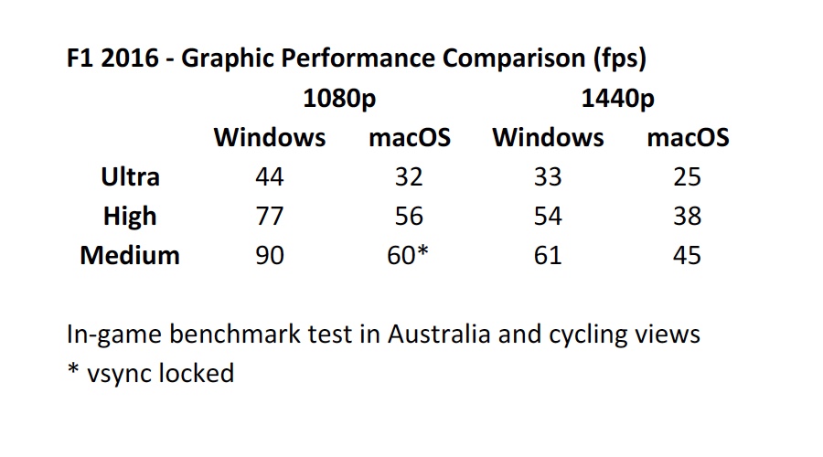

Given that F1 2016 runs faster on macOS than on Windows (at least on the Macs where it's been tested), I expected F1 2017 to do better...

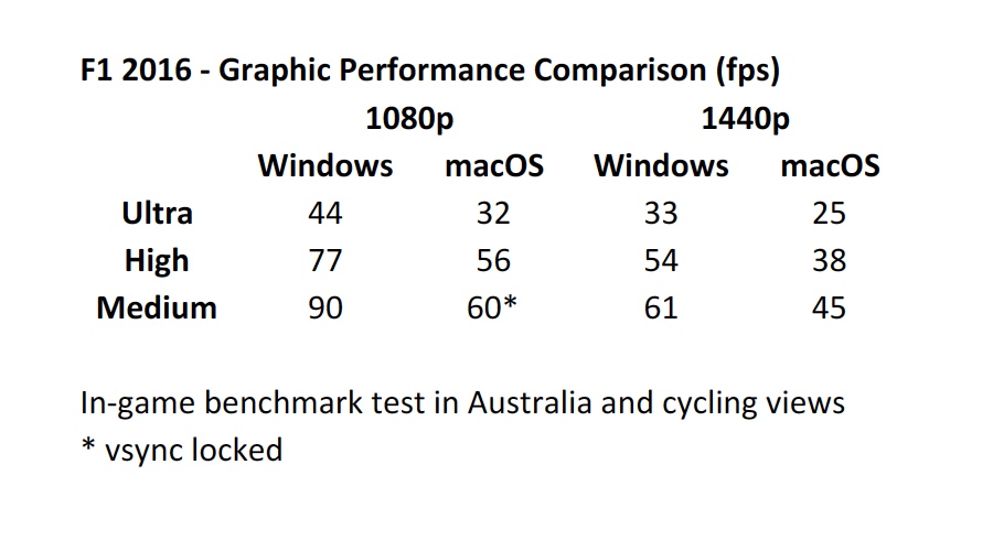

Not sure where you got that from, so I ran the tests on 2016 as well and the results showed the exact same pattern as 2017.
Can't compare the numbers between 2016 and 2017 as it is not possible to select a view in 2016. The game cycles through the various view during the benchmark.
Sure the tests you did were using the latest AMD Crimson drivers on bootcamp and not the poor Apple ones?
