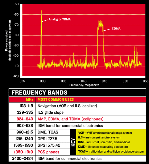

An aircraft cabin can act like a resonating cavity and remember aircraft electrical cable shielding can fray over time and they can behave like antennas. Although devices are FCC certified, they too can be modified by the owner/operator inadvertently. It is a risk that needs careful study.
1464694
Here is a link to an IEEE report from 2006:
Unsafe at Any Airspeed?
The U.S. Federal Aviation Administration is reexamining regulations banning the use of digital devices like the iPad or Amazon Kindle during taxi, takeoff and landing of commercial aircraft. Passengers are banned from using electronics while the aircraft is under 10,000 feet, but pilots and crew are allowed to use their iPads during all phases of flight.
