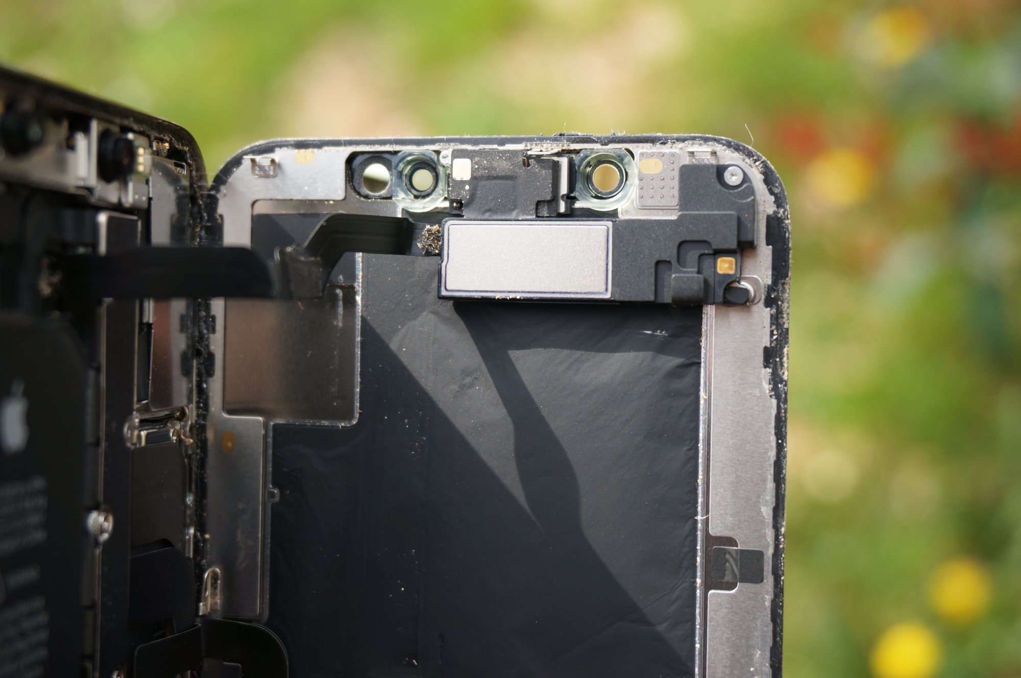

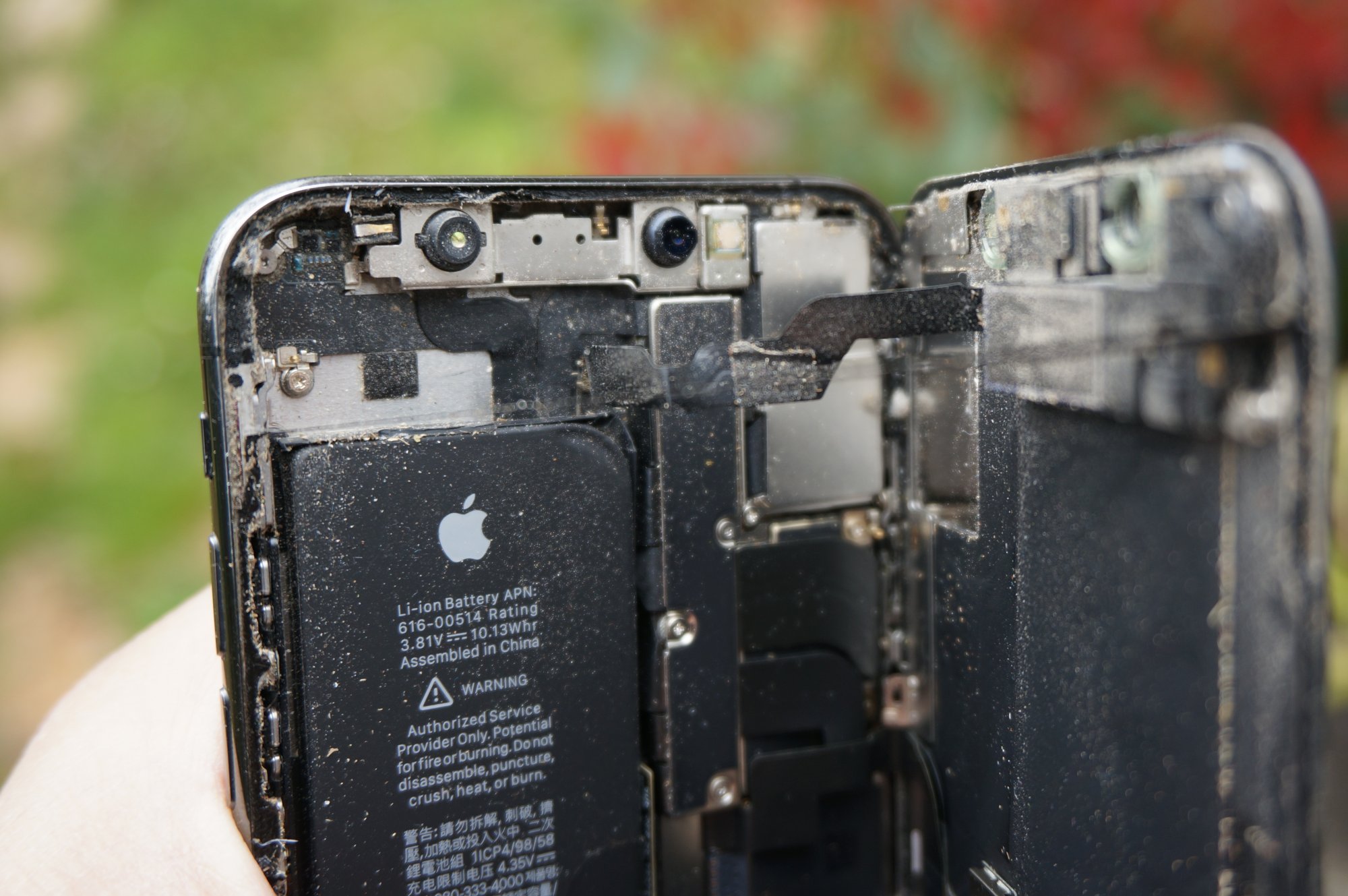

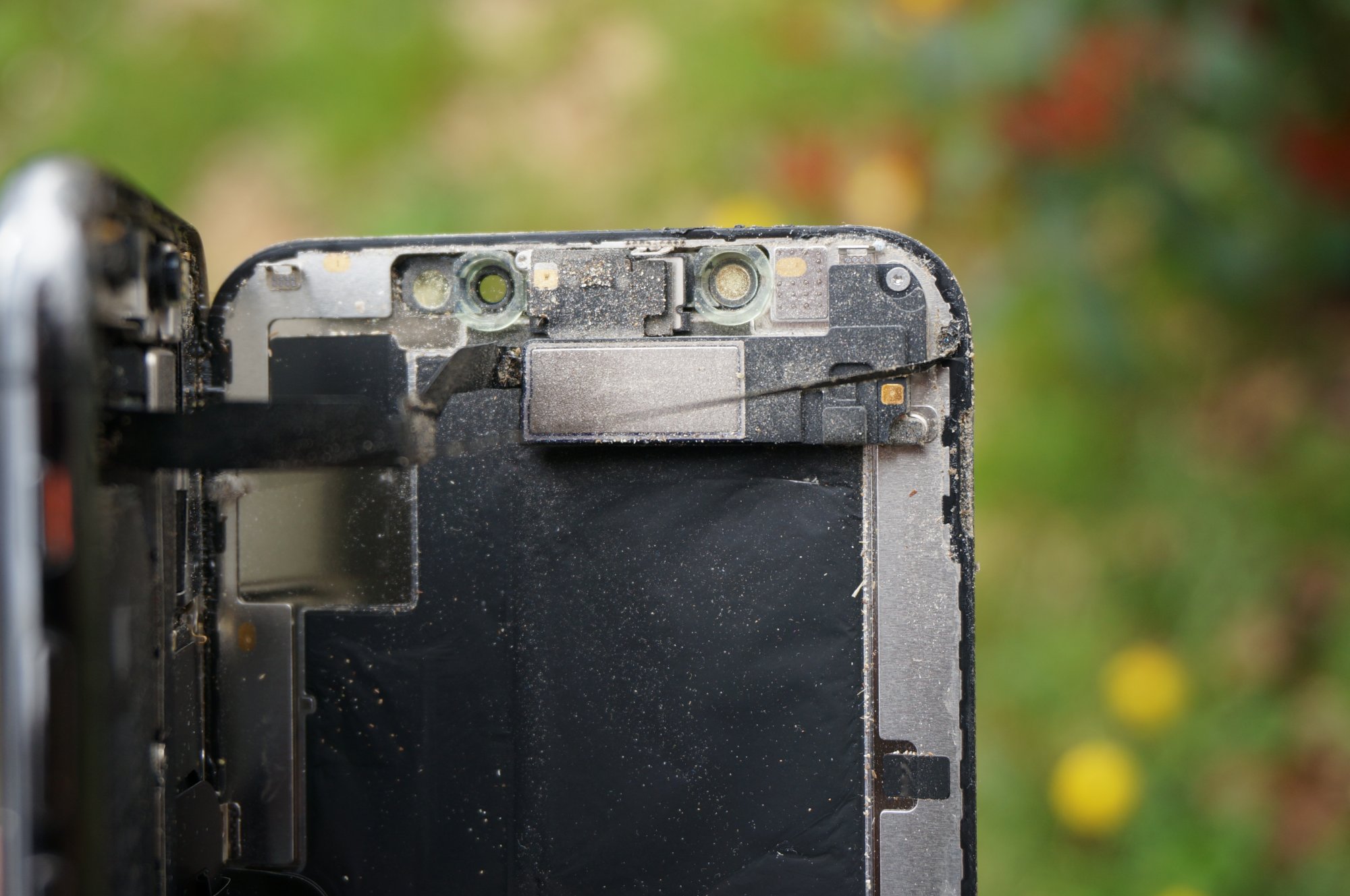

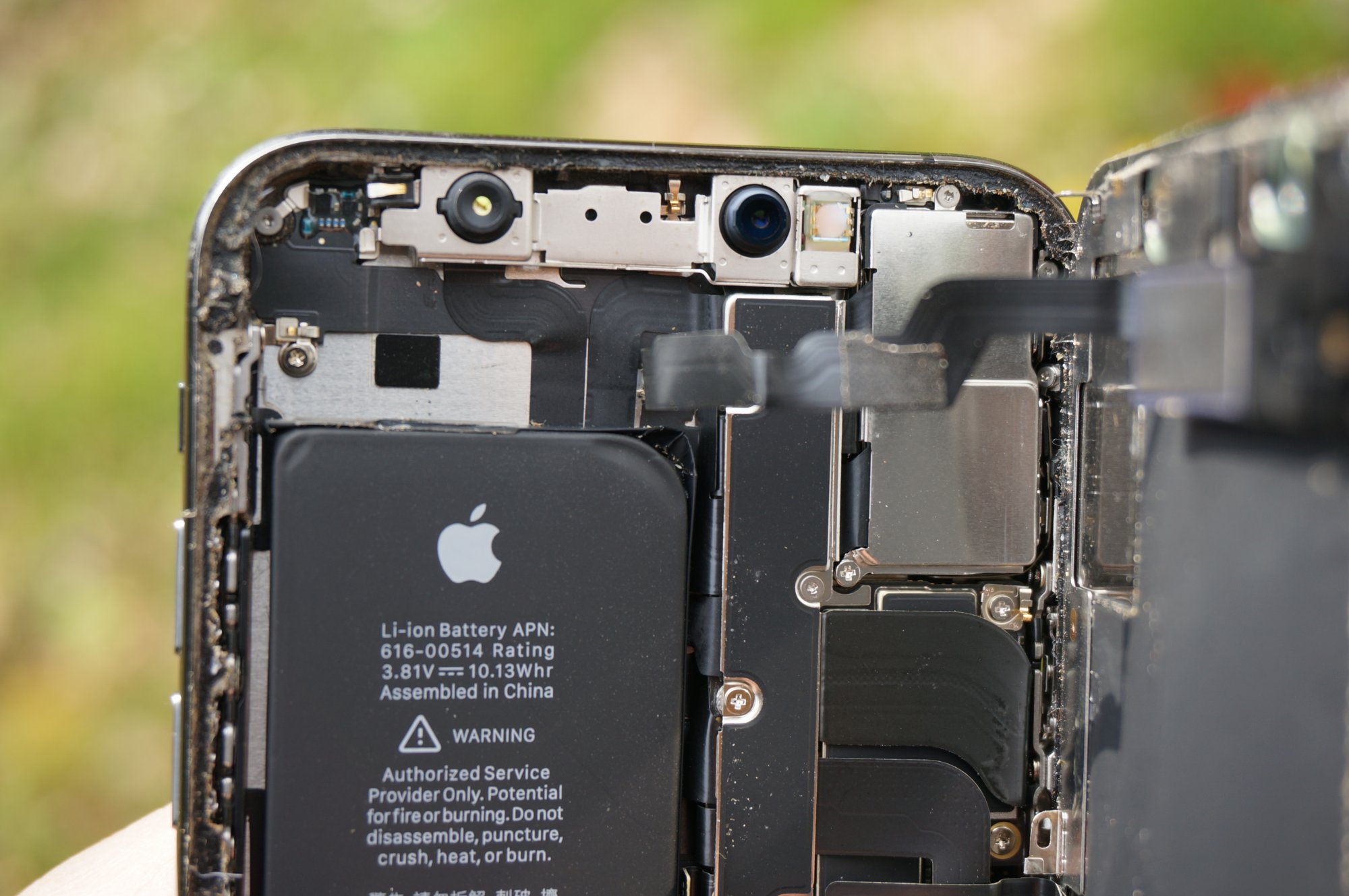

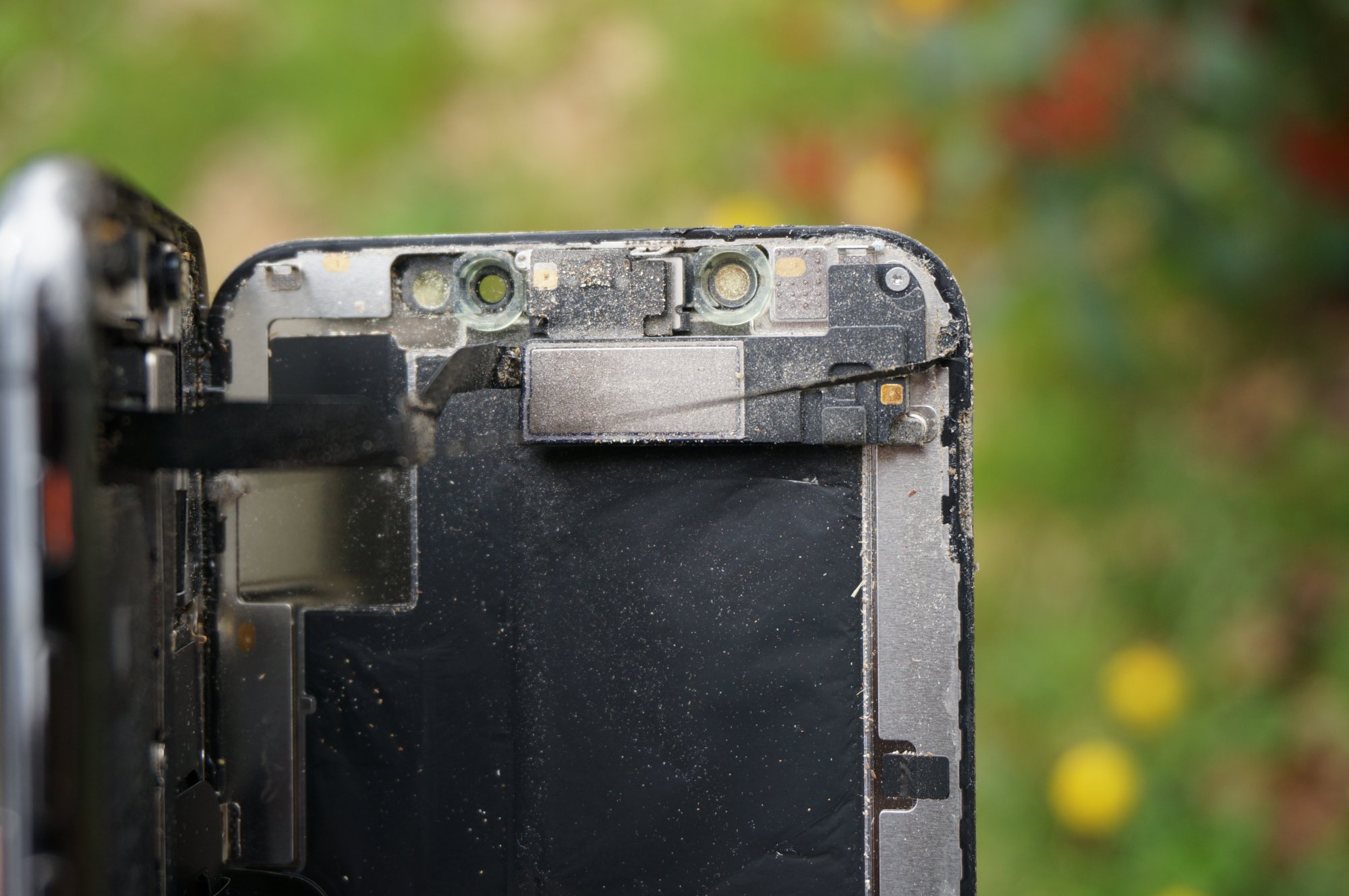

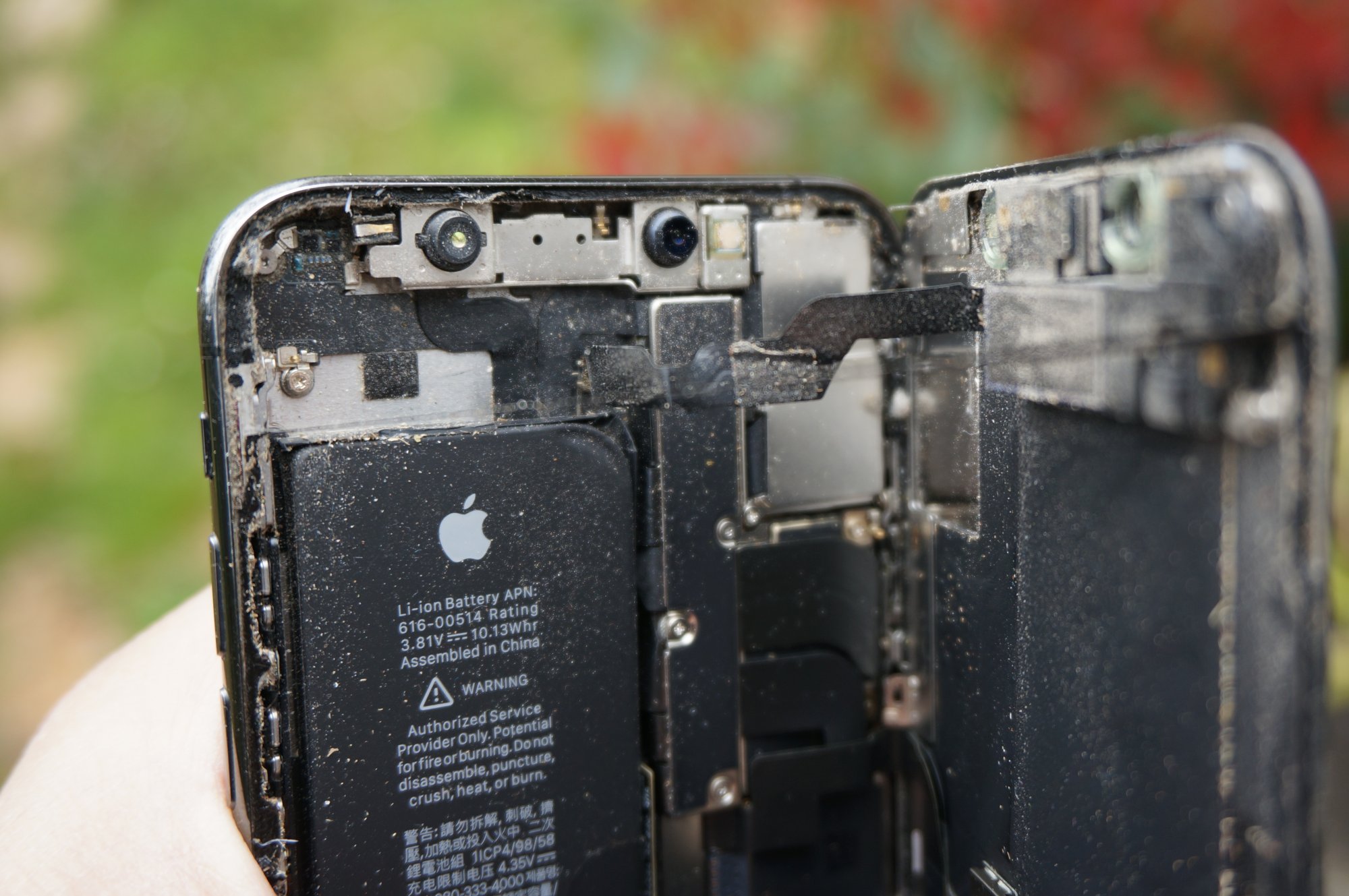

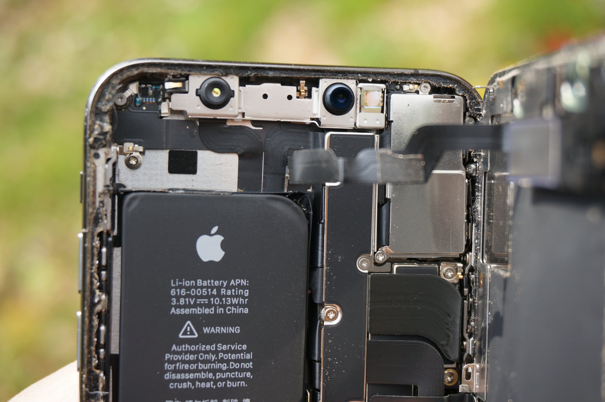

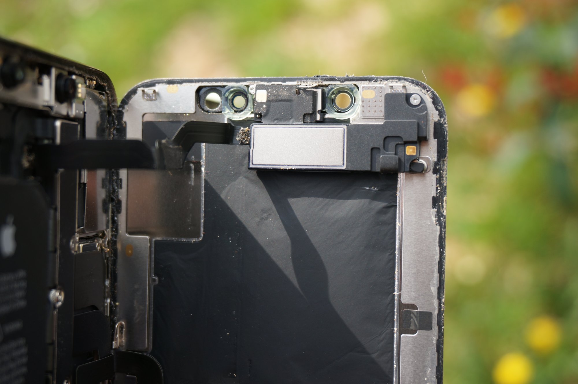

ok so I opened it up today. as you can see on the pictures it was a looooot of dust inside covering all the sensors.
used pressured air to clean it out and voila FaceID works again:)
this is after cleaning. yes water resistance isn't anymore...
It is shamefull that this much dust can get inside a dust/water resistance device.
anyways, I have exactly the same problem, I can see the dust just by looking at it. Faceid works perfect indoor, perfect in shady/dark outdoor setting, and almost impossible to get it to work when outside on a shiny day.
I have a 3 y/o Iphone XS, without any repair history. I’ve just got out of Apple Store 2 mins ago. They said they’d either need to change the screen (around 360€), or change the phone (around 650€). I said, I understand that my device is out of warranty, but it is also apparent that the cause is not misuse, and the seals of the phone failed to keep the dust out, why do I have to pay such a high cost? They said they understand my reasoning but there’s nothing they can do because warranty period is over.
Frustrated as hell.
Thanks for sharing the photos, I think I’ll try the same.
Bro same prblem with me . My phone camera doing great but having some dust particles in it face id works very well at night or in room but in light it doesn’t work please tell me what to do

Try ifixit for opening instructions. And as said air to blow the dust out. Cotton sticks (Q-tip we call them here) can help.
No liquids
