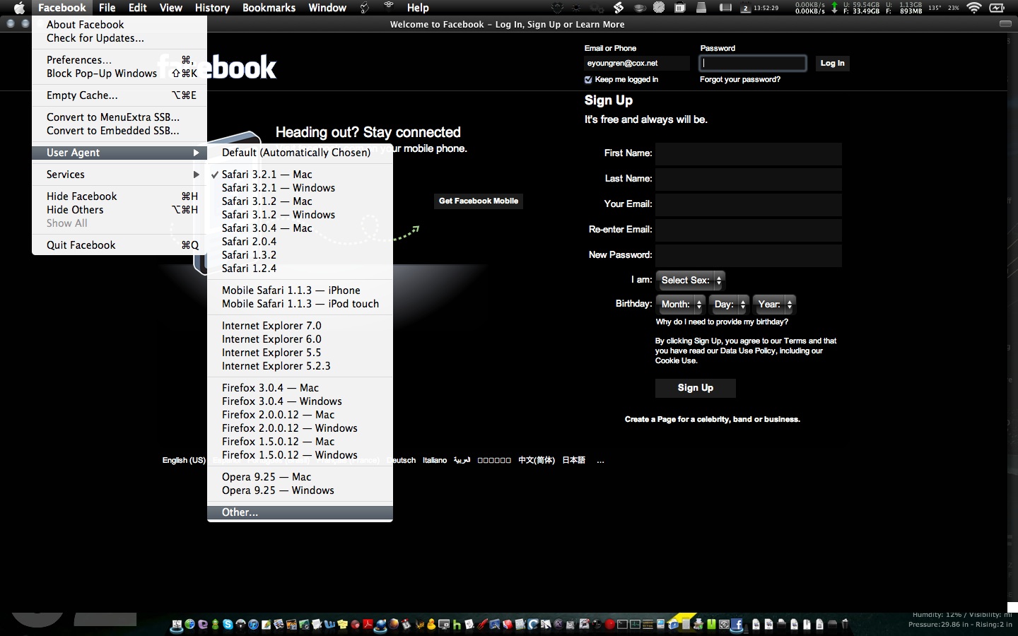

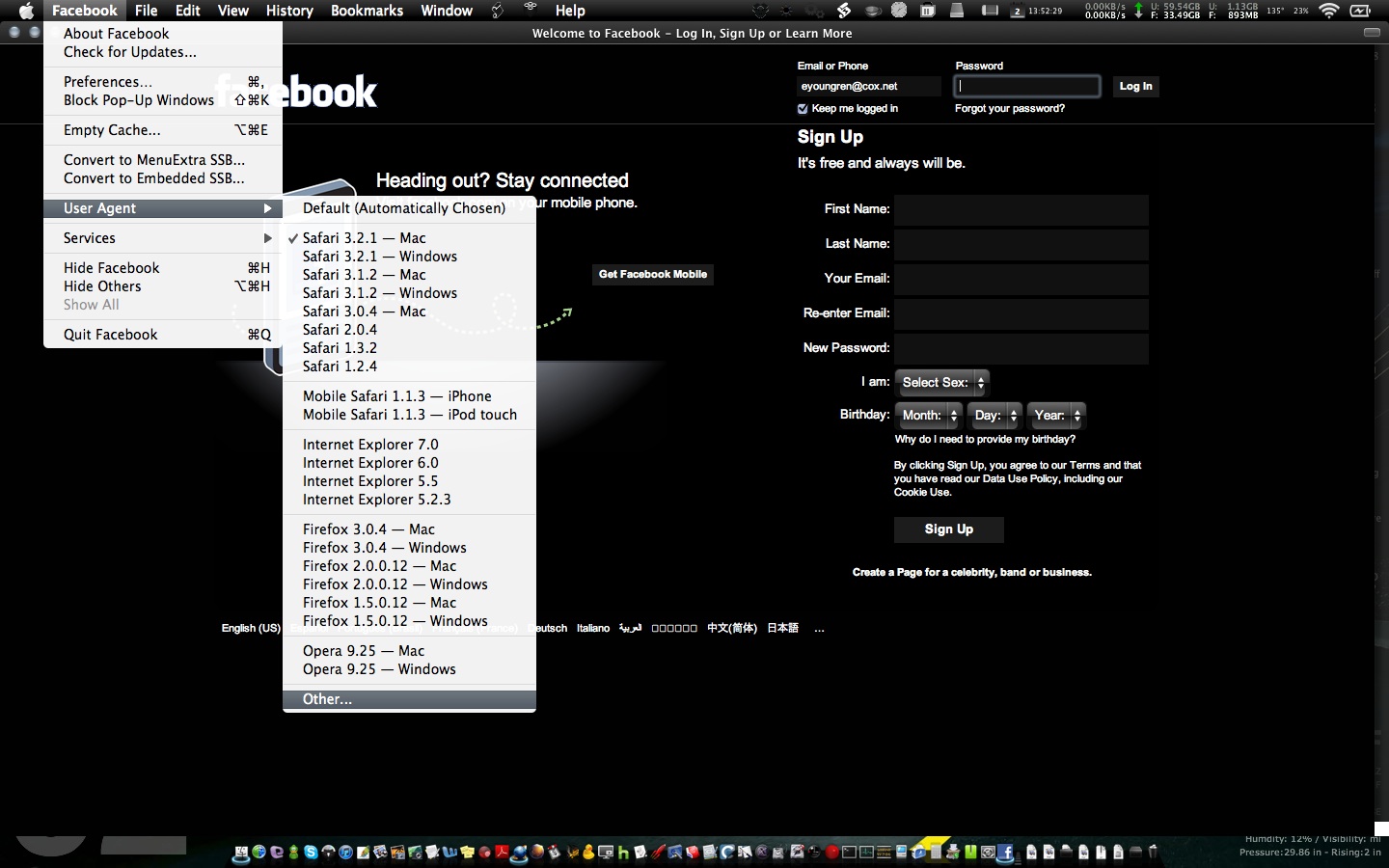

As to the User Agent, it's under Other. See the attached pic. What I did was I used TFF, went to Google and did a search for "What's My User Agent." There are a number of sites that will show the UA string to you. Just go to one, then select the string in it's entirety, copy it and then past that string into the Other box in the Fluid app you have for FB. That's it.
If anyone is wondering why this pic shows a back blackground instead of FB blue and white, this is because I use a userstyle from userstyles.org inside the Fluid app. I'm using it as userscript.js.
