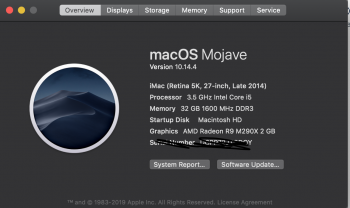

I have a Late 2014 iMac and ever since I upgraded it to Mojave, I haven't been able to use FaceTime it just hangs (Color wheel appears) and iMessage would would work half the time and would the same thing but sometimes it will load up and sometimes it won't.
I tried re-installing the operating system to reinstall the files same problem
I tried erasing hard drive and doing a time machine restore same problem
I tried erasing the hard drive the hard drive and just doing a clean install to see if my hardware is causing this so I loaded up iMessage and FaceTime and they both worked with no problems. So I went into migration system in order to transfer all my files from the backup and I started to have problems all over again?
Please help I don't know what to do?

from yr screenshot, memory is certain sufficient.
