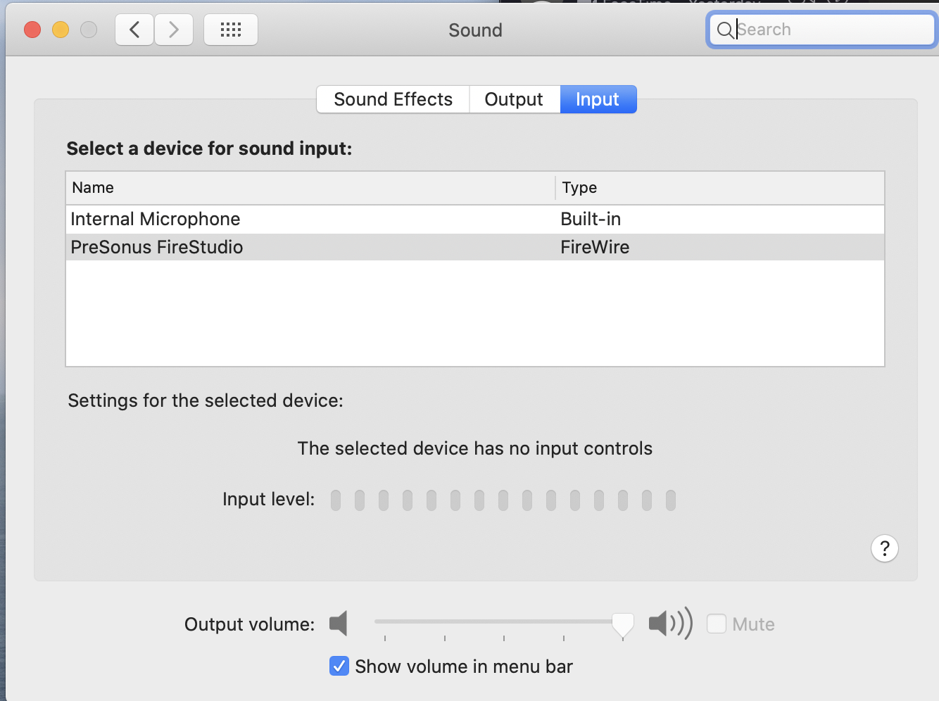

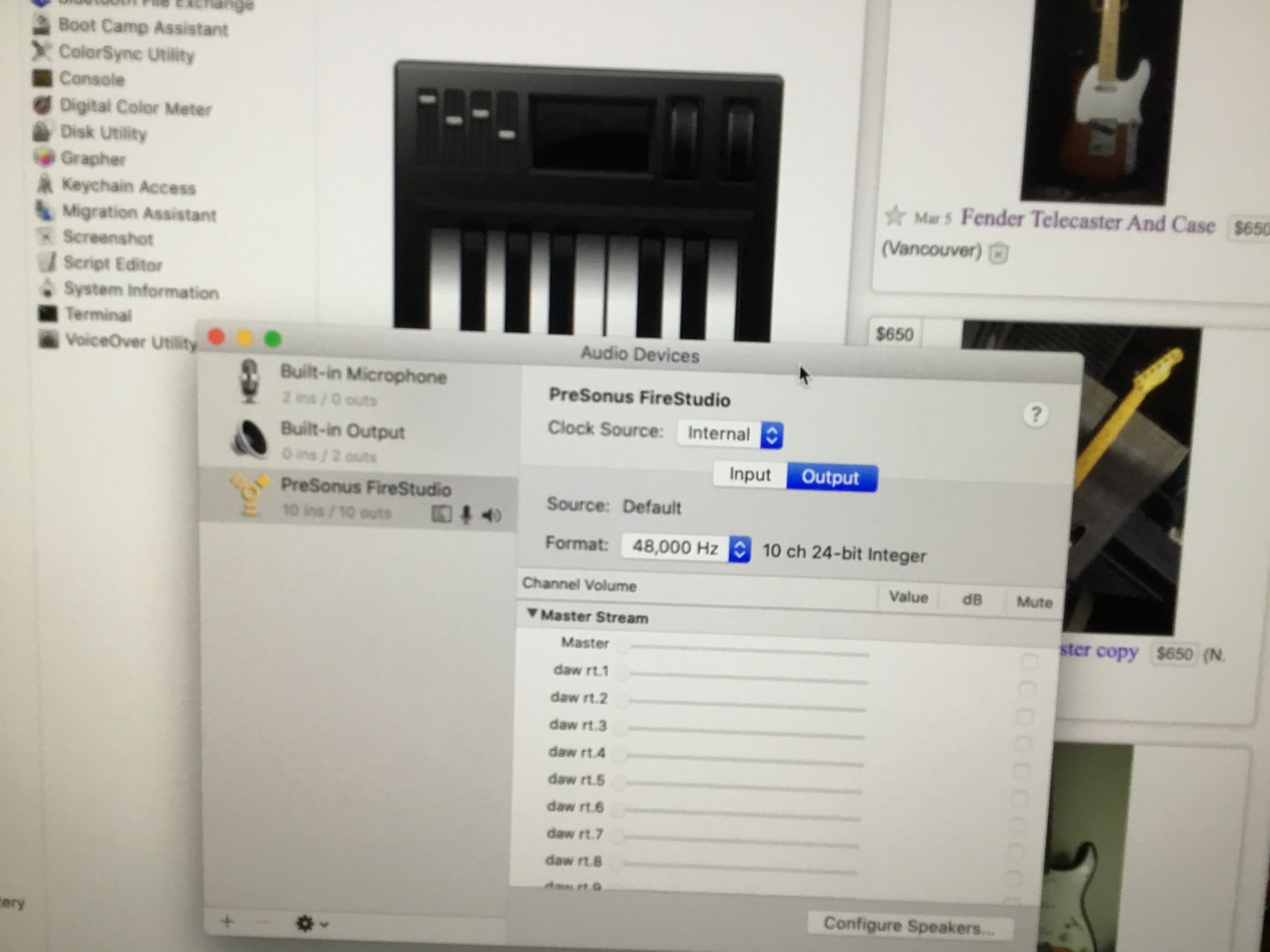

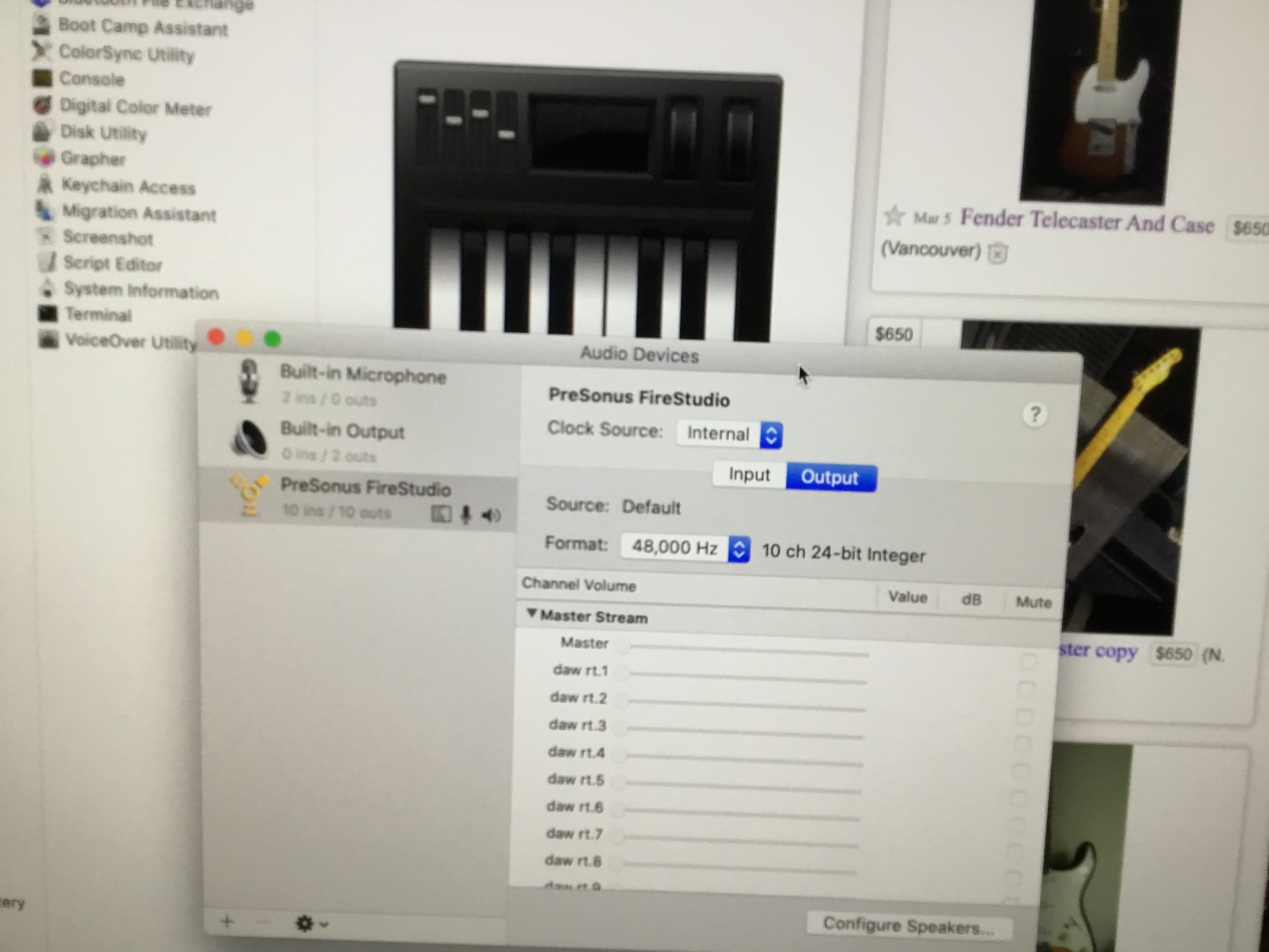

So.... this is what I get . There is no option for me to control volume other than on the interface itself
sorry the image is so crappy, I don’t know how to take a screen shot.

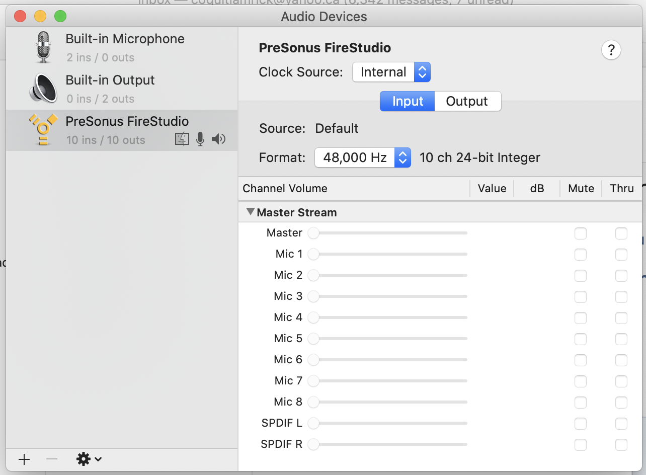

The input settings look exactly like this only instead of DAW 1,2,3 etc. it says mic 1,2,3 and so on. The sliders are all greyed and I have no option to use them. Even when I’m using a DAW like Logic my input volume is greyed out and only controllable via the Presonus, but that works fine and I’m able to record multi track live music. It’s just FaceTime that I have this problem with.

Only thing that comes to mind is that video conferencing apps (like skype) sometimes use the first channel off a multichannel audio interface, and discard the rest.
If you still would like to use this...
Find the YouTube video called: Solved! Using a Multichannel Audio Interface with Skype
This method can be used for anything from Facetime to recording etc.
For Mac you will need Soundflower and LadioCast, but it works great for my online drum lessons.
