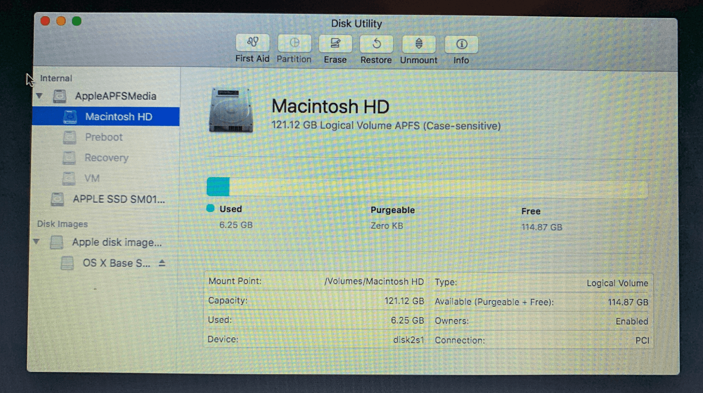

I've just sold my MBA and am trying to factory reset it for the handover, but I'm having problems.
  • erased Mac HD to APFS
  • started reinstalling Mojave but it timed out and failed to complete
  • re-erased Mac HD to APFS
  • started reinstalling Sierra and got the “An error occurred while preparing the installation. Try running this application again.” at the end
  • then had issue with internet recovery mode
  • then had blue "Recovery ... Your PC/Device need to be repaired ..." blue screen error which is odd as I thought this was a Bootcamp issue? I ran Parallels a year ago but that's all
  • Anyway, ended up resetting the time via Terminal and reconnecting wifi ... now I'm faced with multiple drives in Disk Utility - what should I do next as I want to avoid messing anything else up.
BTW, I'd like to get Mojave back on there as that's the OS I was running faultlessly. But the buyer is happy with Sierra etc.
Thanks
Not sure why the Mojave install failed but APFS requires High Sierra or later and is not supported by Sierra. Format the drive HFS+ for Sierra.

I'm going to go with your drive was in the middle of being erased for install when the installer quit, and now the format is a mess.
Not sure what's safe to do at this point. Showing us the results of
diskutil list
in terminal would be helpful since Disk Utility is irrational.
Why is the drive formatted "case sensitive"? With HFS+, that was a no-no. Not sure about APFS, but likely similarly an issue.
I would select the entire drive (AppleAPFSMedia), not a container, and reformat again, being sure it is not "case sensitive". Even safer:
Format it GUID HFS+, and run the installer. It will automatically convert to APFS if required...and correctly. Easy peasey.
Reactions: DeltaMac
I think it's just as plausible that "AppleAPFSMedia" is the container, and "Apple SSD" is the drive itself. That's why diskutil -list results would help clarify the current setup.
Actually, you are correct. I used the wrong word. AppleAPFSMedia is the Container. The three things we used to call partitions are Volumes.
And yes, Apple SSD is the drive.
The main point—to the OP—is that the case sensitive volume may be the issue. Again, I am not sure about APFS, but I would be suspect.

Thanks for the replies guys. I managed to get it sorted and have been crazy busy since hence no response here.
After speaking with another Apple support guy - who didn't entirely know what he was doing - I managed to do another clean erase and finally get Sierra to install. He was also confused about the Windows blue screen 'error' as it didn't make sense for Parallels to be behind that or Bootcamp. He also felt that if the normal methods continued to then a store visit would be the only option 🙁 Anyway, it worked in the end and I did a health check after setting up Sierra for the buyer and it came back all clear.
