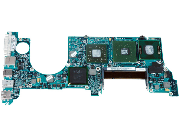

Hi,
I have a MacBook Pro version 2 (Purchased Feb 08). Last week I tried to switch it on and it was as good as dead. The power light came on and the optical drive spun up but no display and no bong.
After a lot of looking round on the internet I saw there are know issues with the NVidea GeForce graphics card on my particular MBP and that Apple have extended the warranty to 3 years for problems of this type. My MBP had been running very hot for some time so I suspected that some piece of hardware may have been failing for a while and thought the graphics card may have been the cause.
After a few calls to Apple UK I took my computer to an approved Apple repairer for them to evaluate (a 60 mile round trip). They came back an said it wasn't the graphics card but the logic board that had failed, and gave me a repair cost of almost 900 GBP.
I spoke to Apple UK support, but they refused a CS code (i.e. a code that would get my computer repaired for free). The repairer suggested I try talking to Apple again again as in their opinion the logic board probably failed due to a manufacturing defect. They liaised with Apple and shared their findings.
To cut a long story short, after many long, frustrating calls to Apple UK's Customer Relations department they decided NOT to make an exception, despite the report from their approved repairer. I also had a second 60 mile round trip to collect my MBP.
I'm now at a bit of a loss, I'm going to follow this up and find out what my rights are under UK Consumer Law as I don't think the computer was fit for purpose as I'd expect it to last longer than 27 months before being rendered useless.
To add insult to injury the Customer Relations adviser said he agreed with me but was overruled by his manager. I don't know if this is true but he also advised me to talk to my local Trading Standards office(!)
I thought Apple stood for quality and good customer service, but I'm struggling to see either right now.

Call them again and demand to speak to the manager/supervisor. It clearly says that:
What to look for:
Distorted or scrambled video on the computer screen
No video on the computer screen (or external display) even though the computer is on
They can't refuse to fix it as the symptoms are 8600M GT related
Not picking sides here or anything but could it not just be a faulty logic board ?? And if so how can you prove it was gpu related?
Because the GPU is soldered onto the motherboard
FO5CPYRpKW5IcEgQ.medium
The symptoms OP has are GPU related as it produces the picture to the screen
He said he tried to switch it on and there was no display and no bong. To me that doesn't single out the GPU with absolute certainty. His machine wouldn't POST is all that means. I'm afraid that if you've already gone through the motions of contacting Apple and they denied an exception there is little you can do.
Well, If your machine isnt even turning on, it has nothing to do with the GPU, sorry
You should get some sort of hardware feedback when the power button is pressed, which is why they are not repairing it.

I had the EXACT same symptoms on a December 2007 MBP 15". Twice, no less. No bong, just heard the optical grind once at boot, no screen, dead. The first time was before Apple had acknowledged the 8600GT issue was cooking the GPU and, in many cases, the logic board along with it. So the first time it happened, they replaced my logic board, got it back and it worked as new.
About 8 months ago, almost 1 year after the first logic board replacement, the same thing happened. Again, they did a logic board replacement although this time the paperwork reflected the GPU failure....it didn't the first time, although the symptoms were identical in both situations, again with no questions asked. Again, working pretty well although I've since replaced that device with a new 2010 MBP. My kids use the old one now.

I have had this happen and revived the machine many times with a proper BGA rework(no heatgun ********) to the GPU. There are different symptoms depending on what is not making a proper connection.
