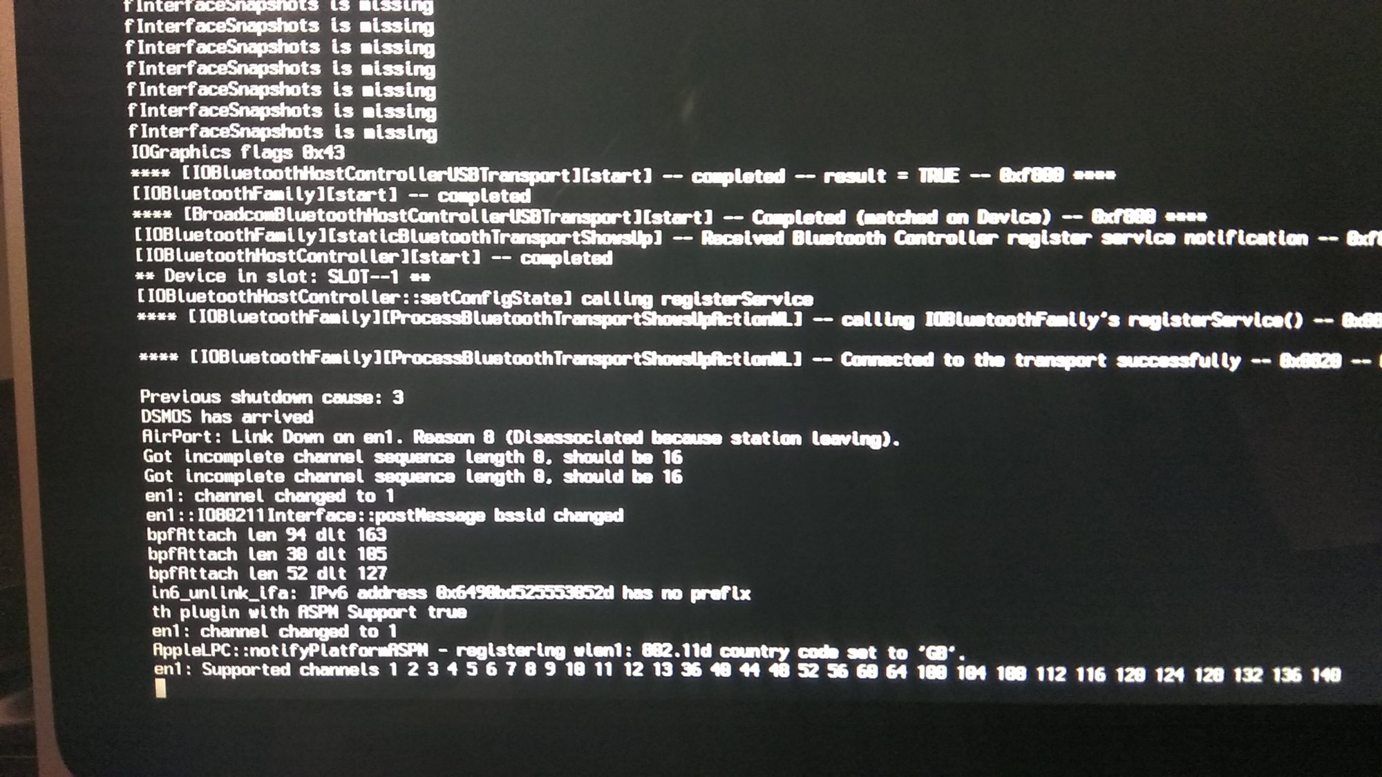

Will definitely try in Cmd-V mode
This is my third time installing El Capitan before I came on here for help.
How do I capture the cmd-v scrolling texts? Does the command automatically saved the file somewhere? It happened too quickly to catch the messages.
This is what I got...
Code:
BootCacheControl: Unable to open /var/db/BootCaches/PreheatedUser/Marged.playlist
Warning: couldn't block sleep during cache update Warning: proceeding w/o DiskArb
bash: /etc/rc.server: No such file or directory bash: /etc/rc.installer_cleanup: No such file or directory
fInterfaceSnapshots is missing (has this message 10 times)
