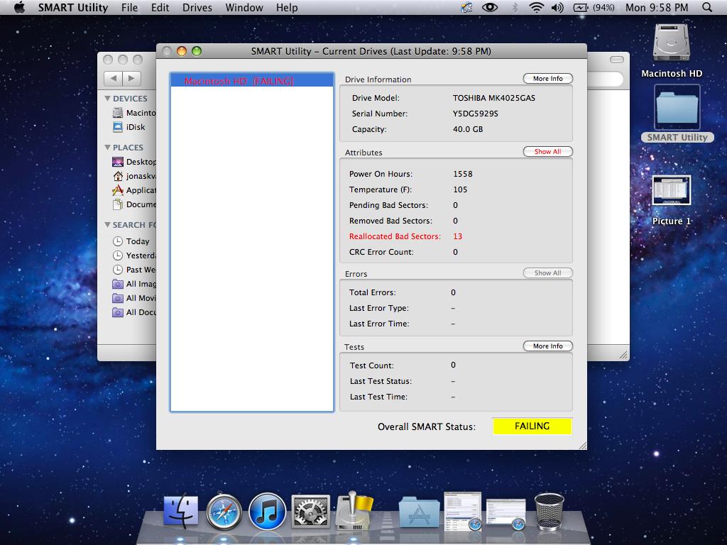

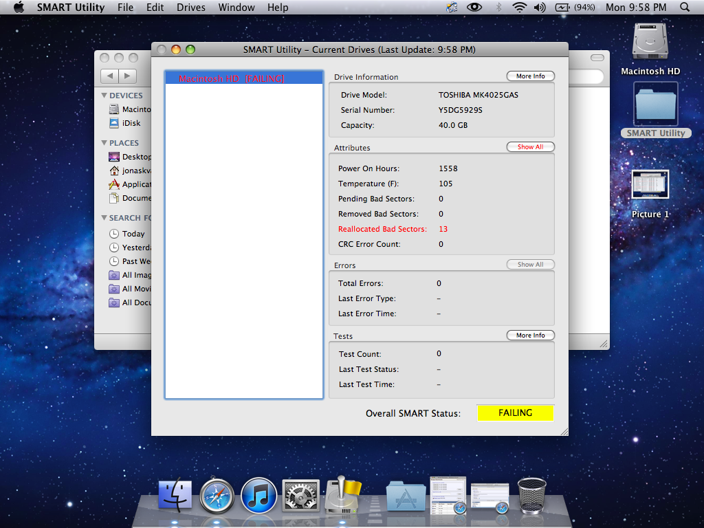

I have scanned my HDD with SMART Utility, and it shows that my drive is failing I think: the reading is below in pictures. What should I do about this? Should I just swap HDDs? I just got this a couple months ago, so this is kinda frustrating, but I figured it would happen sooner or later.
Get a consensus. Use Disk Utility to double check. You may also want to try SMARTReporter.
If more than one source says the drive it failing, back it up, get a new drive and then replace the drive. Clone the backup back to the new drive.
