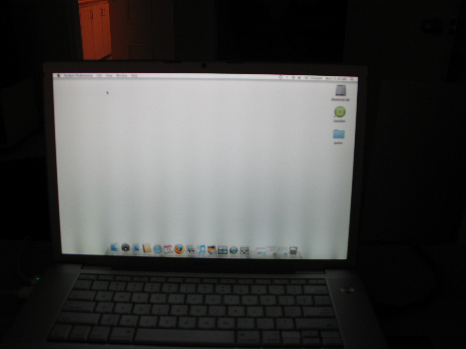

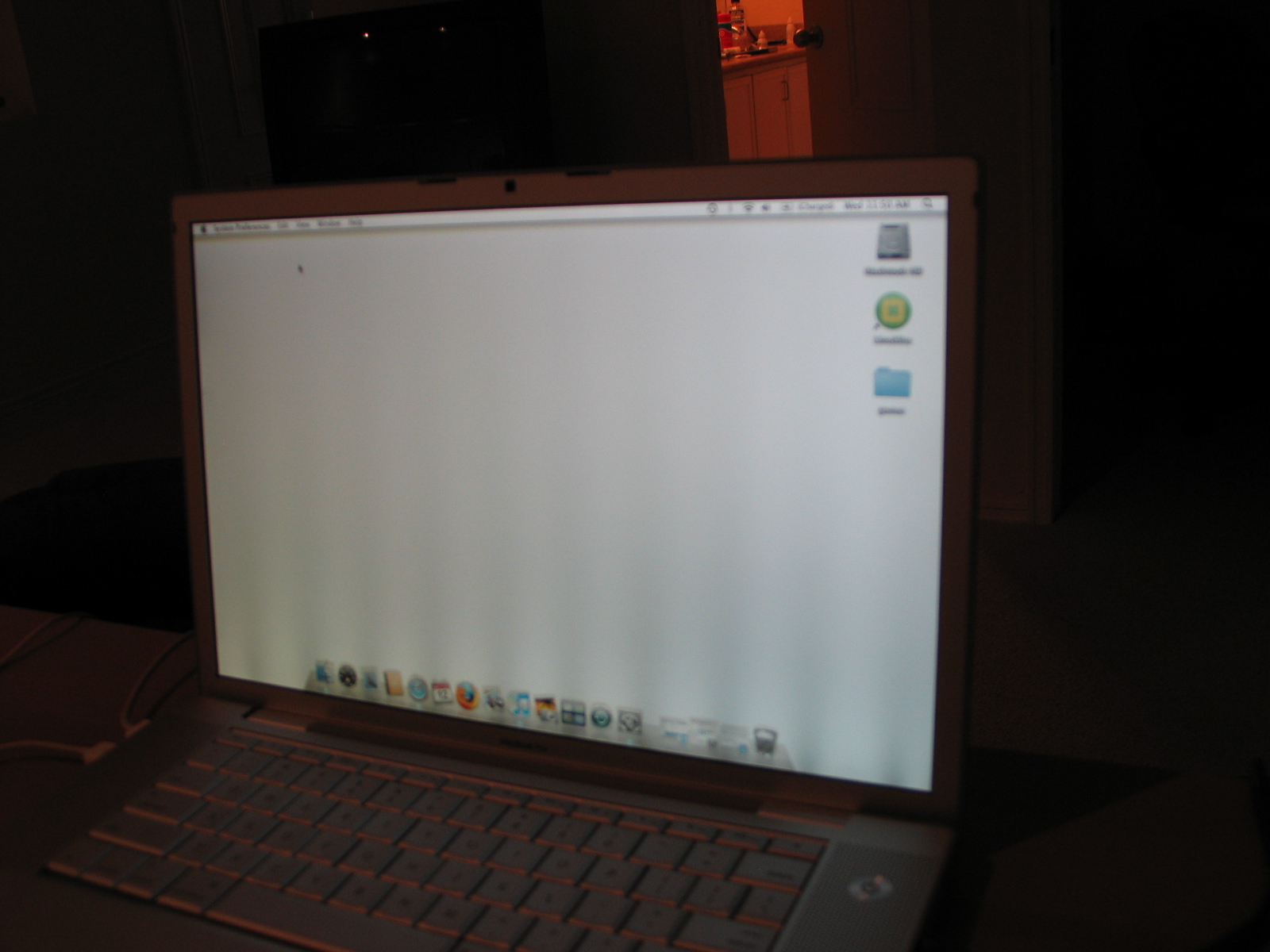

Sometimes my MBP gets these faint black lines that seem to start at the bottom on the screen and fade away as the near the top of the screen. I took a picture. Anyone know what causes these?

Actually, what you have is backlight bleed, not black streaks (you have too much light on the ligher areas). Your screen needs to be replaced. If you are still under Warranty or AppleCare, get thee to an Apple Store, Apple Authorized Repair Center, or call AppleCare to get that taken care of.

That makes sense. It doesn't do it all the time though. Sometimes it goes away by itself after sleep. For instance, the lines are gone right now. Should I still take my screen to the Apple Store to get it replaced? And will they even replace it if the lines aren't always there. I'm not sure I could even show them the problem, b/c I don't know how to make the lines show up.
There is some sort of short in the light. It may come back when you screw with the screen. Definately take it to the Apple Store, they will take care of it.

Just show them the pictures if it does't happen at the store

With the dock on and a wallpaper present, it's impossible to tell. With the dock hidden and the wallpaper turned to white, I can faintly make out slight yellowing and slight black lines like the OP noted. I tried bringing up a Google screen like shkip and again, I can maybe faintly make out black streaks. Certainly not as bad as shkip's problem. The question is, does it worsen? Should I run and get this fixed?
